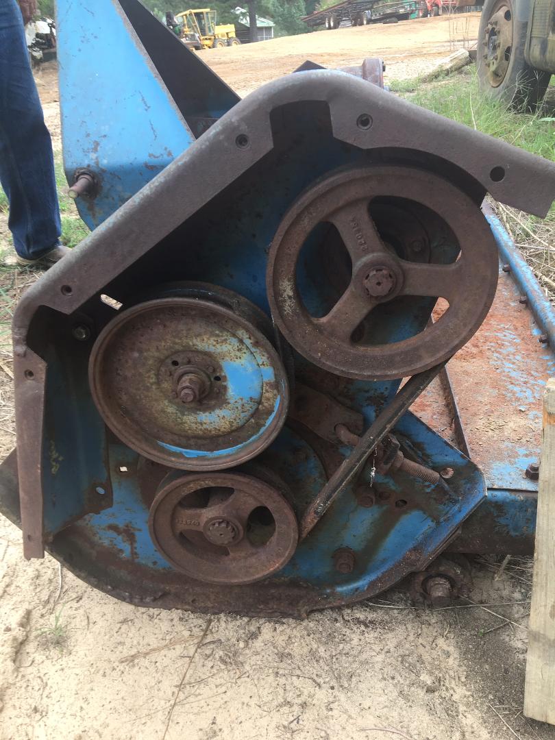

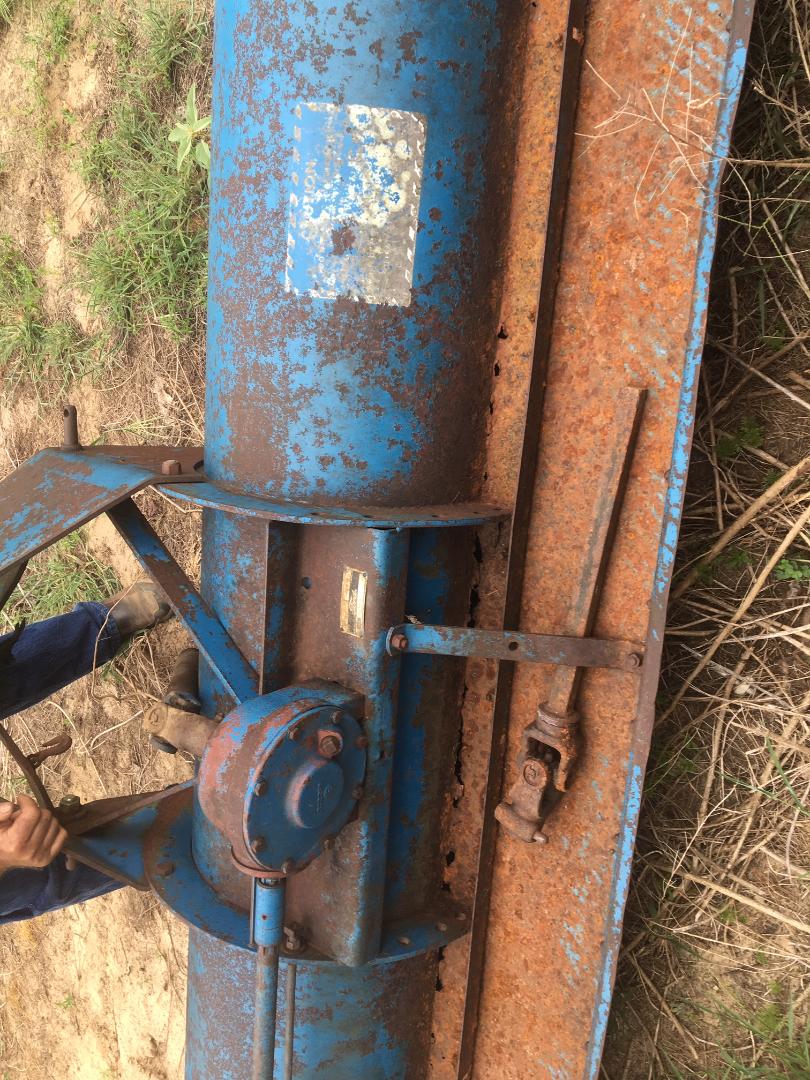

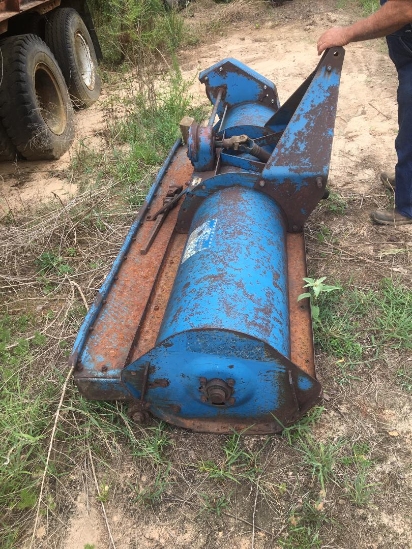

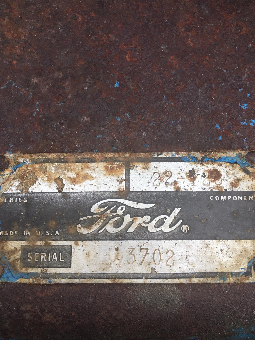

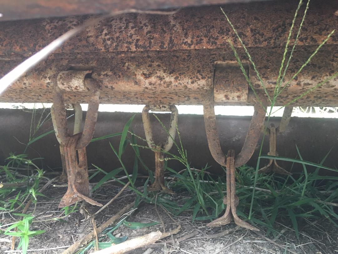

My father in law has an old ford 22-125 7 flail mower, we yanked it out of the weeds this weekend and I知 going to borrow it and try it out for mowing food plots down before disking them down.
We cleaned it off and everything appears to spin freely it痴 missing 6 or so hammers right now. Other than filling if full of grease and seeing how it runs is there anything I should do first?
Here are a couple pictures

About your flail mower; you need a new V belt and you need several scoop knives and for now buying a few replacement scoop knives/spares from the local ford dealer is the quickest way to get you in the field. Your ford dealer should be able to make a copy of the manual for you if they have it in their existing parts book libraries.
You also need to make sure that you measure the PTO shaft properly for the tractor you are going to use as you do not want to damage the gearbox on the flail mower or the PTO stub shaft, bearing and flange on the tractor if it is measured incorrectly as you can cause a lot of damage to the PTO drive on the tractor and the gearbox on the flail mower.
remember that when the flail mower is raised to its highest point the PTO shaft is fully compressed and creates the greatest force against the PTO drive train and it must be short enough to allow the male end of the PTO shaft to fully retract and not have any chance of deflecting and bending the PTO Shaft and possibly damaging the PTO drive system on the tractor or damaging the right angle gear box of the flailmower.
Investing in a gates V belt tension gauge from amazon or a gates stocking distributor is the fastest and best way to correctly tension the V belt.

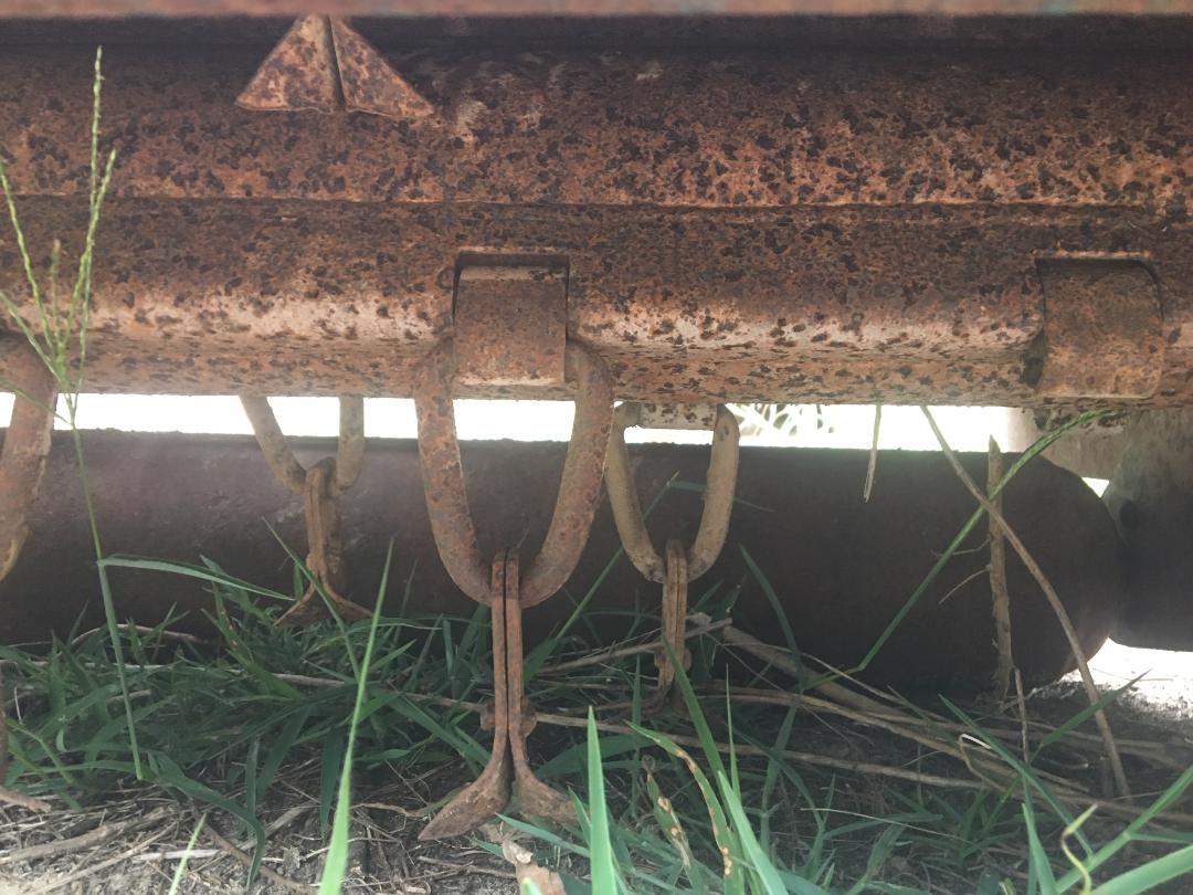

It appears that your knife hangers are held in place by a steel rod that is removed to replace the broken or missing scoop knives. The steel rods should be held in place with cotter keys much like the Vrisimo flail mowers.
After the cotter pins are removed the rod slides out and the knife hangers and scoop knives drop out and you replace t hem one at a time as you slide the rod back into place.
Move the flail mower to an open area and lay an inexpensive plastic drop cloth on the ground and place hardwood blocks under the flail mower before you lower it on the blocks and then you have plenty of room to work.

1. New V belt; the least expensive place would be a NAPA, Car Quest, Autozone, Menards, Farm and Fleet or Tractor Supply store.
They will have a V belt measuring ruler to check it to make sure they sell you the right one.

You also need to be sure to pump enough grease in the PTO shaft tube to allow it to push out the open end of the female half of the PTO shaft. The universal joints/crosses/spiders should not require any more than 3 pumps per universal joint.
D. To correctly level the flail mower place a small torpedo bubble level on the gear box and use the top link to adjust the flail mower to level
it and then you will be able to mow.
1. if the mule you are using has a three point hitch that sinks you need to lock it in place if your mule has a locking knob.
2. please understand that the flail mower cutting height is very important as the closer the knives are to the ground the flail mower will be better able to mow and lift the clippings up and over the flail mower rotor as you mow.
This is referred to as the pressure gradient/suction pressure/water gauge(HG)/ pressure being negative allowing the air flow to lift the clippings up and over the flail mower rotor.
You know its working well when it sounds like a household vacuum cleaner.

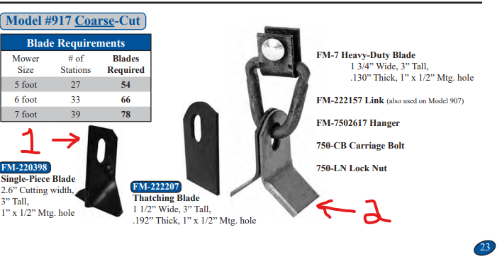

Thanks for the help Leon, It looks like it takes a C-53 belt and I've got one at work and also have the tension gauge so that's not an issue. Are the cold shuts that hold the blades reusable or should they be changed with the blades. When i know that everything works correctly I would like to have all new blades to start with. also when searching for the knives pricing seems to be all over the board, is there a quality difference between the blades or just price? Thanks again for the help.

As for the cost of the scoop knives on your flail mower metal thickness and whether they are heat treated is the major concern.
The scoop knife hangers loops (V hangers) are reuseable as they are held in place by the metal strap loops that are held by the metal rods on each row.
I would just purchase the number needed for the repair and then a few extra spares from the Ford dealer for now and do your mowing and then decide if you really want to change them. These scoop knives are not all that expensive to replace in the scheme of things but you can also clean the cutting edge a little using a narrow whet stone dipped in water while it is on the knife hanger if they are really bad.
If all your doing is the food plots I would not worry to much about the scoop knives simply because the time to change them is when they
have been really dinged by rocks or you ride up on an asphalt drive way ledge while the mower is running.
You can always invest in a wet well grinder from micromark and a grinder angle tool from wood craft and sharpen them during the winter and then the mower will be ready to mow in the summer.

Change the belts. Grease up all the bearings including PTO bearings & splines to make sure they are in good shape. Check, maybe change the gearbox lube. Make sure none of the flails are in really bad shape & you should be good to go.
