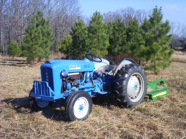

My 1963 2000.

   / FORD 2000 INFORMATION #10

That said.. If I was looking for a parade or show piece.. an SOS would be fine... If I was looking for a mowing/tilling/disc/plow tractor.. I'd look for a gear unit /forums/images/graemlins/smirk.gif
For the original poster, Another bit of info I came across while going through my literature last night. Looks like the early 4 cyl 2000/4000 models were almost 'rebadged' 6xx/8xx models. Also, some of the 2000 models simply look like de-rated 3000 models, as they use the same block, piston, etc.. but have a lower rated rpm.. etc. ( a derated engine should be pretty tough..IMHO ).
Some unit have plastic grills.. etc.
Soundguy
