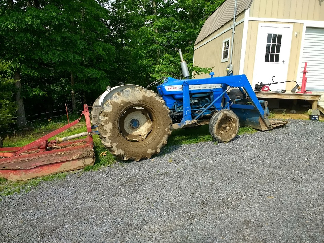

In my area you can still find good condition Ford 2000 and 3000 (a lot of those) tractors. Gas versions usually run in the $3,000 to $4,500 range. Diesels are much more popular and will run $4,000-$7,000 depending on condition and whether it has a loader. They are reliable tractors. The biggest area outside of engine condition to look at is the steering system, especially if it has been used with a loader on it. Replacement manual steering boxes are relatively affordable. If it has power steering a rebuild of the box can run a couple thousand dollars, so be sure to check for play from side to side on the steering arms. Drive it over uneven ground, crossing humps at angles so the steering sees uneven loads and watch the steering arms on both sides to make sure they move together. With a sloppy box the wheels tend to go off on their own directions and it will also want to jack the steering wheel shaft up as it goes over obstacles. They are well built tractors though. Mine is a 1968 that had 4700+ hours on it when the hour meter gave it up (tachometer failures are standard issue with these). It is a loader tractor, so it has the steering problems, but is still a solid workhorse. I'll also suggest you pay close attention to the tires. These Fords don't like thin tread. Find something that has good rubber remaining or buy one at a price that allows you to spend the $1200 on new rubber.
