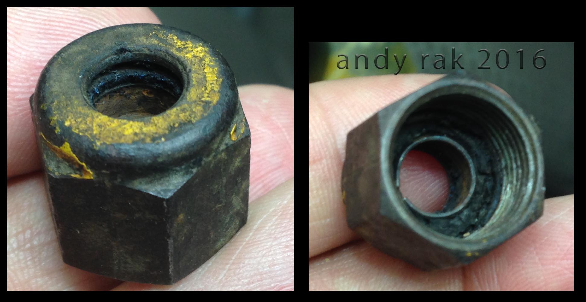

Attached are pictures of my fuel line nut (ford 3400) I'm also trying to replace the line from the fuel filter to the carburetor and can't find the proper nut.
I went to NAPA and the gent came out with a brake line nut but required a wider tube than the original had. Not sure if that's ok to do. It also did not have the o-ring built in as the original nut had, so I'm not sure how much to trust the seal. I'd love to find a source for something like the original one.
The only option i can think of is to find a tiny o-ring to replace the old one. Anyone know if there is a gasket in there too? It looks like there may be one but it may be gunk, working on cleaning it up to find out at the moment.

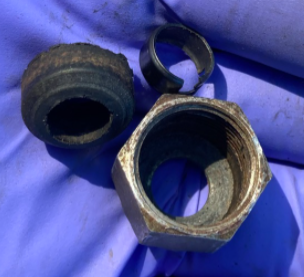

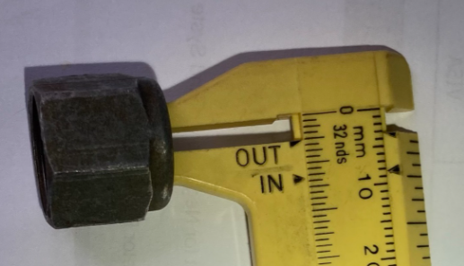

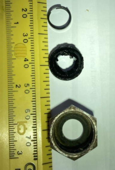

[I realize this is old thread, but it googles well and more folks are working on carbs now a days, so I am just adding to this already excellent thread.]
I have the same issue with the old nut leaking after changing my carb. Surprisingly the link to buy a new one works 5 years later. I am just attaching photos in case someone is not able to source the OEM nut and needs to improvise a solution.
The nut consists of 3 parts and seems based on standard 5/16" tube like fuel or break line, no flare.
This is the expanded views of the nuts pictured above by andyryk, mine are pretty rough and this nut no longer seems to seal or I am not installing it correctly.
I have purchased some actual small grommets, quite different than the original below, but if my reconditioning of the original fails, I will be trying the regular grommets without the original center spring steel part. Wish me luck, any advice welcome and a huge thank you to @DJ54 and the other contributors to this thread.
