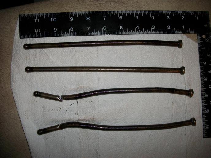

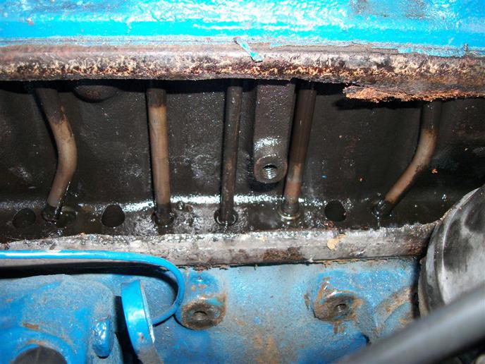

a54127.jpga54391.jpgditto what Jim said.
pull the valve cover and the side cover.. easy to see the valves move up top and the pushrods on the side.
i just rebuilt the top end on my 4 cyl 4000.. a red tiger 172ci version of that red tiger 134ci in your naa.
I had a hand full of bent push rods and stuck valves. i had to use a teadblow hammer and acetone mixed with atf and naptha as a solvent in a spray bottle to soak them ( remove umbrella seals ) and then beat them in and out of the valve guides. it's a non interference engine so no valves will kiss pistons.
I WOULD NOT go right to removing the head. no reason to at this point.
also.. stuck rings should not give you 50-0-0-0 that's a valve issue... ( or broke cam / rocker )
