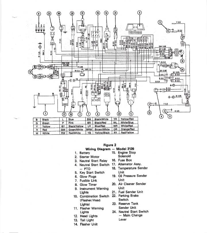

Weird situation here. I’ve had this happen on a 1984 chevy truck, my sons 1998 Volvo, and now my 1996 Ford 1920 diesel tractor. Battery new. Alternator and stater checked and good. New ignition switch and harness, new dash, and new (good used) wiring harness. Turn the key and the fuel shut off valve clicks, as it always has. Gauges come alive (fuel needle begins to rise), have lights, etc. turn the key farther to crank, everything dies. No power. Gauges flat, no click, nothing. Only way to get it back is to disconnect ground at battery. Then I get power like before, but same thing happens. Ground strap is good and I cleaned all ground connections. Haven’t solved the problem with the chevy, but with the Volvo it would do the same thing, but then although the battery was showing 12.5 volts, it still wouldn’t start. As soon as you try, everything dies. No dim interior lights, etc. Decided to hook up a battery charger and as soon as I hit on, lights came back, then it started. Didn’t work for the tractor. I’ve asked countless auto people including a local auto electrician guy I used for everything. No clue. Please help. I’m desperate to get this tractor going. Any thoughts greatly appreciated. Thanks, J

Looking at diagram it has a neutral safety switch and relay. I'd check that making sure ignition switch is wired properly (crank position). Something isn't allowing starter solenoid getting power. You could jumper power to solenoid temporarily to be sure it cranks or check voltage there (switch in crank position) working backwards. Number 7 on diagram shows a fuseable link off of starter.
The neutral safety switch is new (good used).
