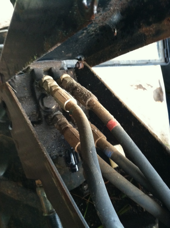

Went back and looked at the loader, its aushhog 2440 QT,, loader shoud not matter, it has a Cross 1z0202 double control handle control valve, I have it plumbed to the hydraulic manifold, in the lines, it has one output and 1 input port, the loader works but I cannot get the 3 pt hitch and the loader to work at the same time, I have have turned the screw on the manfold block with no luck, not sure if this is the correct valve for thi trsctor or not, was this way when I purchased it, just wondering if anyone has a 1920 with a loader on it, does it use 2 of the outputs or just one of the outputs off the manifold..
   / Ford 1920 front end loader problemf
How many lines from the hydralic block to the conrol valve(joystick)
   / Ford 1920 front end loader problemf #7

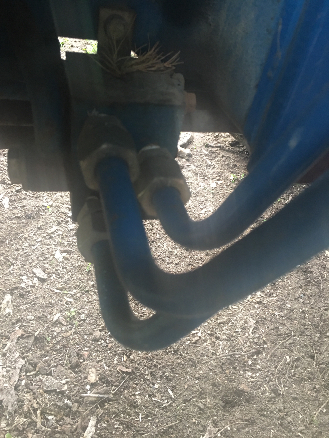

My NH 1920 has a Bush Hog 2245 QT loader with a single joystick. I have not been able to identify the joystick valve but it has "1627-1H COEF" stamped on the valve body. I'll try to attach a couple of pix.IMG_0039.JPGIMG_0042.JPG
   / Ford 1920 front end loader problemf #9
Looking at those pics. It looks like you cannot get on or off the right side of the tractor with that loader. I'm always getting off and on that side.
   / Ford 1920 front end loader problemf #10
The joystick support arm swings outward and inward from the mount point, but not far enough outward to comfortably clear way to mount the tractor from that side. So I always mount/dismount from the left side, where the step and grab handle are. I've gotten used to it and is not a real big deal.
