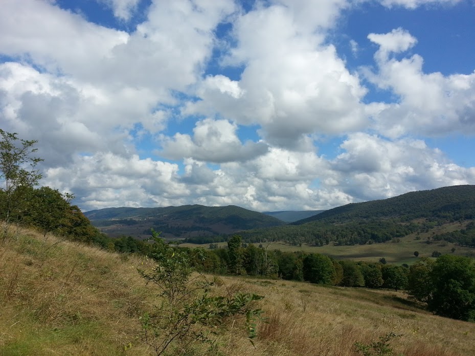

Thanks for all the helpful information! Sounds like the 2wd might be a bad choice even if it were well priced. USDA soil map says the steepest pasture is 35-55% slopes, but I can't imagine it's more than 25% slope for the part we'd mow... we can walk over almost all of it without getting onto all fours. Attaching a picture of the steepest part of the pasture.

Yeah, you need a 4WD.
