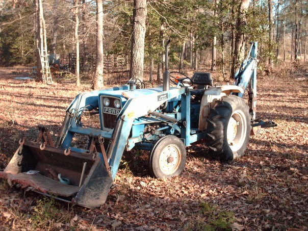

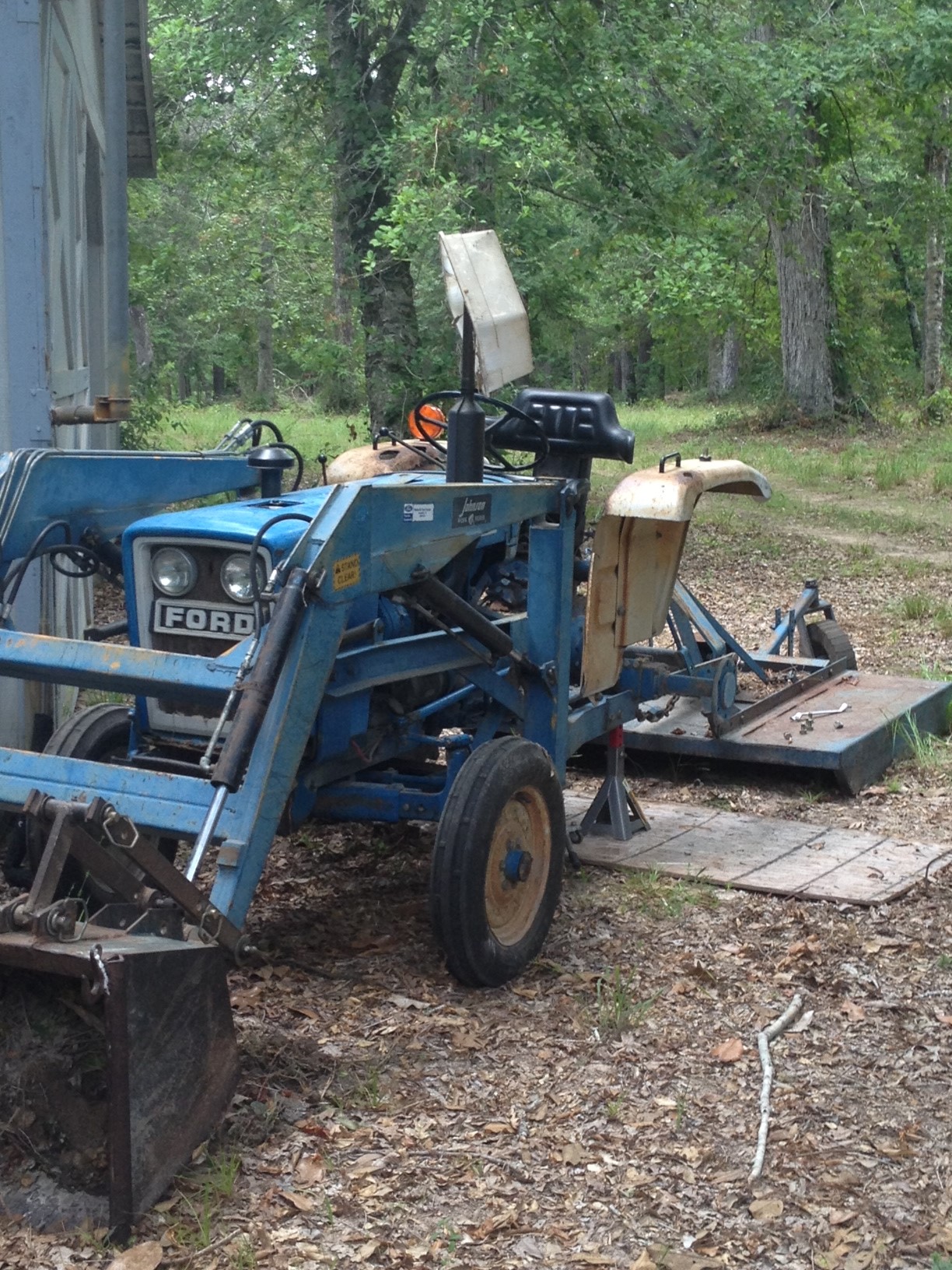

Picture with the backhoe is a few years old. I think the hood still opened shut back then, ha. Right now we just run it without the hood as long as we are not brushhogging or going through the woods.

I doubt you would find new sheet metal. There are several tractor salvage yards online, that might help. I have a 1600, one size under your machine. When I got it, one fender was well rusted where it bolts to the axle. My father and I just cut off the rusted part, and welded on a new patch. It won't win awards, but it looks good at 5ft away. Battery hold down kits can be found at most auto part stores. Your loader should be a 770, or 770A, or 770B. The linkage hooked to the bucket in your photos looks unusual. And finally, if you aim to mow, but leave the loader on, keep the R-1s. If you removed the loader for good, the R-3s work incredible.

Click on post #2 and you will see the pics. Look at the bottom pic it is most recent (like yesterday) and look at the bottom of the grill shell and can see it is gone from rust. Tops of the fenders are gone too. It is much worse in real life, just better to scrap than try to fix, it is rusty all in the joints of the sheetmetal too.
