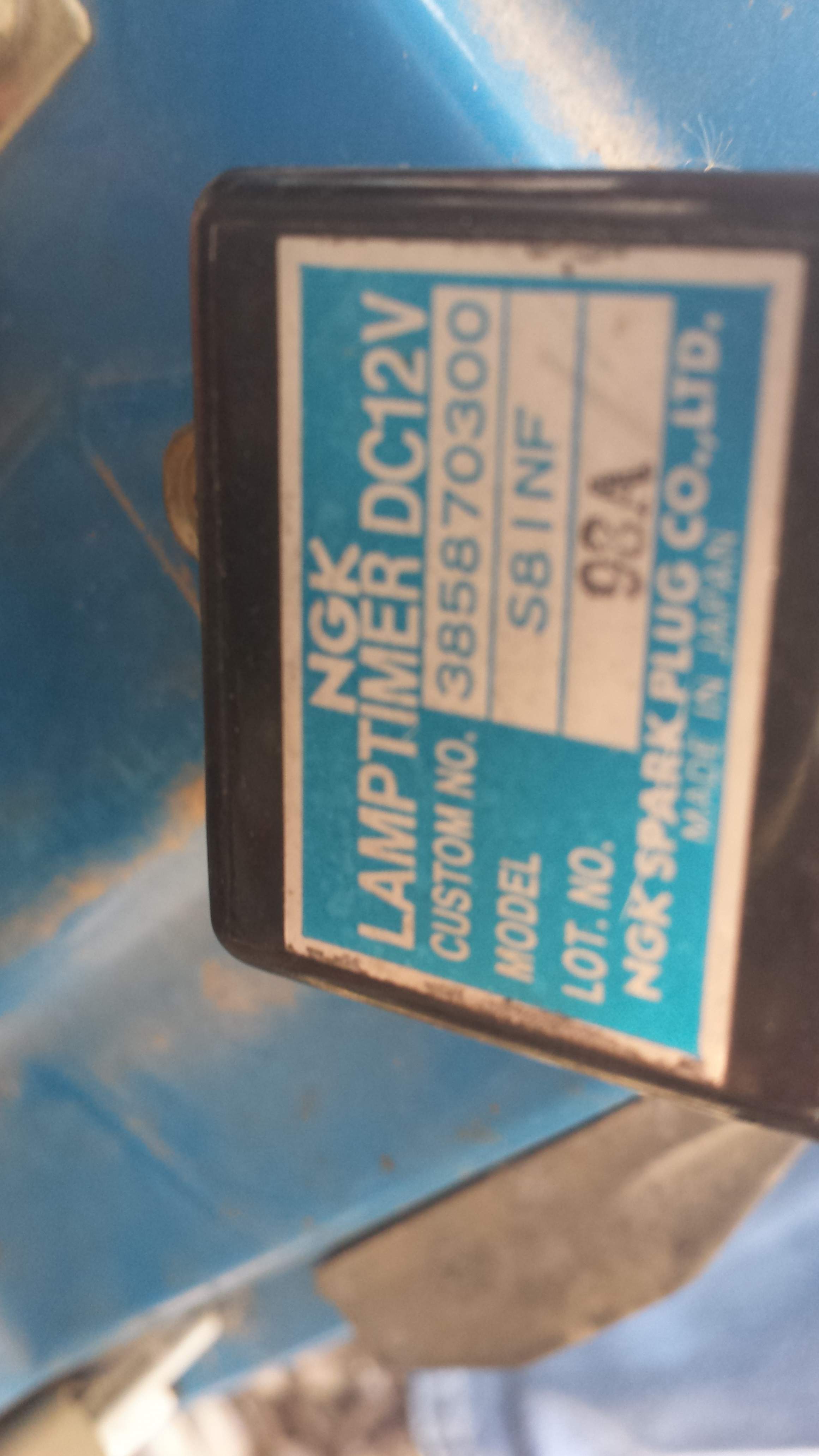

Thanks for all the feedback. I've finally gotten back to diagnosing the problem. I've discovered no power is getting to the power bus feeding the glow plugs. But when it finally does start (now its warmer and it will start some of the time), there's a 1-3 sec pulse of power on the bus but nothing when I turn the key counter clockwise to activate the glow plugs. I believe its the relay but I have no idea which relay or where it is. Any pointers would be appreciated. Here's a pic of a part that could be the relay but I don't know if this is it or not. 2014-03-02 12.08.05.jpg

Hi glbrooks my 1710 ford works this way, power taken from the key switch to the glow plug indicator then to the glow plugs bus bar, check to see if power on the switch is there all the time when you turn the key counterclockwise, if so check metal strip at glow plug indicator simple continuity check, check glow plugs connect one ohmmeter lead to the glow plug, touch the remaining ohmmeter lead to a clean ground and observe the ohmmeter reading, one-ohm reading = good glow plug, high or low reading = faulty glow plug- replace

Thanks for all the feedback and advice. To get to the instrument panel to check for power I found that mice had a nest there (probably for years) and had chewed through 4 wires. This was near a cable connector behind the instrument panel. I spliced all of them for a quick test and all seems to work and start ok. I can see lights on the panel that I haven't seen in years. The glow plug indicator (heat light) will light momentarily when I start it normally (all starts fine now that its warm) but I still don't see power on the glow plug bar when I turn the key counterclockwise and the glow plug indicator light (heat light) doesn't light up either. There still may be a issue but not sure?

Hi there check continuity at glow plug indicator, no continuity check switch, key switch to indicator check, connect one ohmmeter lead to the key switch terminal marked 19, connect the other ohmmeter lead to the glow plug indicator and observe the ohmmeter reading, low to zero reading good continuity high reading faulty wire replace, connect one ohmmeter lead to the key switch terminal marked 17, connect other ohmmeter lead to glow plug terminal and observe the ohmmeter reading, low to zero good continuity, high reading faulty wire replace hope this helps
