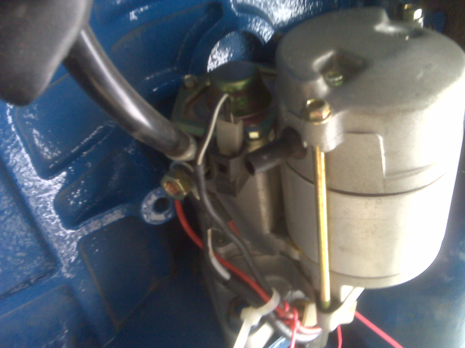

I received a Ford 1715 and all the wires to the starter are disconnected and hanging. Can someone provide a close up pic of the starter with all of the cables connected? IE Battery, alt, key switch, etc... Thanks in advance.

Try looking at the diagrams on Messicks or Part Spring.
They are great online resources.

OK, attached is a flat out horrible picture!!!! So..... I'll try to explain. There is a lug and a spade. The lug is about 3/8" threaded for nut and about 3/4 inch long. This is where the battery connects along with any other wires that need a "battery feed". The small spade is the feed from ignition to the solenoid. It is a two stage solenoid, but all of that is internal to the starter.
Hopefully this helps!!!
Audo
