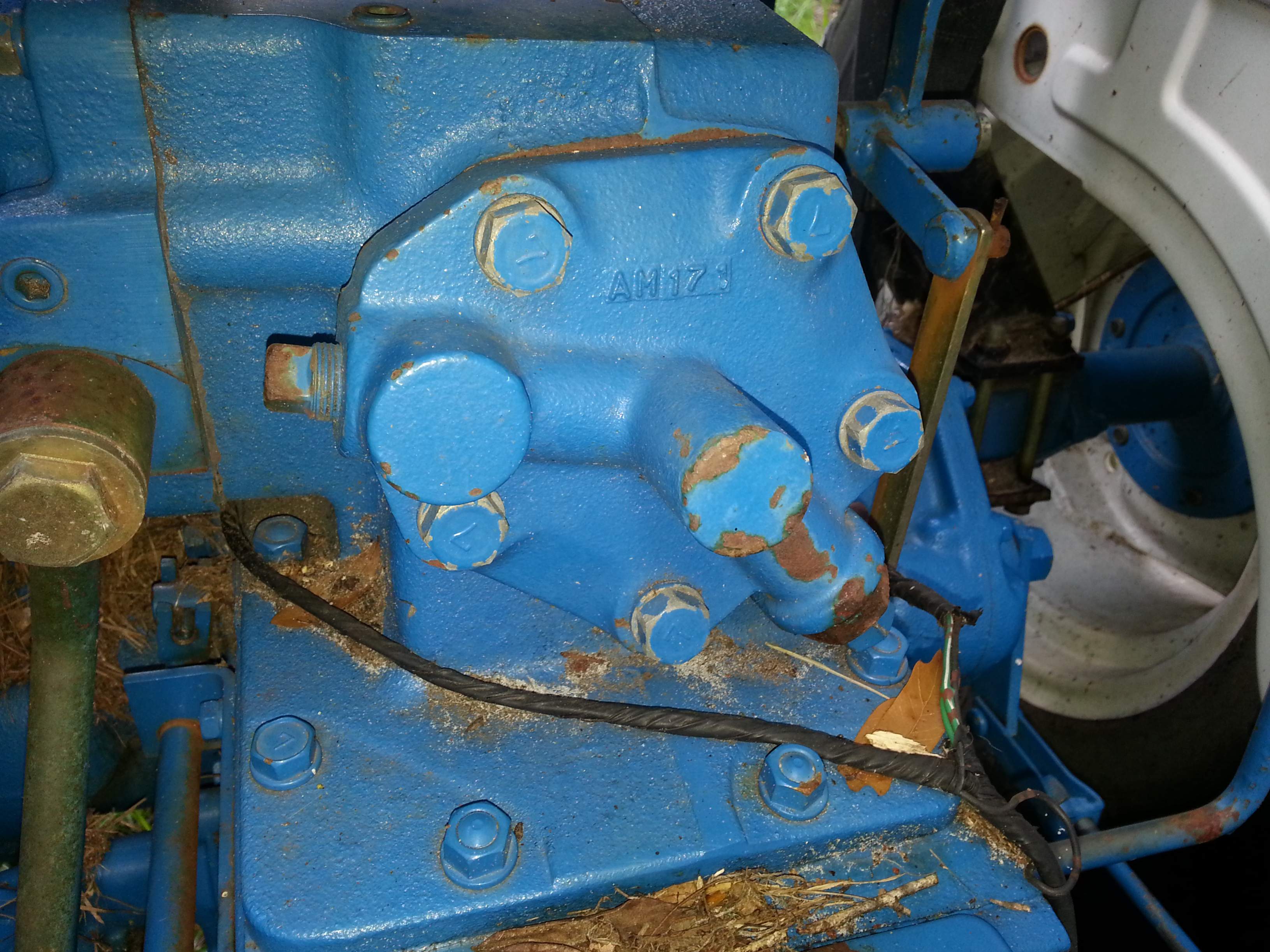

   / FORD 1715 HYD PROBLEM
HERE IS A PIC. NOT ON THIS TRACTOR, MAYBE ONLY 1320,1520,1620
   / FORD 1715 HYD PROBLEM #9
What year do you have? The diagram showed different layouts for some years. Probably you can close the flow off with the draft control lever, but not familiar with the ones with draft. Anyway, that assembly in your picture is how you get to the piston and seal. 6 bolts if memory serves. Take it off and raise the lift arms by hand till you can grab the cylinder and pull it out.
Edit: Typo, you won't grab the cylinder- I meant grab the "piston."
THANKS, I WILL ORDER SOME PARTS AND OPEN IT UP AND SEE WHAT I CAN DO.
