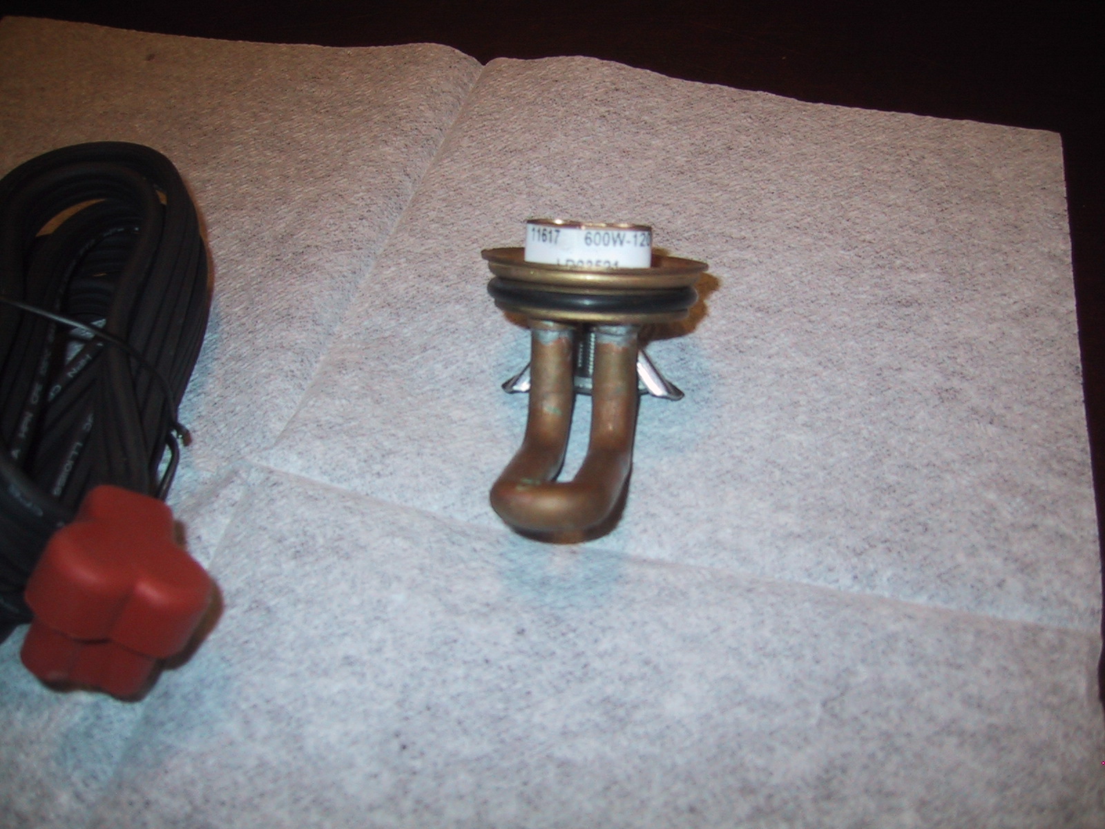

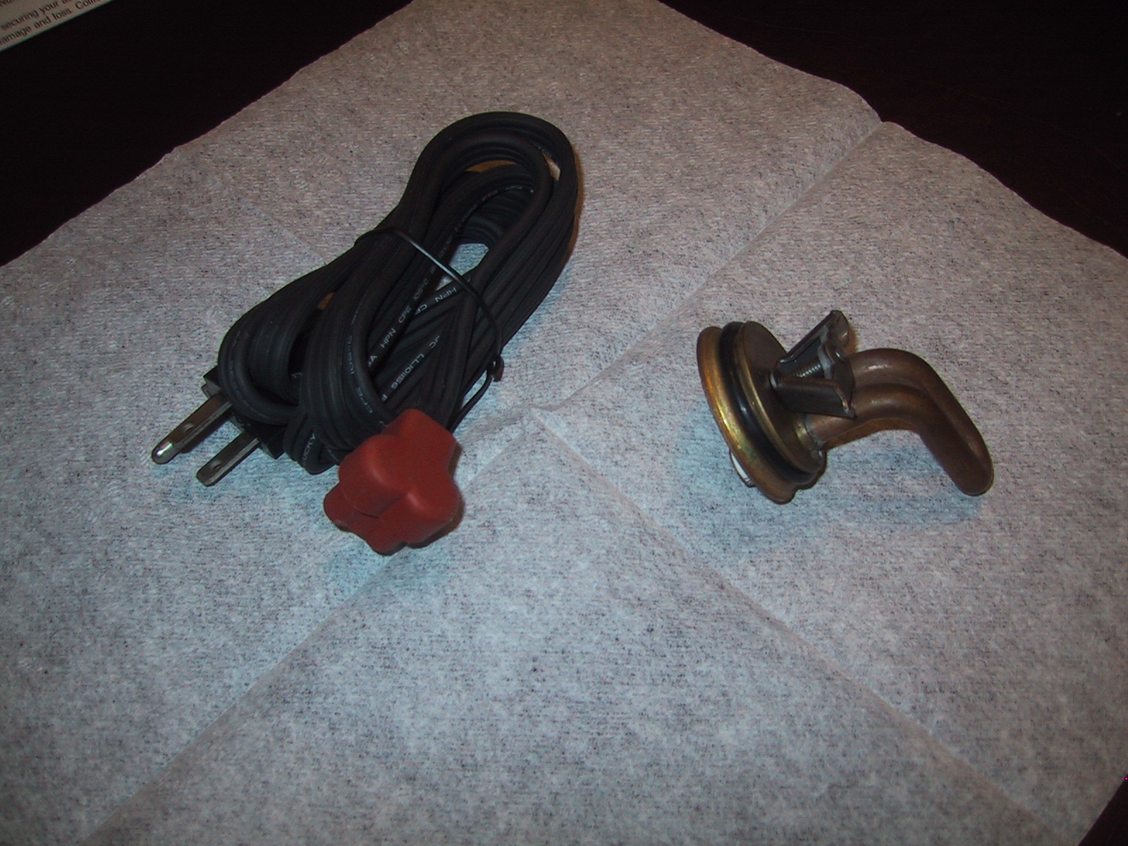

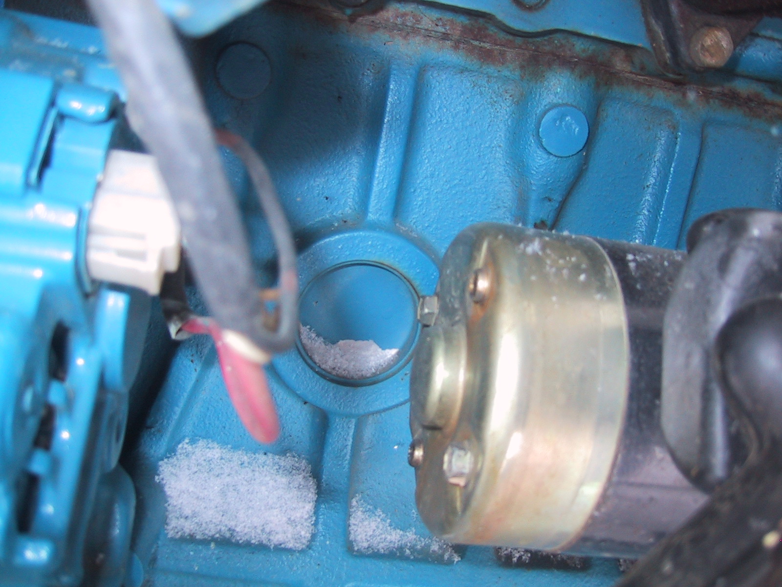

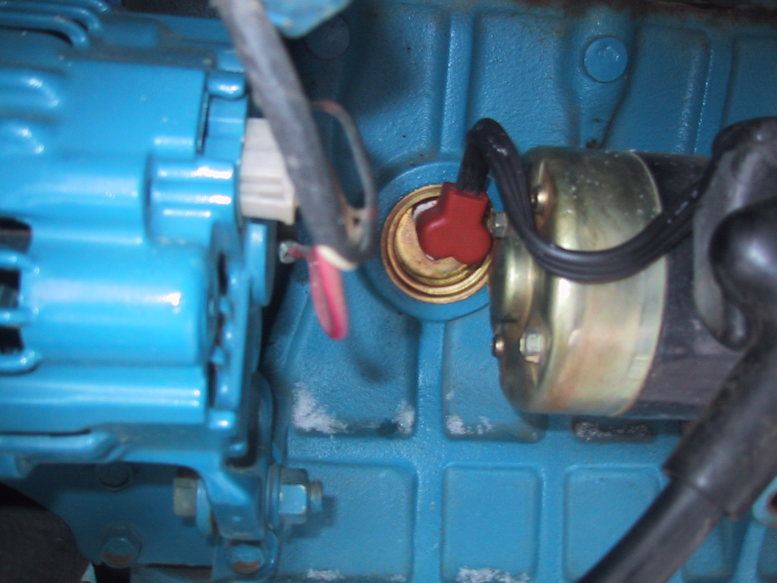

MY 1715 uses a 1 9/16 " Check again to make sure that is 1 5/8". I bought one at NAPA For $27 . it is a 600 watt.
