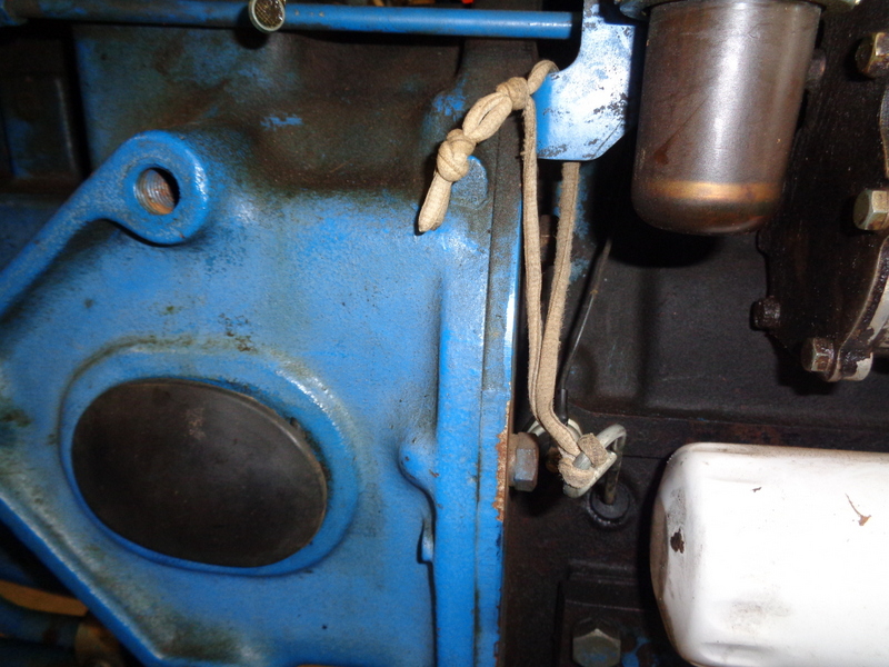

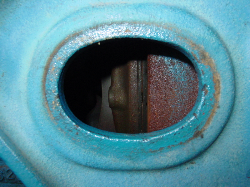

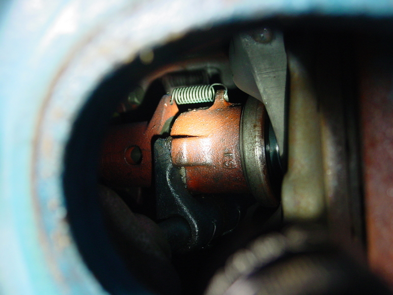

I see a rubber hand hole housing on the picture for 1710. If that is anything close to what I have then you can remove the cover and actually verify type of clutch you have.
