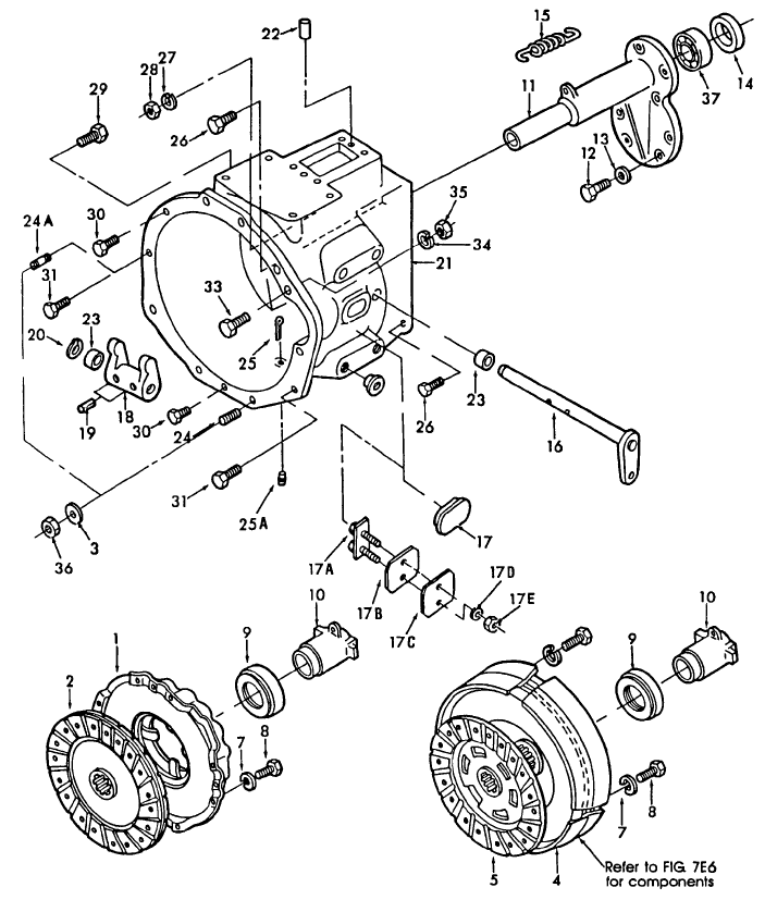

I have a ford 1710 4x4 with power steering that I just recently bought and I have been fixing it up. The final problem that I have been having is that the clutch will not disengage to all the higher gears to be used. I have Shifted the tractor into gear 6 with ease but anything higher causes a grinding noise and will not pop into gear. I have been using brake cleaner. I have also been trying to put stress on the transmission by having the tractor push a tree and pull a tree. I have also tried to separate the clutch using a screw driver. I was thinking about trying a little wd40 to see if that would help but the tractor has a dry clutch. Any advice?

I know that but the issue is the clutch will not disengage so there is a grinding noise that occurs. The clutch is rusted together and looking for ideas how to get them appart.

Oh ok. Thank you for all the advise. I have been told to use brake cleaner on it. I am sure that one of the clutches is free so the lower gears are fine. It is the upper gears that I am having a problem with now.

Is it possible for you to stop the tractor in 1st gear with the clutch depressed without stalling the engine?
Mike
   / Ford 1710 Clutch Rusted
#9
Yes. I can do that for the first six gears. It is the next six that are having trouble.
   / Ford 1710 Clutch Rusted #10
Your clutch disc is not stuck. It appears to be out of adjustment.
There is only one clutch for your transmission the other is for your PTO.
