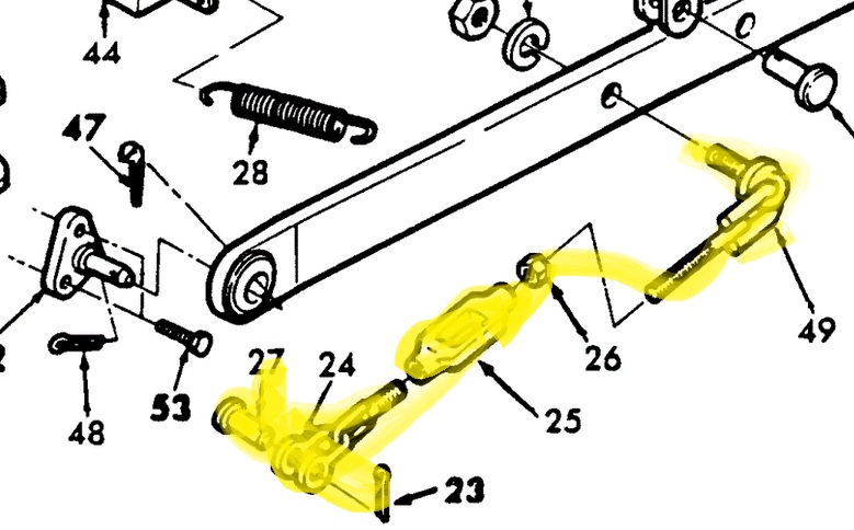

I have the above tractor and need the sway control parts to prevent my 3 point bars from swinging causing the implements to hit the tires. Messicks has the parts but are really expensive. Has anyone bought these elsewhere without breaking the bank? the part highlighted in Yellow is what I need.

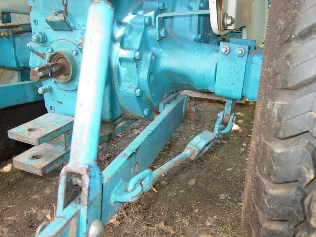

Buy yourself 4 shackles and make a fixed one. I have never adjusted mine but once. You need to have access to a welder and be able to weld also. it should not be very difficult to make one.

I can weld and have a welder so that shouldn't be an issue.....Just need to find the turnbuckle and threaded parts, or rig something up I guess.

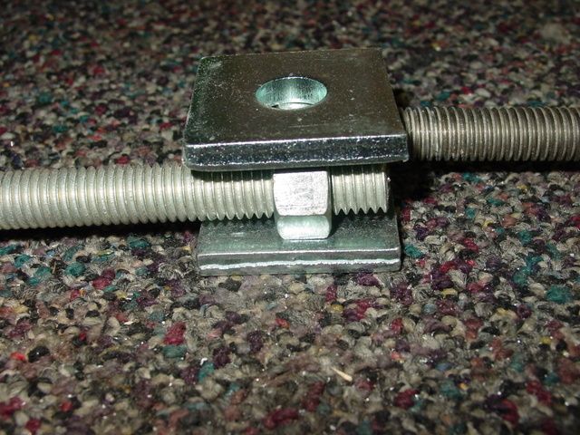

A bit of visualization aid. The all thread that I'm depiction below is 1/2" and not adequate , it is just the idea.
weld two nuts to plate like below. Weld another Plate on top and now you have a totally adjustable sway bar. Need to be inventive on tying the ends to the axle and diffy housing by welding a shackle or whatever you have available.

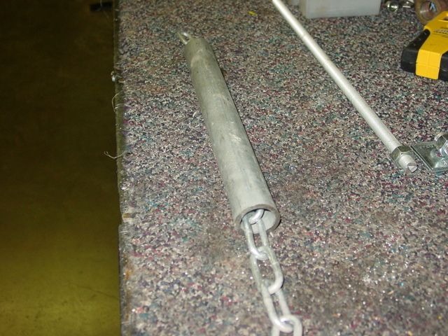

what I even like better is a piece of chain inside a a pipe (can adjust pipe length to what you need). This is a simpler design as you can marry up the chain easier to the two point on either side. This design would afford you both tension and compression.

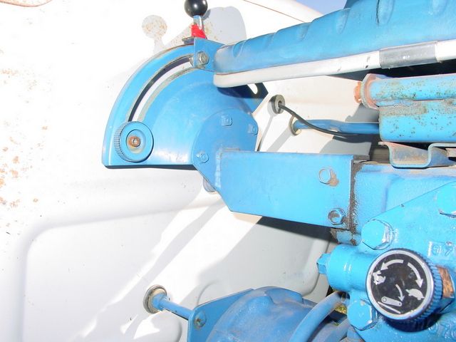

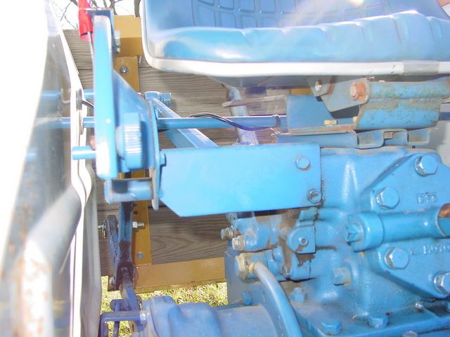

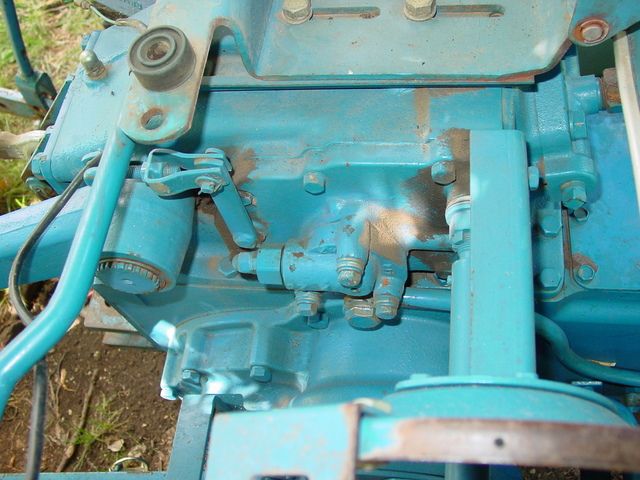

PICS requested on the lift handle mechanism.
JC,
   / Ford 1700/Shibaura SD2200 3 point sway control
Thanks, that would work for sure. Your hitch lever is alot different than mine, I have a straight bar running parrallel to the ground from the control lever to the rear arm. The rod is a linkage rod that is about 6" long. I tried to find a picture of it on messicks but no luck.
