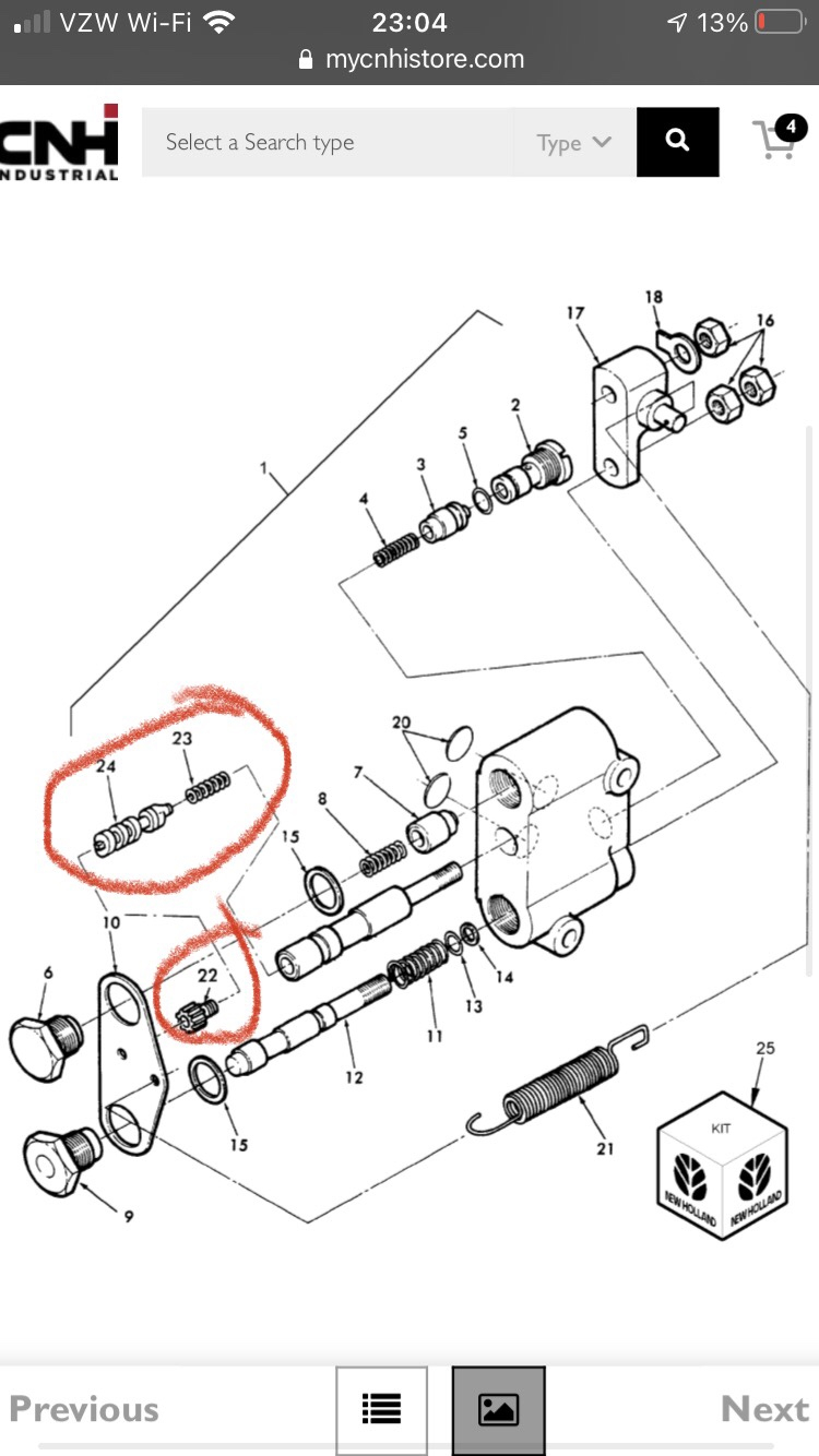

My biggest curiosity was the middle valve/spool assembly. The diagram on CNH shows a metal sleeve/body basically with what’s listed as a bypass spool, spring and plug within. Mine however, has none of those 3 parts. Obviously worked previously without that, there is a plate on the end so no way parts could have gotten lost.
For $100 I found the spool and spring, can’t find the plug. Also doesn’t appear that it’s been disassembled previously or they did a good job so maybe it didn’t have it? If I could find out what this plug really looks like I could see if something would work. I’m assuming that freeing up the frozen valve and getting the right parts would help.
