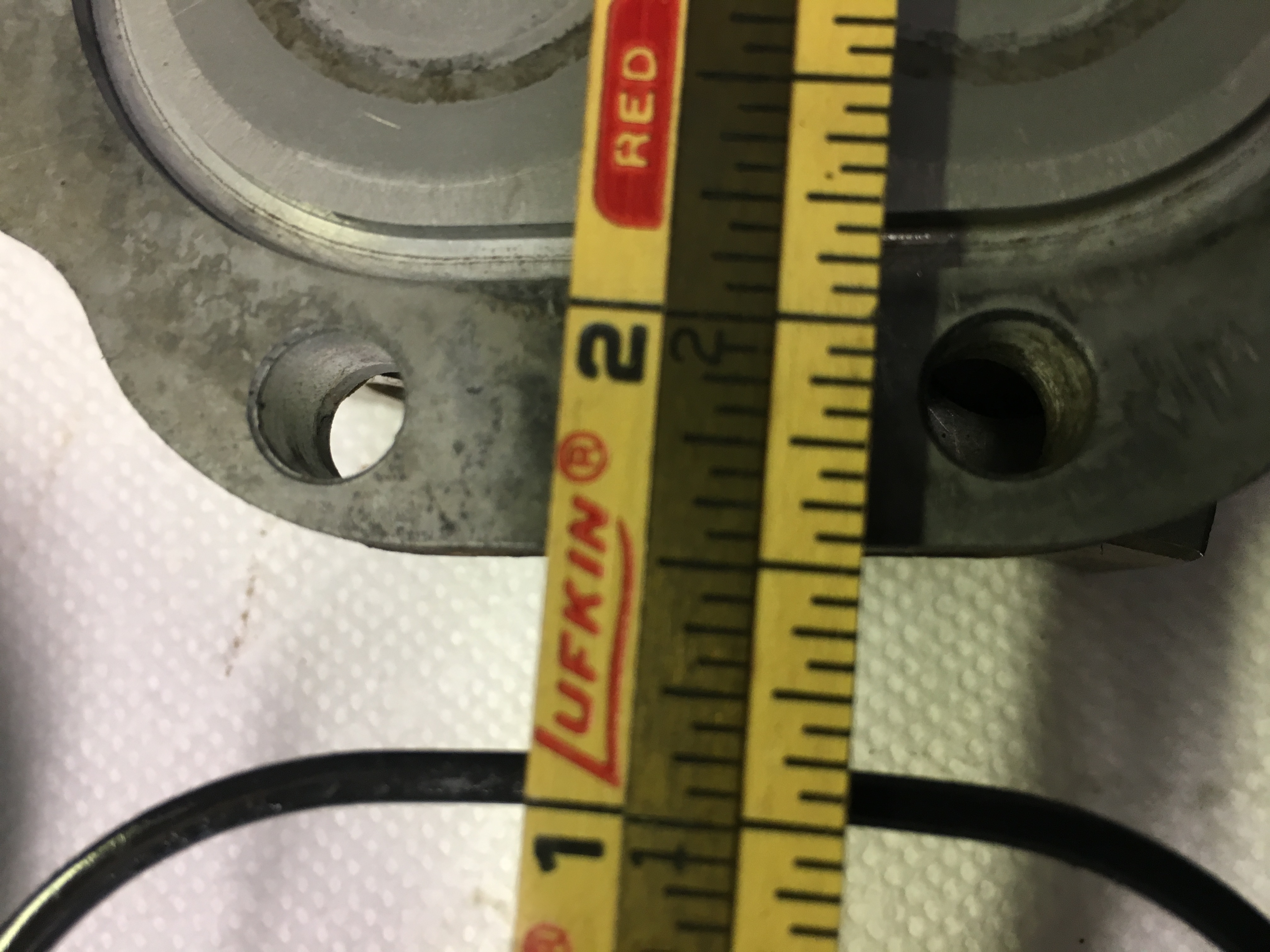

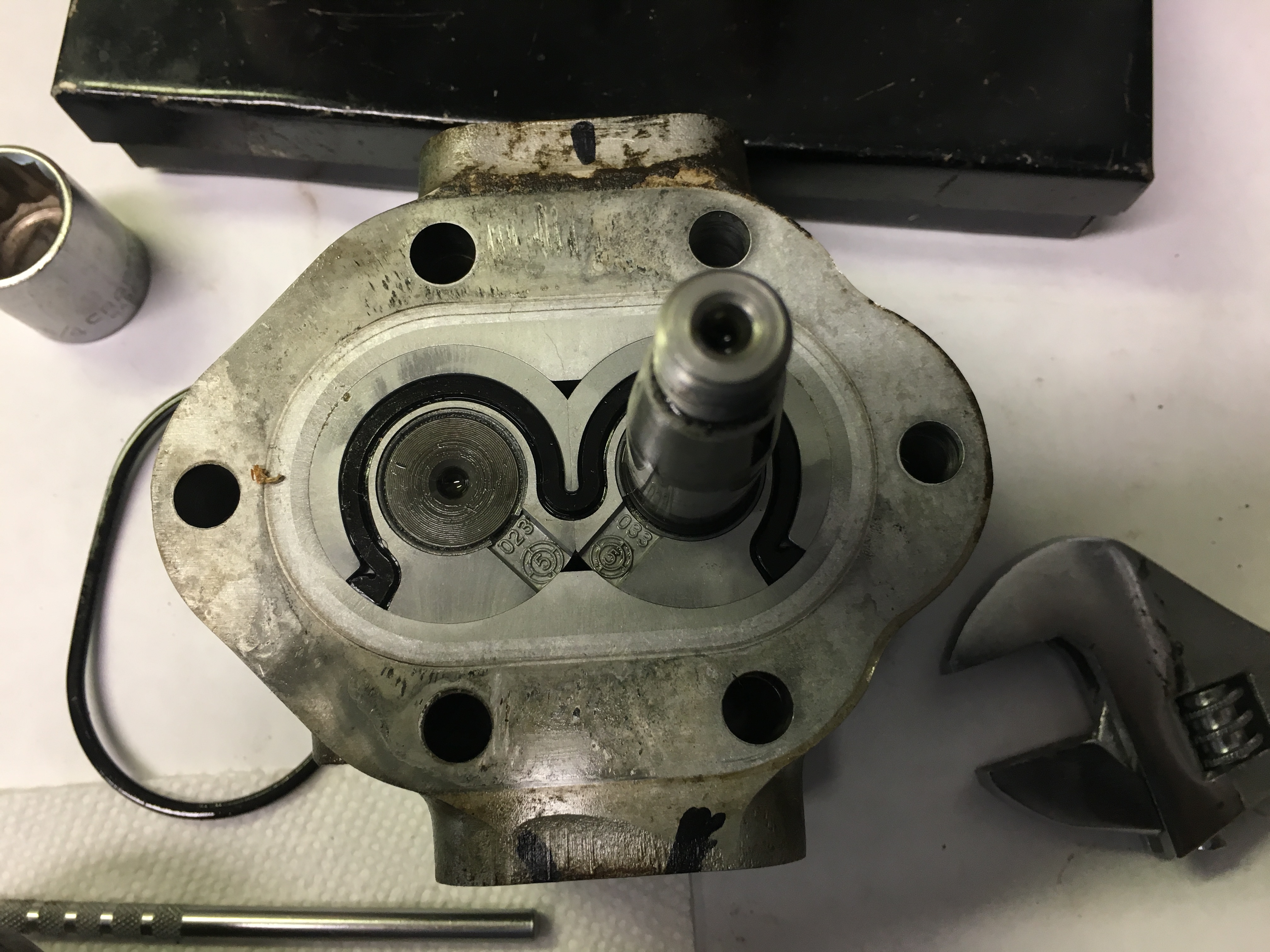

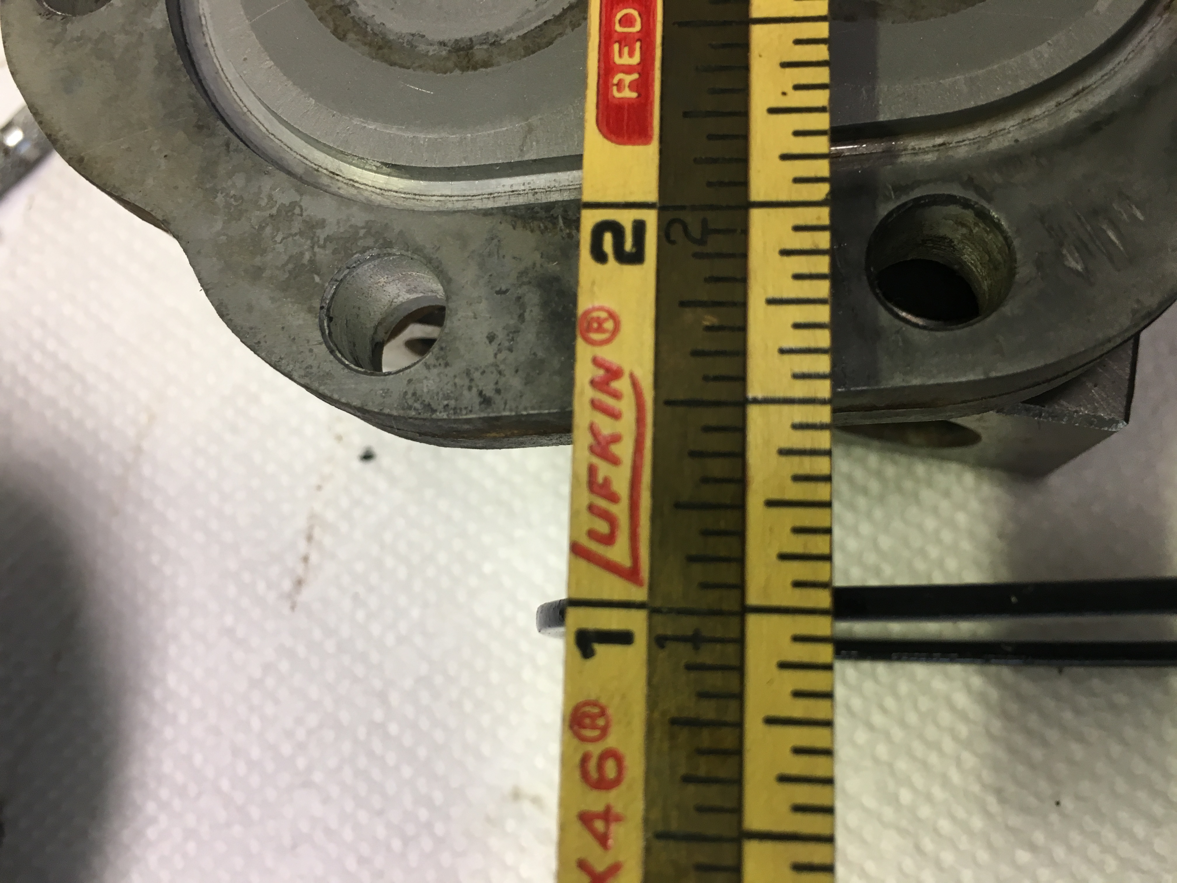

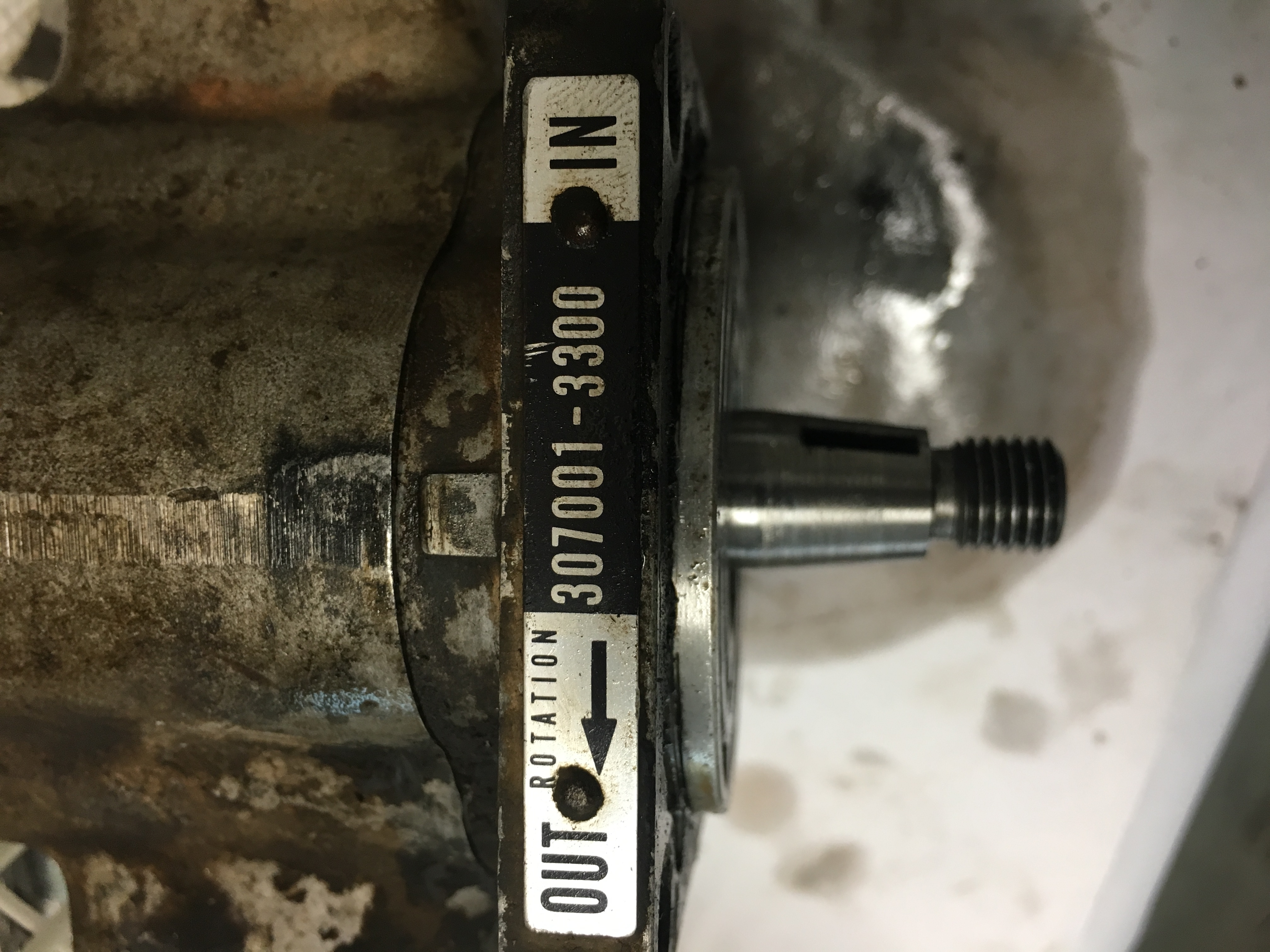

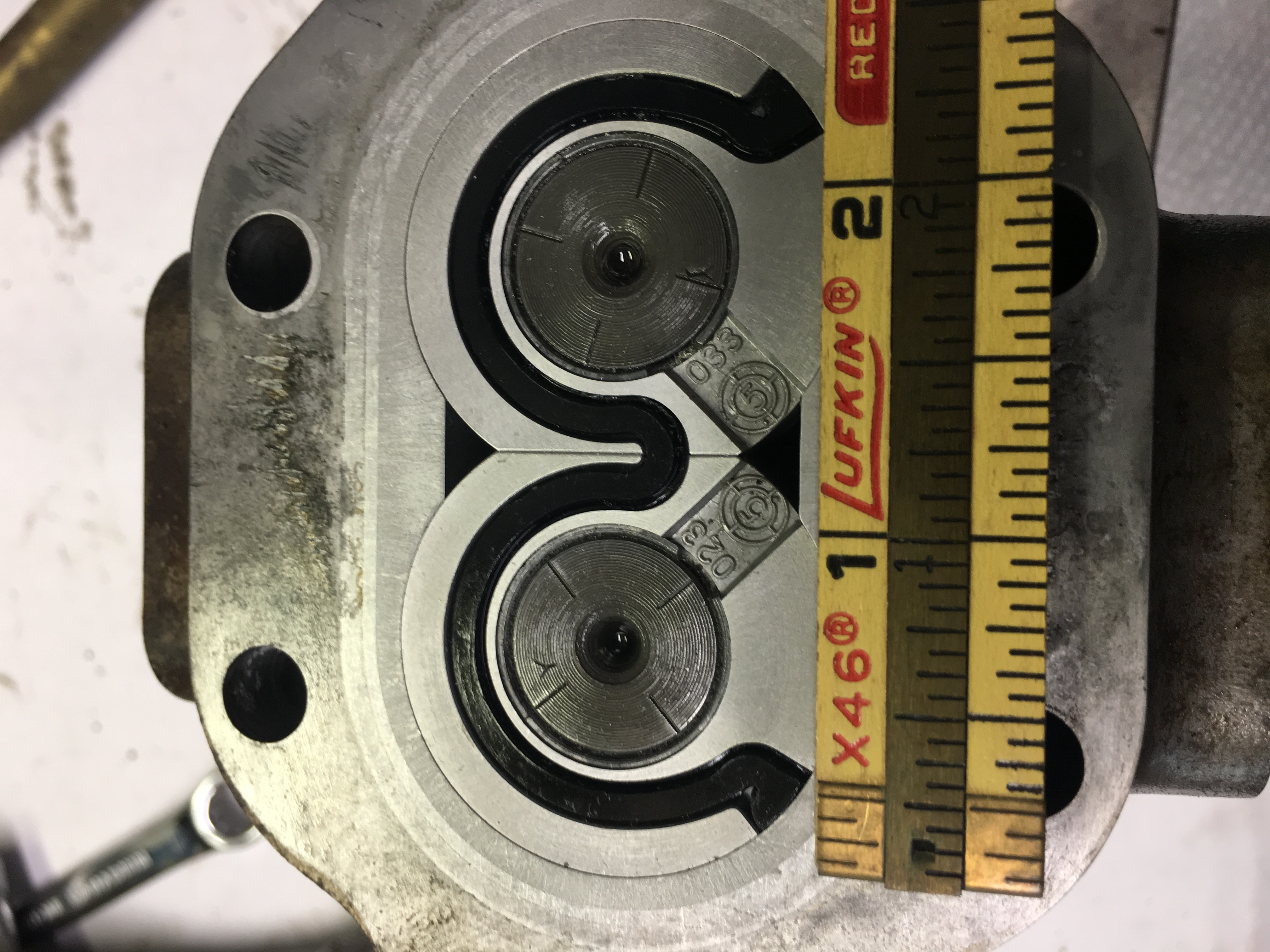

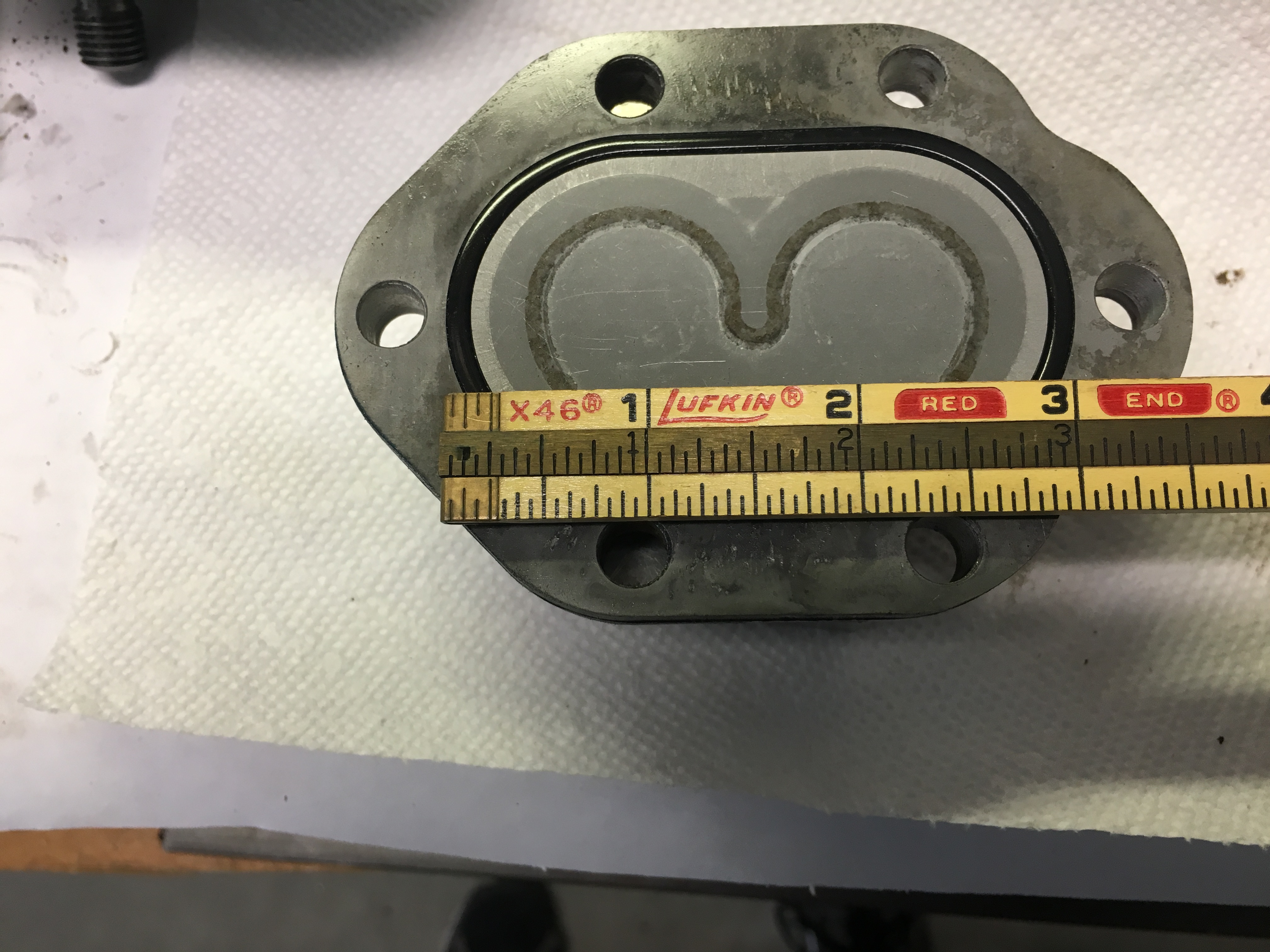

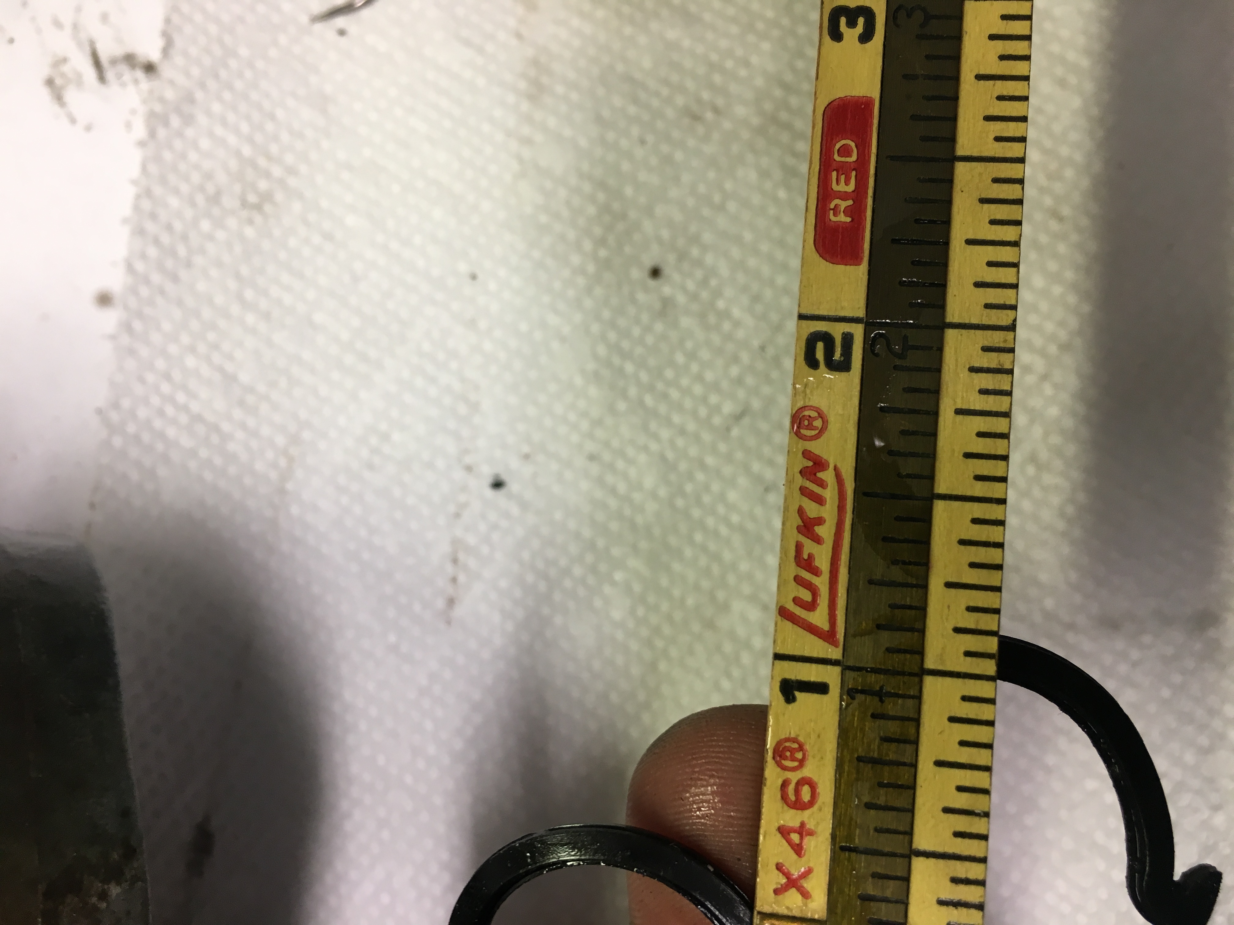

Greeting Forum members. I have a Ford 1700 tractor that has been sitting for approx. 10 years or so. 550 hours on meter. It starts up nicely and is very dependable. The hydraulics on the other hand has been my issue. The hydraulics was very sporadic in the beginning. I drained the hydraulic fluid and the screen/filter was pretty dirty. The hydraulic oil looked like a light caramel colored fluid. I filled the tractor back up and the hydraulics worked......for a while then stopped working altogether. I forgot to mention that the tractor also has a front end loader. Now I'm in the process of replacing all of the o-rings in the hydraulic system and so far so good. Well, I removed the hydraulic pump (gear driven) and everything looks good to me except the o-rings look flattened to me. I looked everywhere I can think of and I'm having a hard time finding the o-rings for my hydraulic pump.
The part number for the pump is 307001-3300. I attached some pictures of the internals of the pump. Any help greatly appreciated!!! Thanks in advance!
Phil

We used to buy o-ring material in a roll and splice it to make whatever size was needed. I think it was from McMaster Carr.
