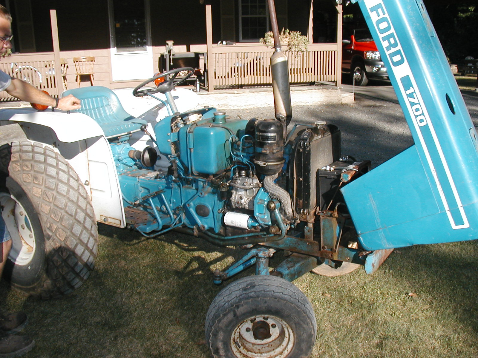

I have a model 1700 ford that I recently bought and was planing on reselling after removing the 6ft rake that came on it. but now I'm thinking of using it's PTO output for a back up electric generating plant.
We rarely loose power but I want to have reliable back up just in case, with a family of 5. We have city water so a well pump is not part of the equation, we have an oil fired boiler for hot water and heat, just one fridge, an electric range, alot of lights, tv's, computer.
There's two scenarios of use, 1st is survival mode, when the power is out and unknown when it would be restored, then it would be used sparingly 1-2 hour intervals 2-3 times a day. the 2nd would be luxury mode when the power is out from a pole down or winter storm etc. then I might run it non stop for 6-8 hours at a time, living like nothing ever happened.
I have gas powered job site generators I use as a contractor, but I want diesel reliability at home for both the above scenarios. I'm thinking of the winco 11 KW they have at Northern or equivalent, I'd never need that much power in survival but probably would use close to that in luxury.
I was looking into stand alone diesel powered gen-sets but they are expensive especially if you want liquid cooling, so since I have the Ford tractor and a back up (JD 4310) all I need is the pto generator, the 1700 puts out 23.3 HP at the PTO according to Nebraska test data, I would mount the generator to a carry all frame and put it in a decent environment for storage taking it out when needed or to test/exercise.
Does anyone know if this tractor would be a good power plant for this application? seems like a stout little 2 cylinder 1.3 liter (Shibaura) engine. From what I've been learning about this subject one big concern is the ability of the engine's governor to keep output current steady enough to not do damage to appliances etc.
The tractor has 2600 hours on it and has to turn 2450 rpm's to get 540 pto speed. one reason I want to go diesel is that I always have 500 plus gallons of #2 on hand, so no gasoline to store.
Sorry for the long winded set up, but any comments, pro or con will be appreciated. John

I have the same thoughts. I am going with a stand alone genny. I don't need to have my tractor PTO running at 540 rpm (2300 rpm engine speed) with the chance the tractor will run out of fuel and my injector lines will then suck air. Also, my tractor is 85+ decibels at 2300 rpm. I would not be able to sleep with that noise near my home. Finally, my wife would never be able to hook up the PTO gen, start the tractor, fill it with diesel and know how to bleed the injector lines.
Now, a gasoline fired genny (electric start) with low oil shutoff and gas cans she can handle. She would be "killed" by the tractor thing.

I'm of the school that says the less moving parts, the better. An 1800 RPM generator directly coupled to a diesel engine would be quieter, turn slower and probably consume less fuel. I love the engine in my 1910 and theTC40A but a 10KW gen on a 3 cyl Lombardini was a whole lot cheaper and smaller than an outboard Winco PTO and doesn't put hours on your tractor. Another consideration is how fast the engine governor can respond to load changes. Just remember when the need arises, you'll have to hook all that up on a cold, rainy, dark night dodging lightning bolts and vicious vampires... Well, anyway, you get the point! Just my 2 cents!

I agree with you 100% on the 4 pole generators (1800 rpm's) for fuel economy, noise and reliability. I've got a 1/2" thick file on them after all the research I've been doing, they would be my first choice if my needs were greater, we have a company near by that puts together 4 pole sets with 3 cyl liquid cooled yanmar engines as low as 5 KW, I don't agree on the price comparison though, those 5-8 KW units (yanmar, Isuzu, Kubota powered) are close to $5,000. or more, you are paying for a super premium engine don't forget. Northern sells a 7 KW pto for $800.00.
Since this planning could be for a real survival emergency, money is not the primary factor for me, but I'd hate to spend more money on a beautiful machine that's just gonna sit there and require upkeep, I figure the tractor is always maintained in top order and always has fresh fuel etc.
As far as noise goes those gas generators would be louder than the tractors I think and as far as engine wear and tear goes the ford turns 2450 rpm to get the 540 pto speed, at 2450 the ford is not that loud and sounds very smooth and stable, not like it's coming apart or anything, plus the ford is not used for anything else special right now so I'm not worried about putting hours on it. Just want to know if the ford 1700 would be up to the task?
The jury is still out for me, not really sure what's best for me, I have definitely overanalyzed this topic though.
One more thing, does anyone know of other PTO generator companies? I've only found Winco, Tigerpower and Northern even after google search.

I have one of northern's 12.5kw jobs... I've used on my 8n as well as my 5000.
For sure.. the 8n struggles with a large load and the gov'ner ain't as fast as it used to be.. but for incandescent and loads like power tools.. it's fine. I've hooke dup a freq meter and vom to it.. and in most cases, the power output is as clean or cleaner than my utility feed.
When i run it on a larger tractor.. like my ford 5000.. it's rock solid steady... you can kick on the well pump and nothing flickers.. etc.
I'm not one of those people that has to run my generator all day and all night.. I like it there to keep the fridge cold for a couple hours at a time.. and to pump up some water, and heat it for a shower.. IE.. intermittant use..
I also have mine mounted on a cary-all... real fast hookup.. 3 pins and a pto shaft..

I also say go for the tractor mounted setup. Tractors do not have an issue running at PTO speed for extended periods. One less engien to maintain.
Noise- park a little ways away and cable. Regulation will be fine for appliances unless you overlaod.
