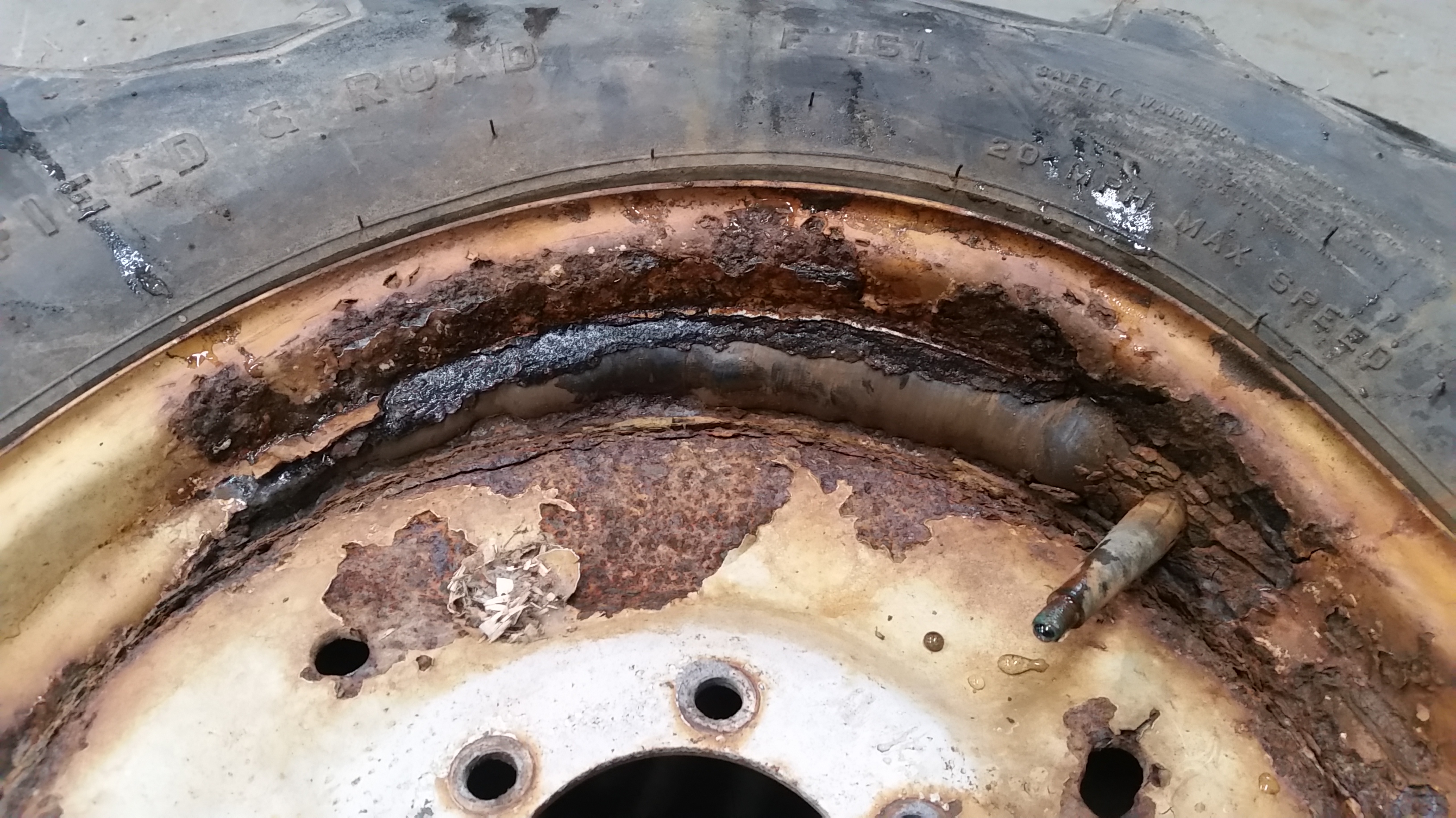

Hey All! New here, need some help. I just picked up a rather nice Ford 1100 Compact. However I have an issue with the rear rims...
I bought some new tires for it, and in taking the wheel weights off in preparation for mount/balance, I discovered both my rear rims are junk.
rust formed between the weights and the inner lip of the rim and destroyed both of them. The old tires held air only because of tubes. There are massive
holes in the rim, one valve stem broke off, trust me, they are junk.
My issue is I cannot find a replacement rim to save my life (at least not something for $350 a rim)
Anyone know of where I can get something like this? New or used, don't care as long as it will work.

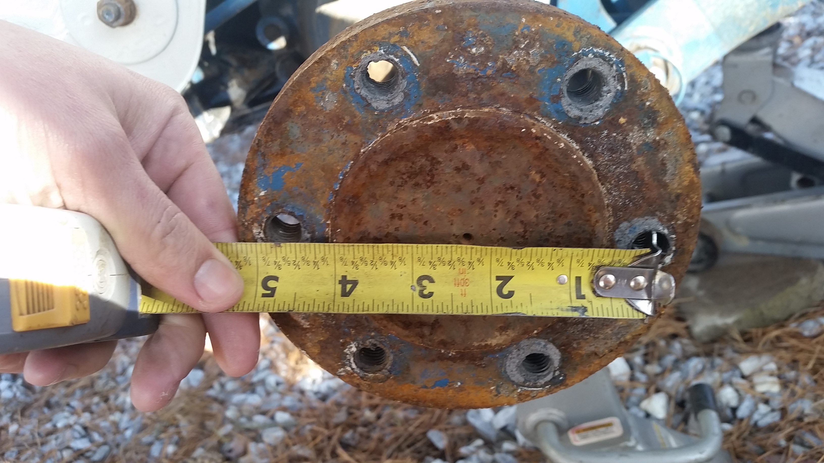

The bolt pattern is 6 on 4-5/8. That' s my biggest issue. Picture attached

No USA wheel manufacturer is making replacement metric wheels.
If the "Center Disc" in your wheel is good, you can order a "Blank" rim with no center disc. Cut out your old center disc and reuse it in the new rim.
If your center disc is not good, you can have a welding shop with a plasma cutter make you a new center disc.
Or we can have a new wheel custom made to fit your tractor.
