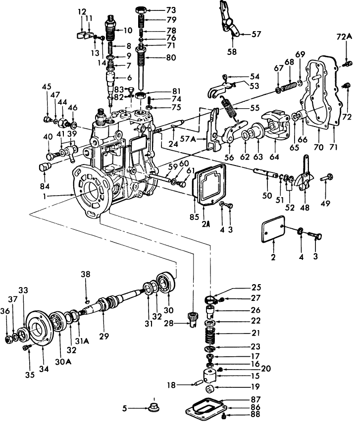

   / ford 1600 injection pump #3
Here's a break-out I found in my files of the Fuel Injection Pump
Does anyone have the description page referencing the numbers on the diagram.?
   / ford 1600 injection pump #8
The pump was made by:
Diesel Kiki which is now:
Zexel..
If u do a Google search for your pump number and leave off the last digit or two, it’ll probably come up..
(PES2A*****)
