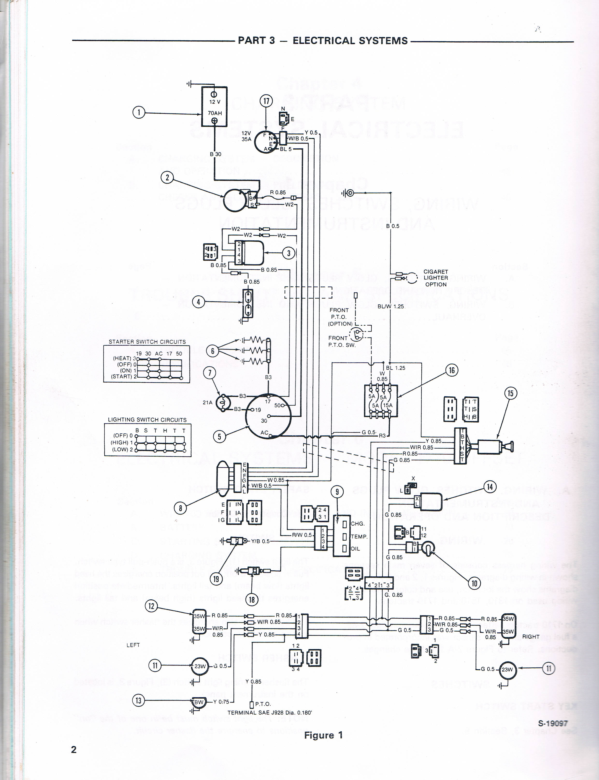

Jan 9, 2013 / Ford 1520 wiring diagram #1 D double hunter Gold Member Joined Nov 2, 2010 Messages 431 Tractor Ford 1715 Is there a site on the net where I can pull up a wiring diagram for a Ford 1520.
Jan 11, 2013 / Ford 1520 wiring diagram #2 duroc Gold Member Joined Feb 15, 2012 Messages 336 Location Michigan Tractor NH T1510 HST What year and, is it for sure a 1520 and not a "T-1520"?
Jan 11, 2013 / Ford 1520 wiring diagram Thread Starter #3 OP D double hunter Gold Member Joined Nov 2, 2010 Messages 431 Tractor Ford 1715 1990 ford 1520
Jan 12, 2013 / Ford 1520 wiring diagram #4 R randy41 Veteran Member Joined Jul 2, 2005 Messages 1,794 Location Linden VA i've got a schematic for a 1510...would that help?
Jan 12, 2013 / Ford 1520 wiring diagram Thread Starter #5 OP D double hunter Gold Member Joined Nov 2, 2010 Messages 431 Tractor Ford 1715 I found a schematic but the one I found does not have the wire colors, if yours show the color of the wires it would be great

Jan 13, 2013 / Ford 1520 wiring diagram #6 R randy41 Veteran Member Joined Jul 2, 2005 Messages 1,794 Location Linden VA this is for a 1510.
Jan 13, 2013 / Ford 1520 wiring diagram Thread Starter #7 OP D double hunter Gold Member Joined Nov 2, 2010 Messages 431 Tractor Ford 1715 Thanks for the info but i think the 1520 is different, the 1520 has a fuel cut off solenoid and thats one of the problems I'm having is furnishing voltage to this solenoid in the run position, I ordered a new ig sw Fri., I hope this is the problem.
