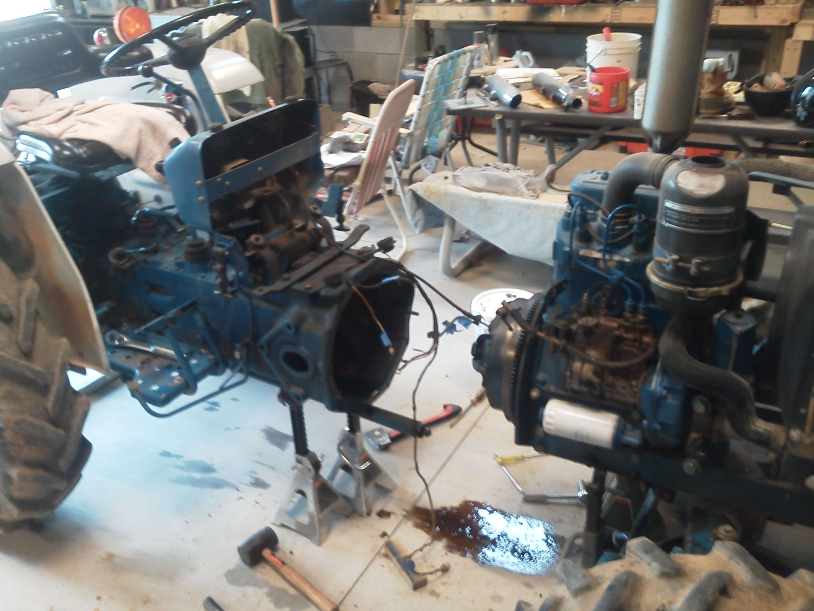

I am currently in the process of replacing the clutch on a 4x4 1500. I have sourced the clutch, pressure plate, and throwout but have been unable to locate a part # for the rear main seal. The flywheel seems to be in good condition with no gouges, are there any recomendations on other items to inspect or replace while I have the unit apart? There were no unusual noises before disassembly,just a little slip under heavy load, clutch was out of adjustment room, and after inspection there was some oil contamination to the disk. Tractor has a little over 6000 hrs on it. I appreciate any suggestions as this will be my first clutch replacement and have no manuals to rely on.
current progress

Click on this link: http://www.messicks.com/NH/65672.aspx
When the page appears, select "engine" in the menu at left. Then scroll down to crankshaft, and flywheel, and click on it. Look for #19 in the exploded view, and in the part description. Part number is listed there.
Just double check to make sure it is the right one.

Check the front seal on the transmission while it is apart.

I would resufrace the flywheel too if you're putting a clutch in. Might as well do the job complete and do it once the right way.
