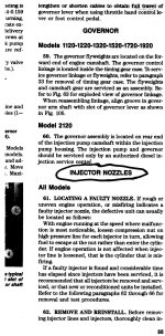

This info from my I&T Shope Service shop manual for NH1320 manual nbr FO-46.
I scanned the pages for Injector Nozzles. I hope this may be helpful. Hope attachments work OK.

Leemac,
Thank you very much. :thumbsup: I can read them just fine. Looks like I picked up No. 11 - Seal Washer, rather than No. 3 - Gasket, in Fig 108. I'll have to get back to the dealer and see if he still has them in stock. The info you posted even has the torque spec for the injectors. Excellent.
