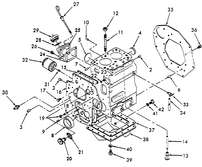

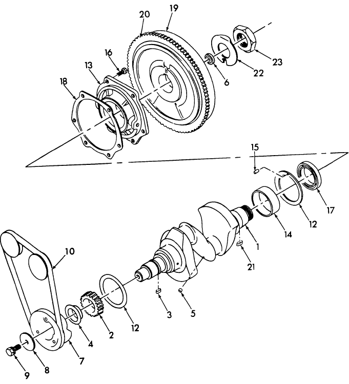

I've got a Ford 1300 tractor (Shibaura LEK802 Two cylinder diesel engine) and it looks like the front main bearing needs replacing. Most main bearings I've come across, like the bigends, are made up of two halves that are clamped together onto the crankshaft with a pair of bolts. Not this engine. The bearing is circular (or a short cyndider) and appears to be pushed tightly into the round hole on the block with no fixings that I can see. However, this is a tight fit and doesn't want to budge. How does the old bearing come out and how do I replace it with hammering it out of shape?
Any advice would be much appreciated.
   / Ford 1300 Main bearing replacement - How is is done?l #2
crank / rear main
1 1 SBA115256180 CRANKSHAFT Crankshaft Assy. Includes: Ref. 2 thru 6, Start Year: 01/01/1979

   / Ford 1300 Main bearing replacement - How is is done?l #3
front main / cyl block ( # 8 )frntmn.gif

Hi
It's probably a press fit (also referred to as an "Interference" fit). You'll most likely have to press it out. That will require removing the engine. If you know what you're doing you could try dry ice (to cool and "shrink" the bearing) and tap it out. I've never seen this done on an installed engine though.
I suggest you not tap on the bearing. Use a spud with the smaller diameter a few thousandths smaller then the bearing inside diameter.

I just put main bearings in my sister's 1300.
You'll need a bushing driver the correct size for those bearings. They are a "one piece" bearing and are truly more like a bushing than what we normally think of as a main bearing. I used a driver from my HF set of bearing race drivers, but I can't remember which one it was.
Before you drive the old bushing out, make note of how it's positioned in the hole, you'll need to line the new bushing up the same way so the oil supply holes remain open.
Once you have the old bushing out, just use a driver of the correct size to drive the new one in. They are a tight fit, but not so tight that they need to be pressed in or out.
Hope this helps.

And as Roy said..... there's no way to replace the main bearings without removing the engine and then removing the crank.
Many thanks Roy and Trader - that's really helpful. The engine is already disassembled - I'm putting in a second hand crank after the one in it snapped and I'd be tempted to leave the bearing where it is but the old crank was under size and the replacement standard so without new, standard bearings it won't actually go in.
