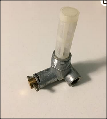

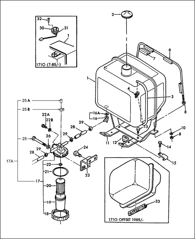

Couple of thoughts:
Have you checked if there is a free flow of fuel coming from the tank to the fuel filter & injection pump by disconnecting the supply hose at the pump inlet?
The shutoff valve on the bottom of the tank may or may not have a strainer which could easily be clogged in an older tractor.
Also make sure the shutoff valve fully open.
Ford 1300 tank & filter:
Generic shutoff valve & strainer:
