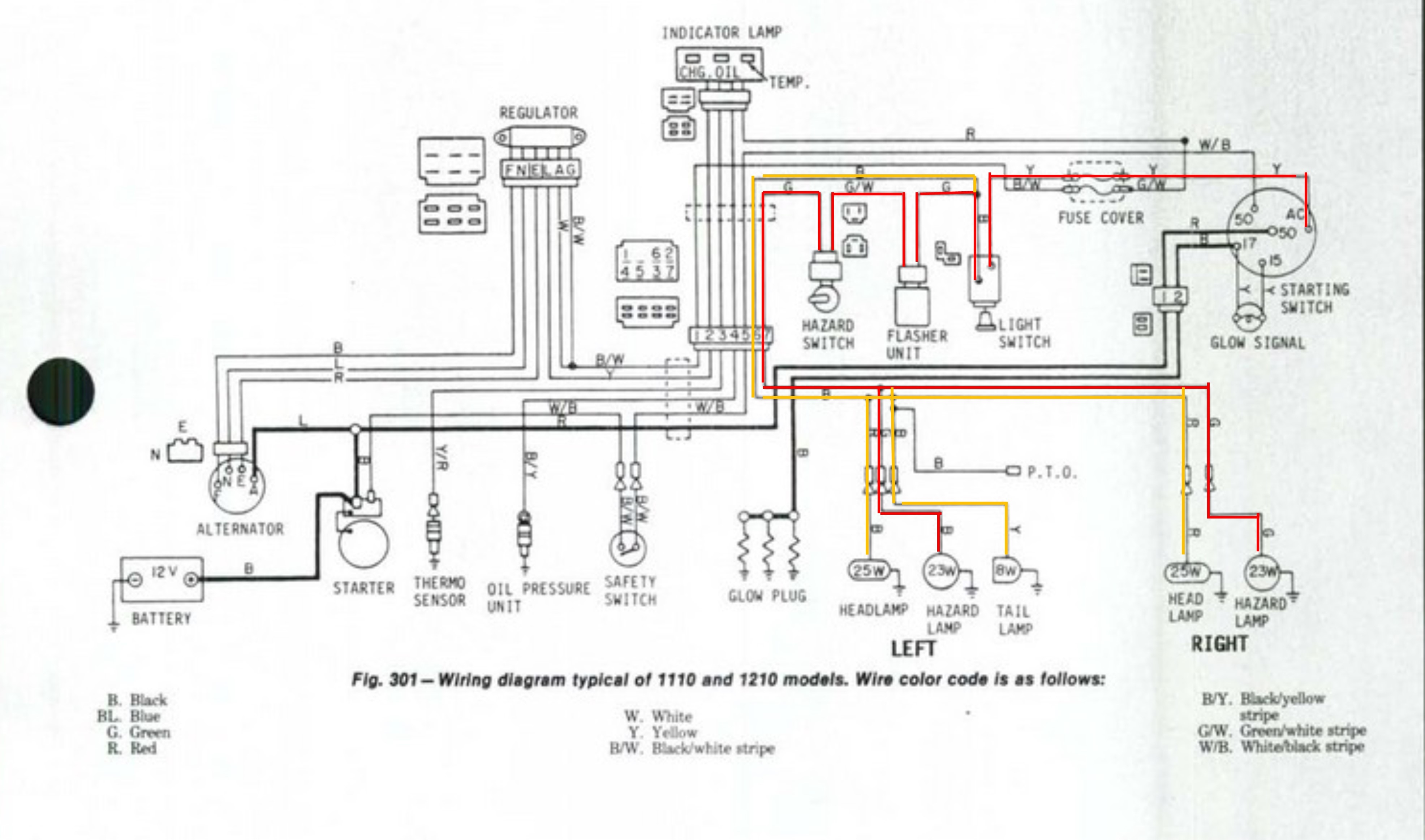

I have a Ford 1220 probably early 90s. I am trying to repair my lights on the rear ie tail lamp, flasher and a work light. I am slowly working my way forward. Testing the wires and connections. Can anyone tell me what fuse these are on? I see three in a little box on the firewall, one is missing.
Also can anyone tell me what idiot light is for what? My dash is very faded and cannot be read anymore.

I don't have the schematic for the 1220 but if it is similar to the 1210, I have attached the 1210 schematic.
According to the parts list for the 1220, it should have a 3 fuse fuse-holder but only 2 fuses in it.
All of the lights pass through one fuse which is connected to the light switch. The flashers have an additional switch on the other side of the light switch.
The other fuse appears to be for the dashboard indicator lamps (Battery, Oil, Temperature).
Good Luck!
