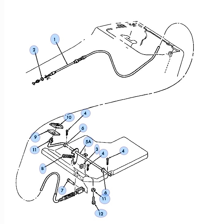

Hi
I recently bought an old Ford 1220 that we've been fixing up.
Everything that we wanted to service or add has been done but it is missing the foot throttle pedal mechanism.
I'm making do with the hand throttle but it would be a huge bonus to have use of both.
The only remaining parts of the mechanism is the cable going to the governor.
There aren't any OEM parts available in the UK, so it will have to be a DIY replacement.
Please can anyone provide photos of the pedal mechanism or point to an exploded parts diagram of it, that would be a great starting point to go from.
Thanks
   / Ford 1220 accelerator/ throttle pedal info #2
Welcome to TBN!

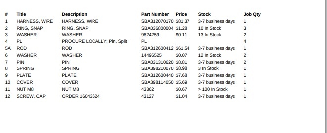

Thank you, that's a big help, are there any parts numbers with this?
   / Ford 1220 accelerator/ throttle pedal info #4
Here you go
