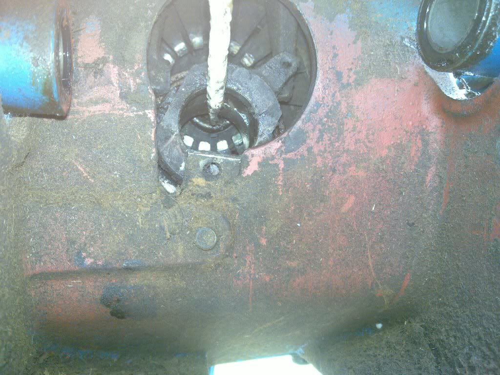

Well I took a gamble and split the tractor between the transmission housing and the clutch housing. I did this because after some research I though it was a hydrostatic transmission issue as thats where the noise seemed to come from. Well from the outside the hydrostatic pump seems ok, the noise sounded to me like i might of stripped all the teeth on the front of the input shaft, but they are all fine.

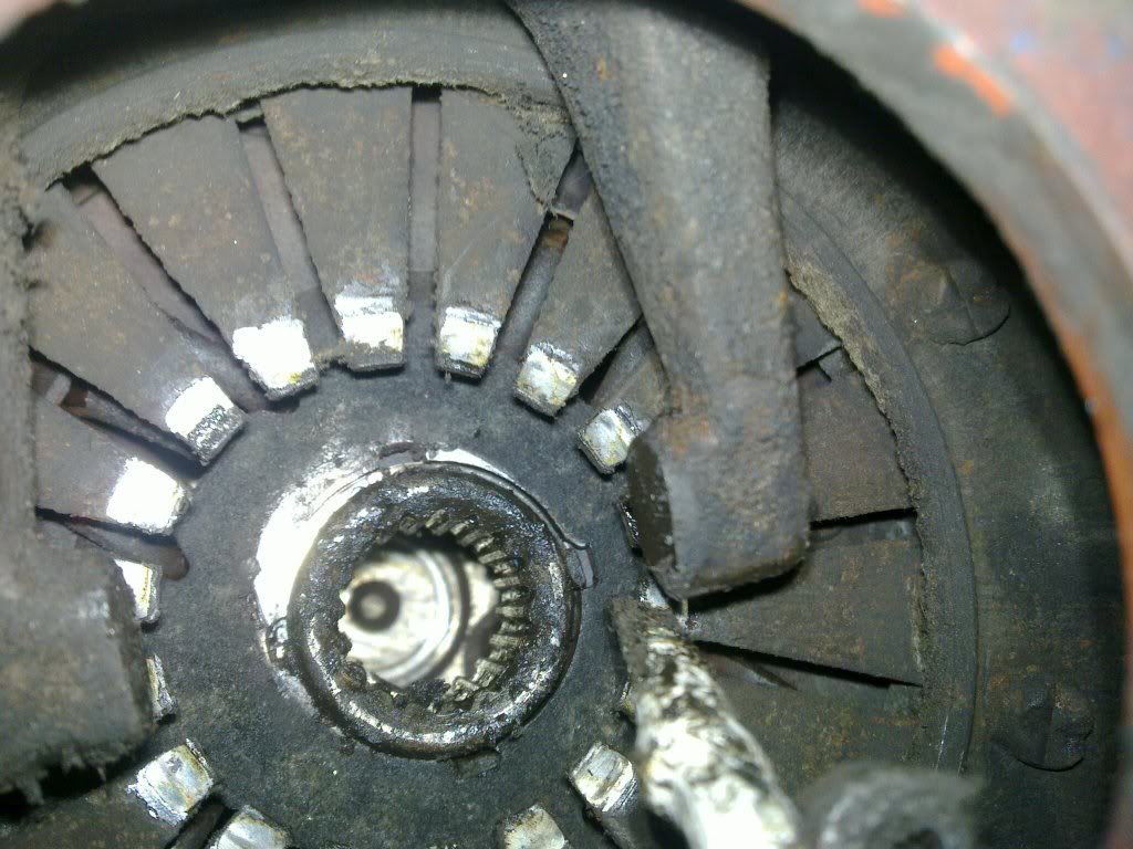

However, when I poke my head in and look up into the clutch I see, the following items shown below. I know nothing about clutches so is that the release bearing hub I am holding up with the screw driver, it appears to fit onto the fork but at the moment its disconnected.
Also there appears to be damage to the coupling that the transmission input shaft fits into. Its a bit loose and of the 4 teeth around the perimeter 1 almost appear broken so it isnt a very tight fit.
Does any of this look broken, and be the cause of the loss of drive??
Thanks Matt

Hi BrisMatt,
It appears to me that you have a failed clutch throwout (Ford calls it a release bearing).
If so, and to get at the clutch components, you have split the tractor in the wrong place. Go back and split between the engine and bell housing.
According to the Ford 1120 / 1220 repair manual, the clutch system is the same, identical for either the HST or the MT trannies. The throwout bearing is pressed onto a sliding hub which is moved by the cross shaft fork to engage the pressure plate fingers. FYI, my throwout bearing is a NSK 24TK308B2 V3, which is Ford part number SBA 398560110.
Inasmuch as the clutch system is lightly used with the HST relative to that of the MT, I would expect that the rest of your clutch system components will be in good shape and fully reusable. Just relube the obvious places, disk to input shaft spline and the sliding hub to tranny tube, which was my problem.

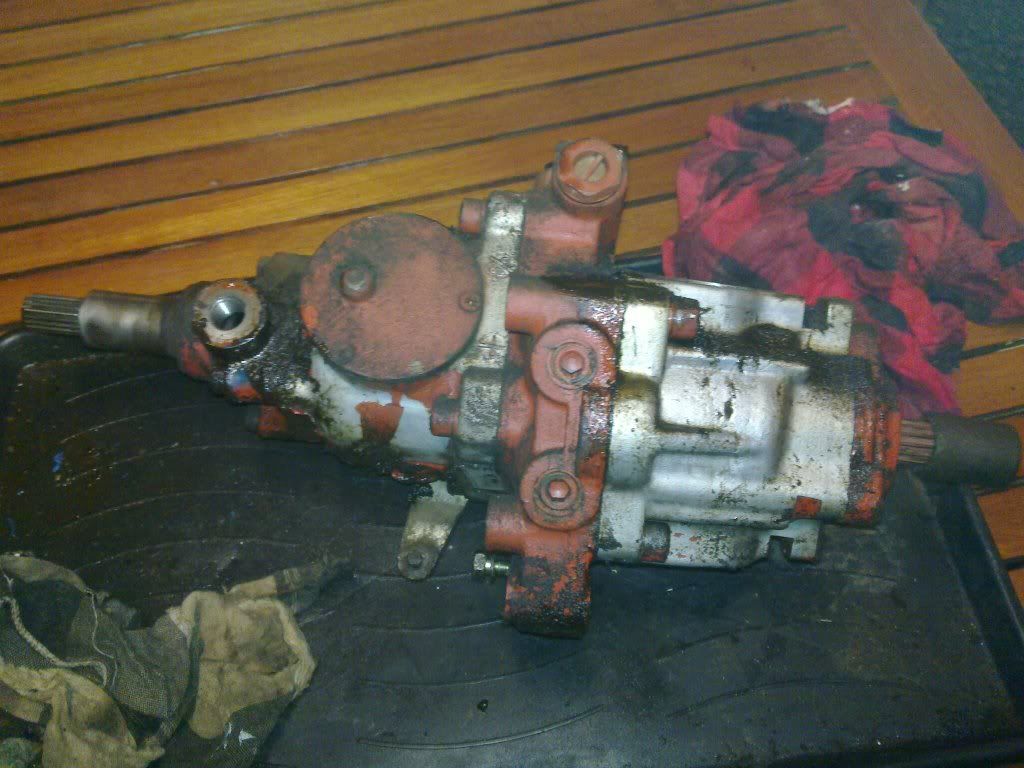

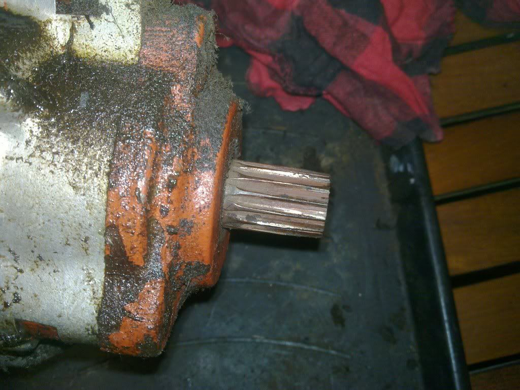

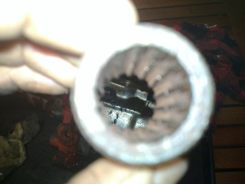

well I pulled the hydrostatic unit out and it turns out it was a broken spline. On the output shaft there is a coupling and the teeth on that were completely stripped, so was the teeth on the shaft, hopefully that can be replaced. It does kind of make sense, when the damaged occured I heard some metal shearing and now when the accelerator is applied you get a sort of crunching sound. Here is the photos below
I had a friend look at the clutch and he agrees it needs replacing, the internal coupling on the disc is loose and not far from breaking so I will also replace the clutch disc whilst I am at it. No doubt if I left it in its current state it would fail a couple of hours after putting it all back together.

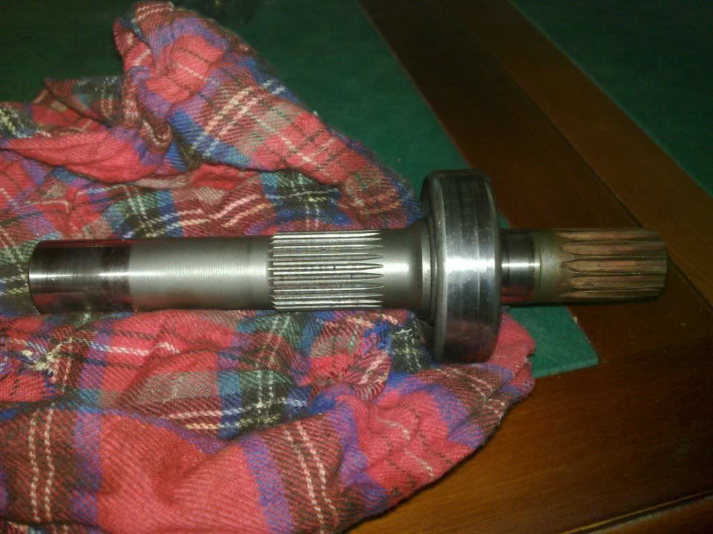

I have pulled the broken shaft out of the hydrostatic unit.
Its about $600 by the time I get it to Australia!
Hopefully someone can repair it, I have been looking at a few websites and apparantly you can fix these things.
