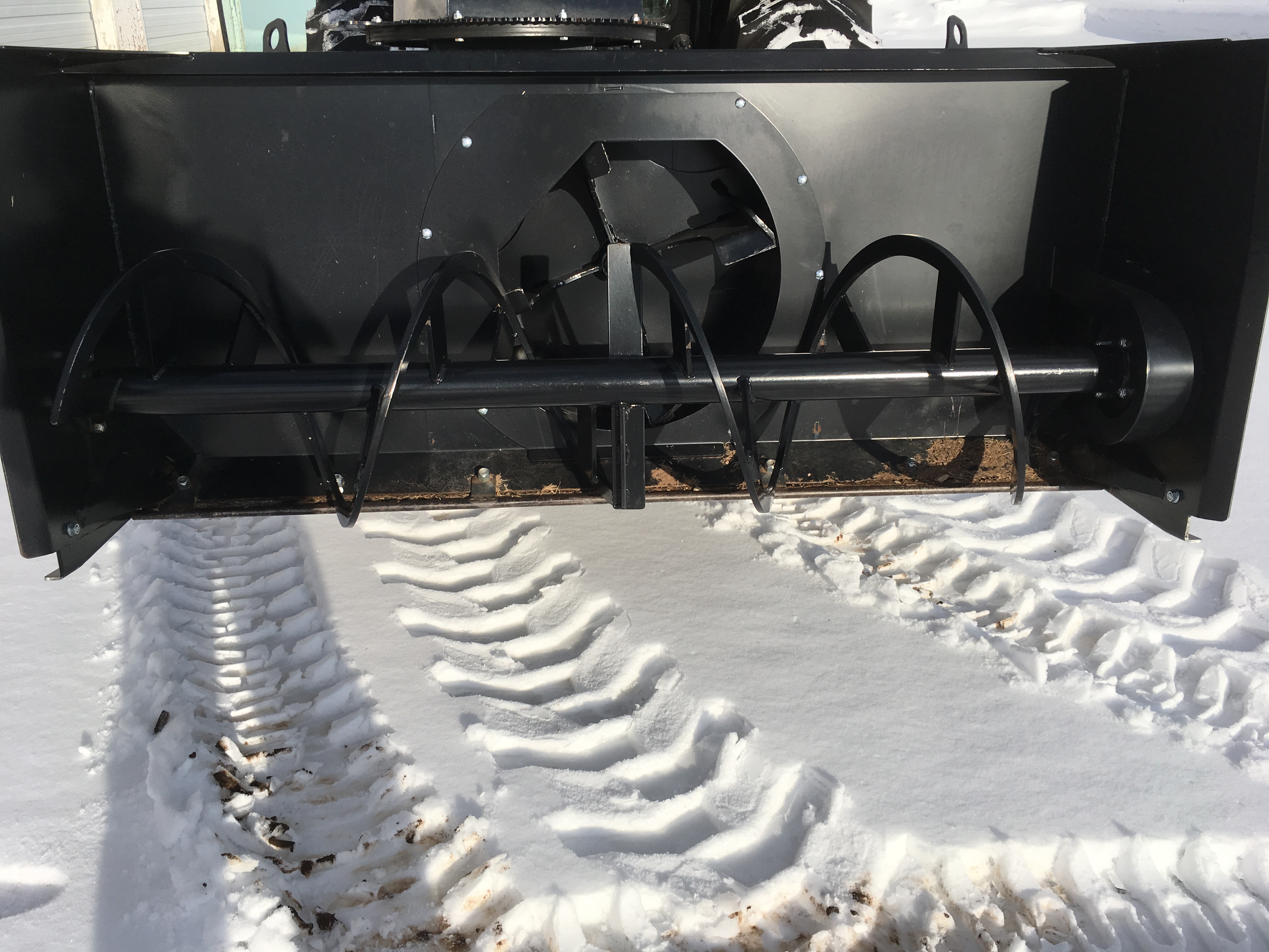

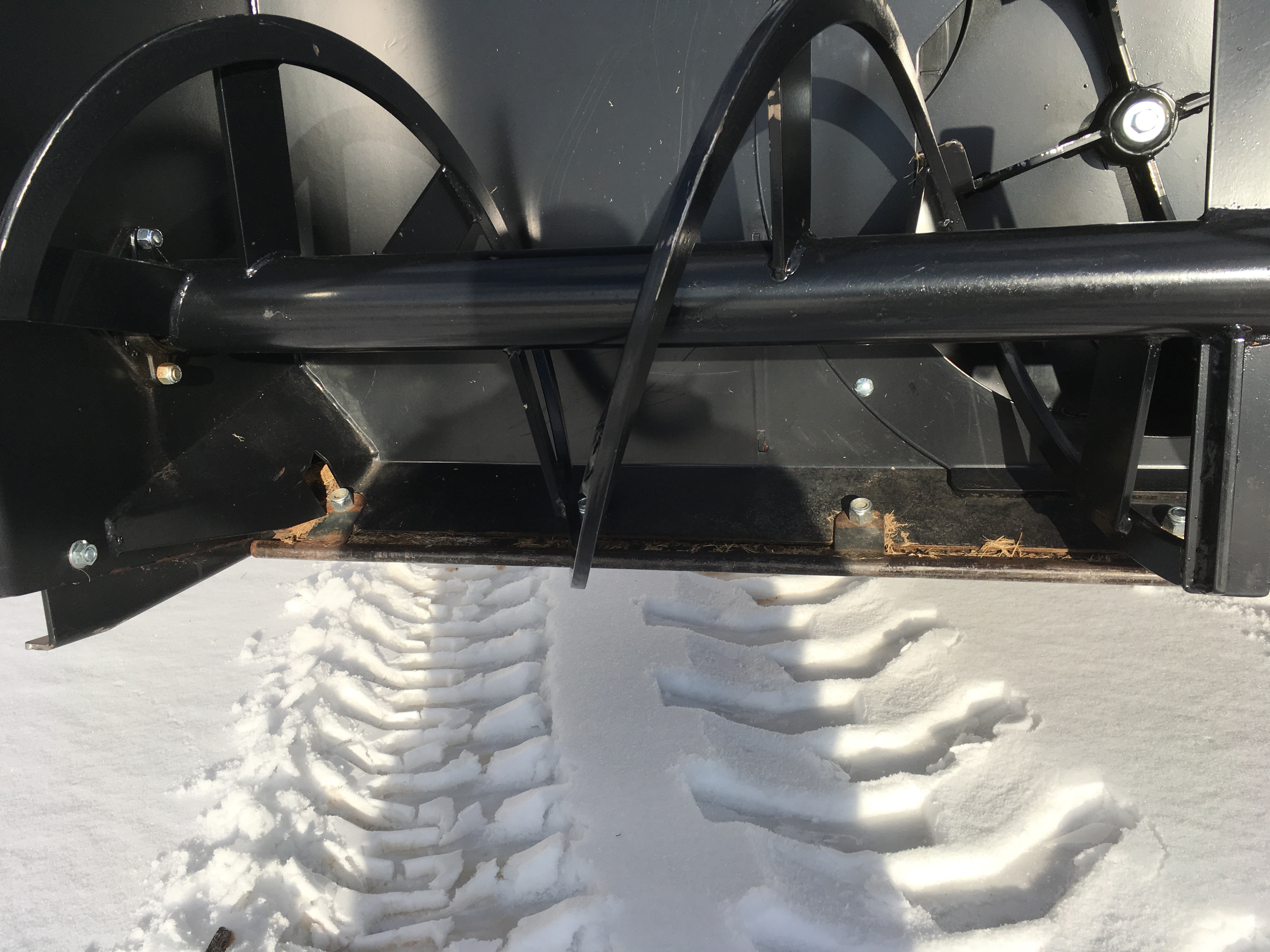

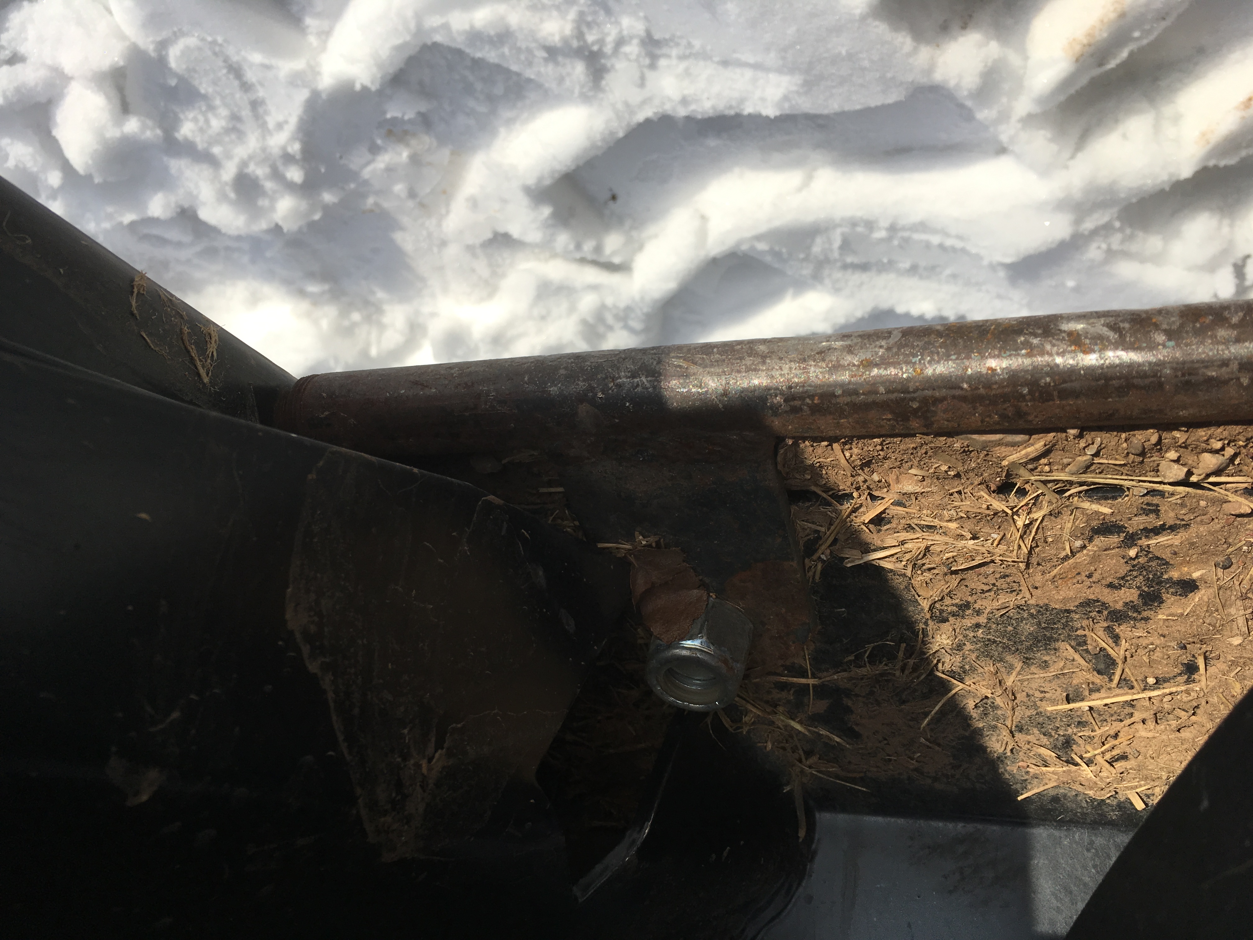

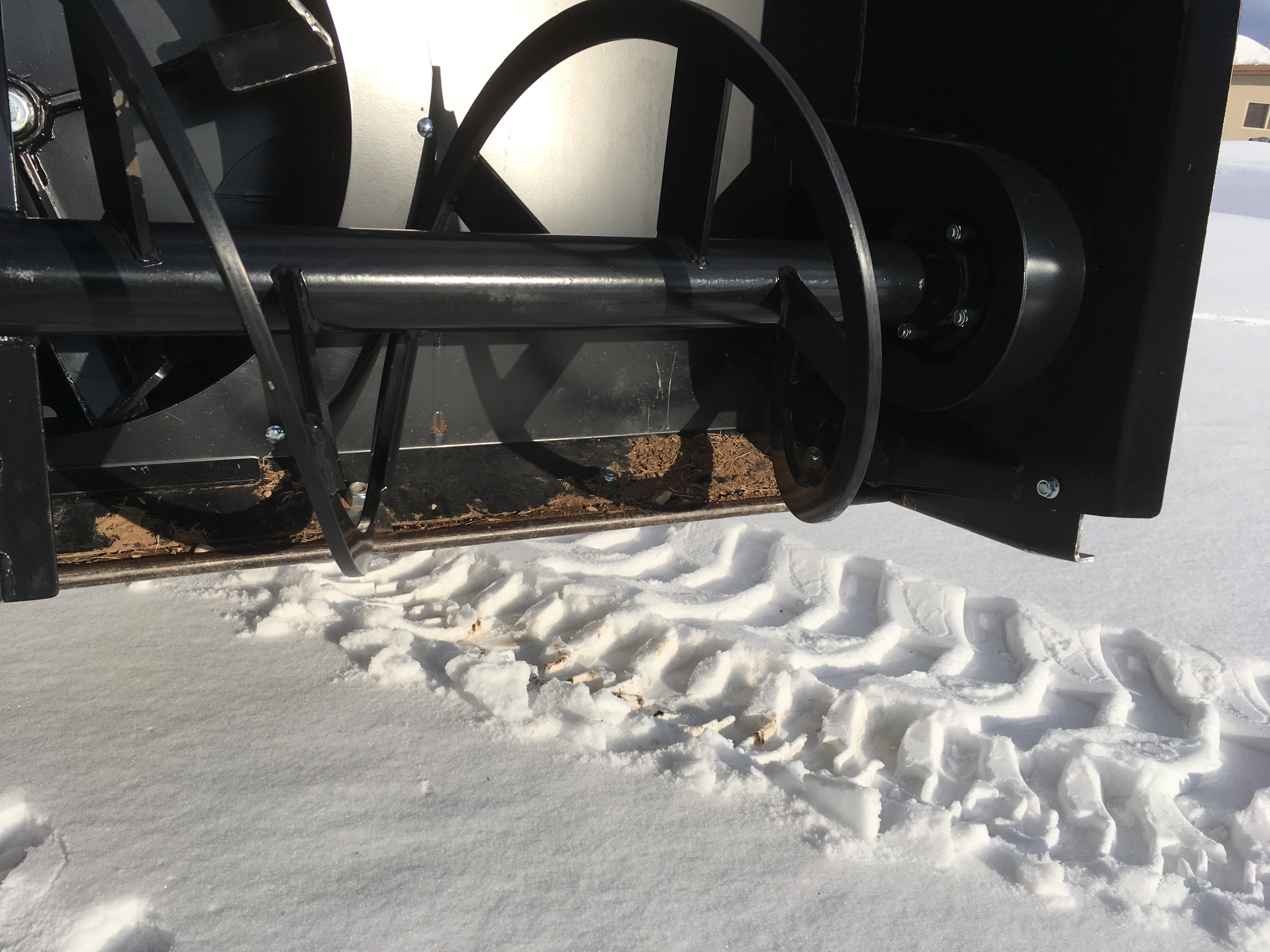

I tried to send you the pictures you requested but in the message mode I didn't find how to send them so here they are. Not great quality due to poor lighting but if you need more just let me know.
Basically I just used a plasma cutter to cut a notch in the pipe. Slipped it over the blower cutting edge and welded some tabs to the pipe to hold the pipe in place. The bolts are the same ones used to attach the cutting edge to the blower.
