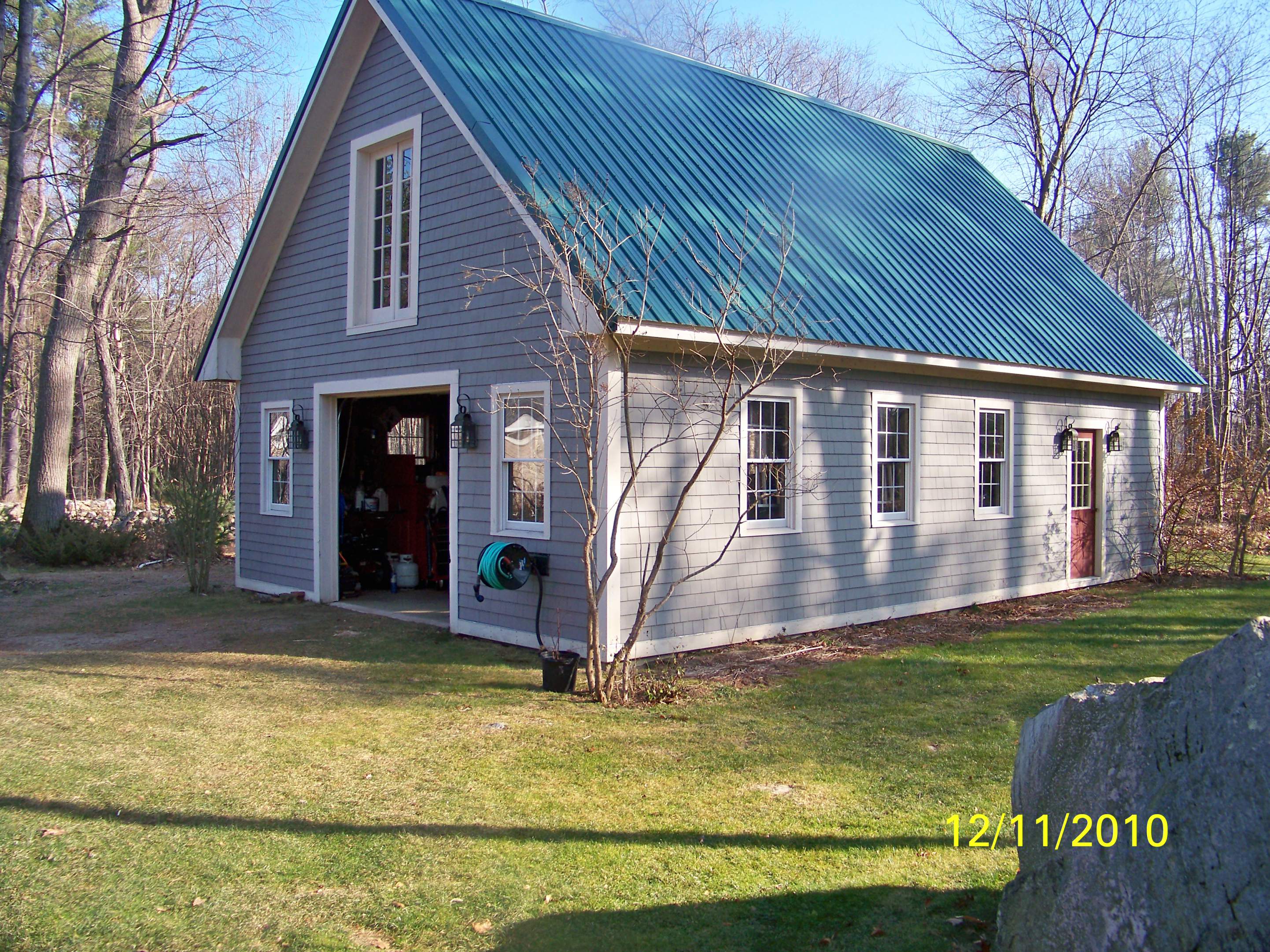

im a little confused i been price footing and foundations and every one come back with diff sizes.one 8x10 another 8x16 and last 16x20
i can't get ahold go the inspector the guy with 16x20 said i need an 8 inch foundation wall .for a garage?

I am not sure what you mean by 8x10 ect. Here in Va most footers are 18" or 2' wide and 6" thick and an 8" block or 6"crete foundation wall would be correct for most cases.

I am a little confused also. There are only two measurements to the footer itself. Width, and thickness. Like Ed, most around me are 18-24" wide and 6-8" deep. Do I dont understand what you mean by 16x20???
And as far as the 8" foundation wall for the garage, that is correct. On a conventional stick build, They will dig below frost, pour the footer, and then lay 5 or 6 courses of block on top of the footer. Then you attach the ledger board to the block wall and build up.
It might help if we knew some more details as to what you are building or working on.

Trench with rebar:
Footer poured, block stacked:
Sticks up, and partially sheathed:
Apron poured:
Getting there:
Done:
Is that more or less what you are trying to do?

Really nice looking shop:thumbsup:. What size is it and how deep are your footing?
Note: you can count the blocks in the foundation. Each CMU is 16"x8"x8". :)
Seriously, though, internally the workshop is 13'x17'. I would have preferred at least twice the size (really -- who *doesn't* need a bigger workshop?) but alas it was a "rehab" of an existing structure and it was more straightforward for several reasons to rebuild the same size.
The top of the footings are at minimum 24" down from the finished grade, code here for a dwelling. Overkill for a workshop, but if you are going to go through the trouble you might as well do it right.
