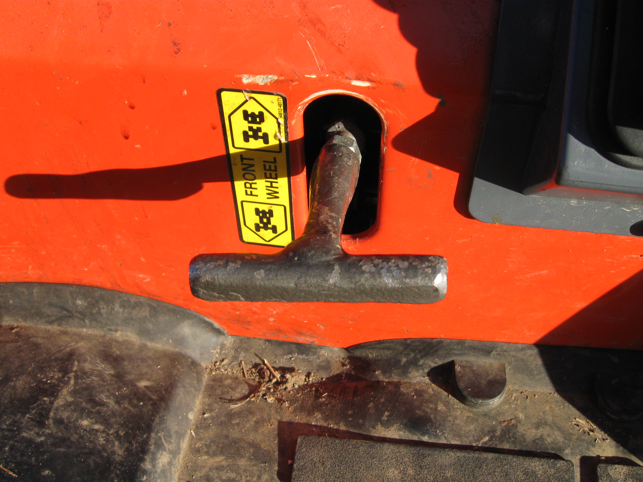

After trying several different things to re-attach my CK 25 4WD knob, which came off and stripped out after repeated foot assisted shifts into 4WD, I made a steel T-handle and jam nut deal that is both easier to use with your hand and just right for heeling it into 4WD.
And yeah, I know, I use the bucket to take a bit of pressure off the front axel and don't try it moving and put the clutch in and stick it in 4 WD sometime aound the middle of November and take it out sometime in April and all that. It still was a pain sometimes to engage and if I recall correctly, the knob came off at least once disengaging it.
It's fixed now. I'll post a picture thies evening. -WSJ
I'd like to see your solution. The OEM knob design is just weak. I would have thought they would have fixed that by now. I guess not enough people are complaining about it. I'm still living with the old knob. But, I seldom take it out of 4WD anyway.

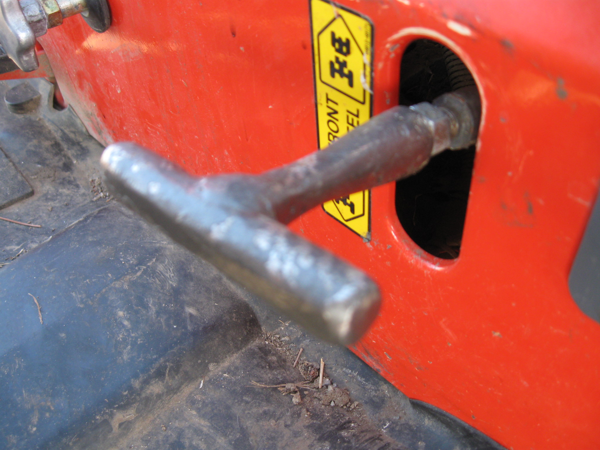

Here, finally, are a couple photos of the crude but effective shift lever mod. One bolt, 1 piece of old round mild steel rod from an old concrete silo for the T, 2 nuts welded together end to end, & one jam nut. If I had it to do agian I'd shorten it by maybe a half an inch.

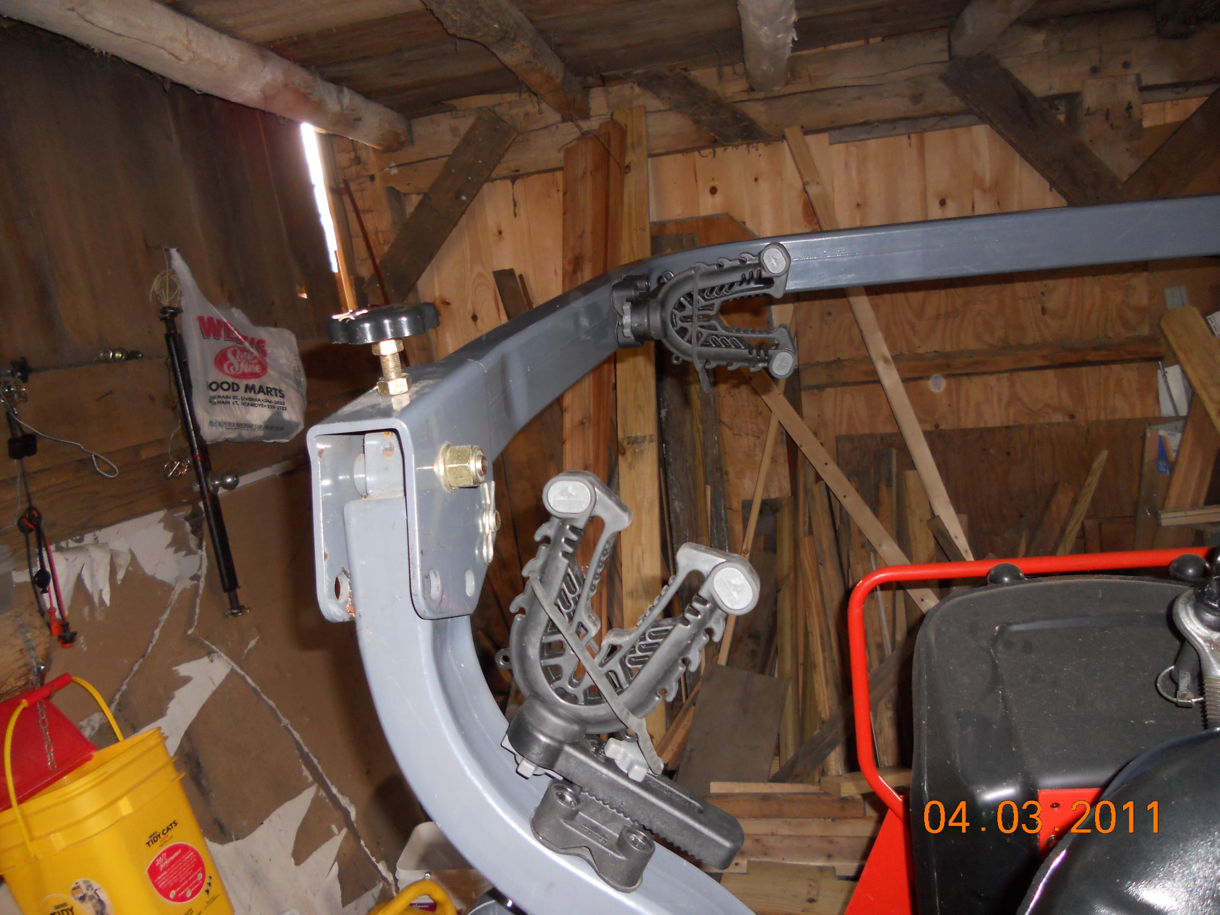

Wow, since I actually managed to make pictures appear, here are a couple more from today: the latest cool chainsaw and gun rack (saw today) and a PVC tow chain/lopper/utility holder.

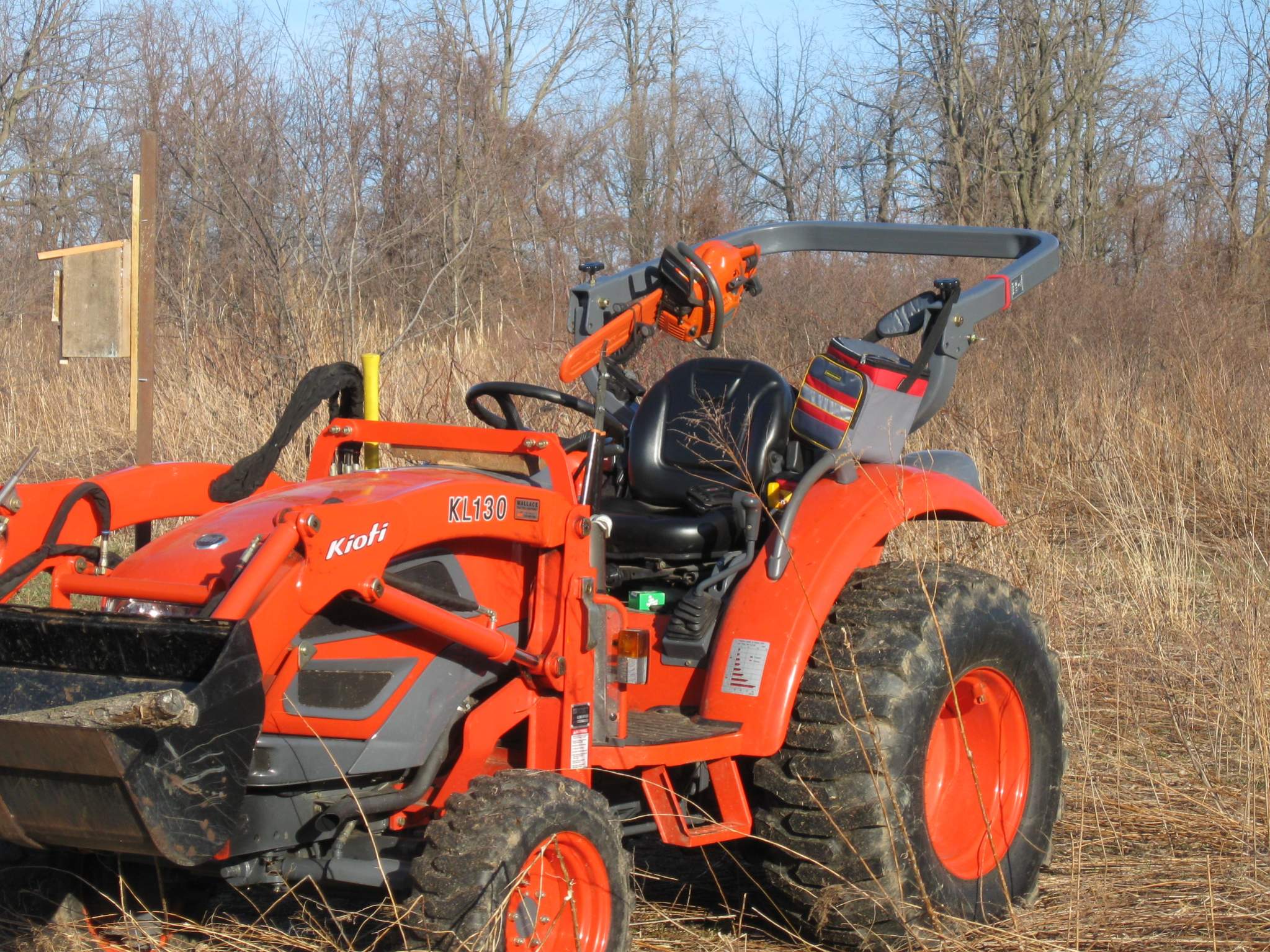

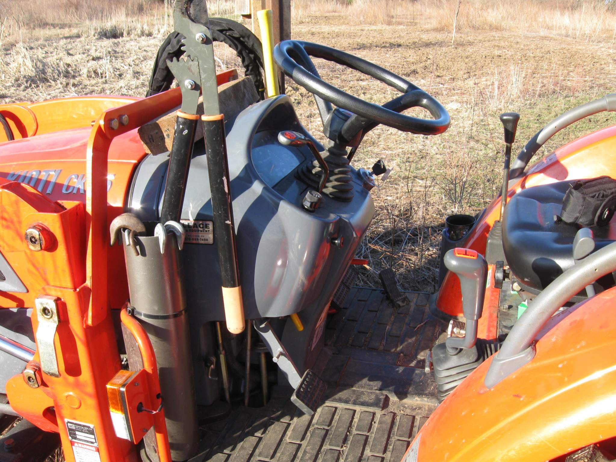

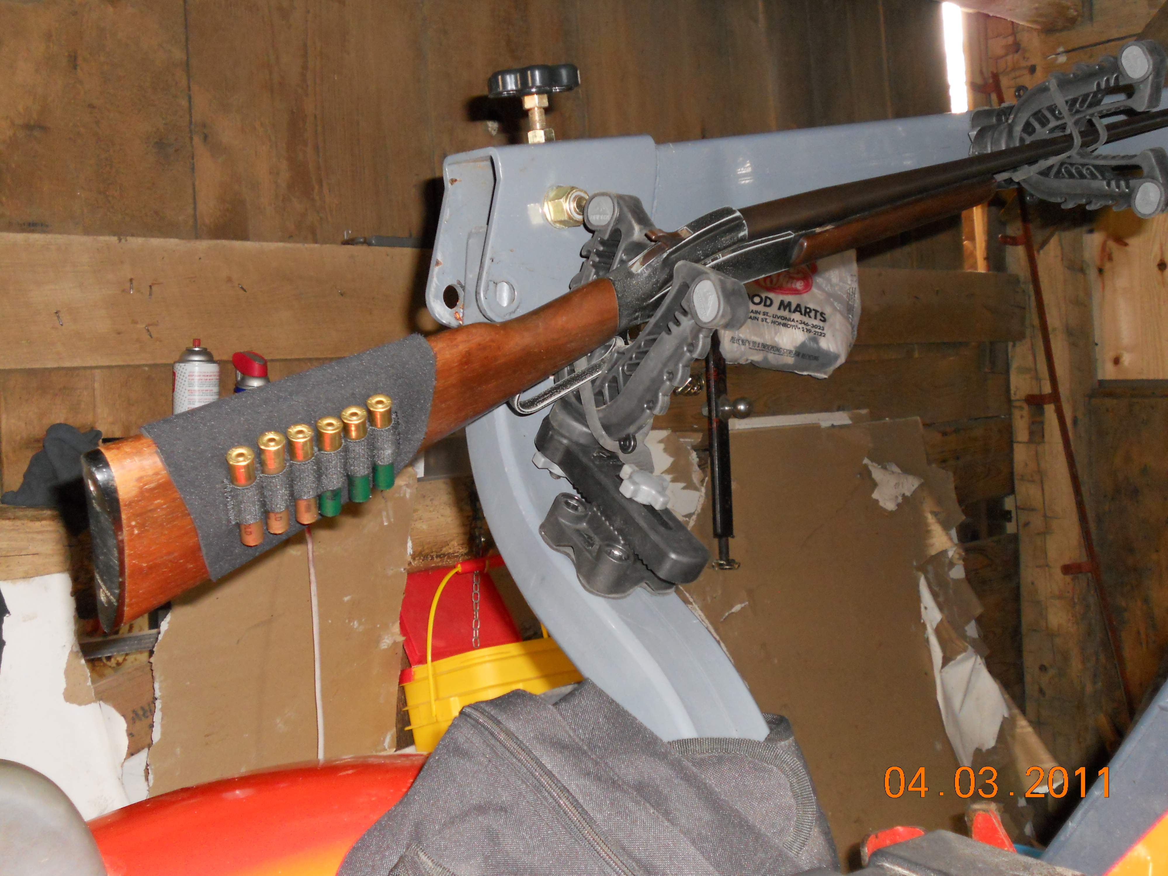

OK! On a roll, so here are a couple with the 410 single on board in case I'm attacked by house sparrows or starlings or red squirrels. Rack is a ATV TEK Flex Grip Pro that I mounted with self tapping screws instead of the ATV rack style pinch mount. Nice system.
