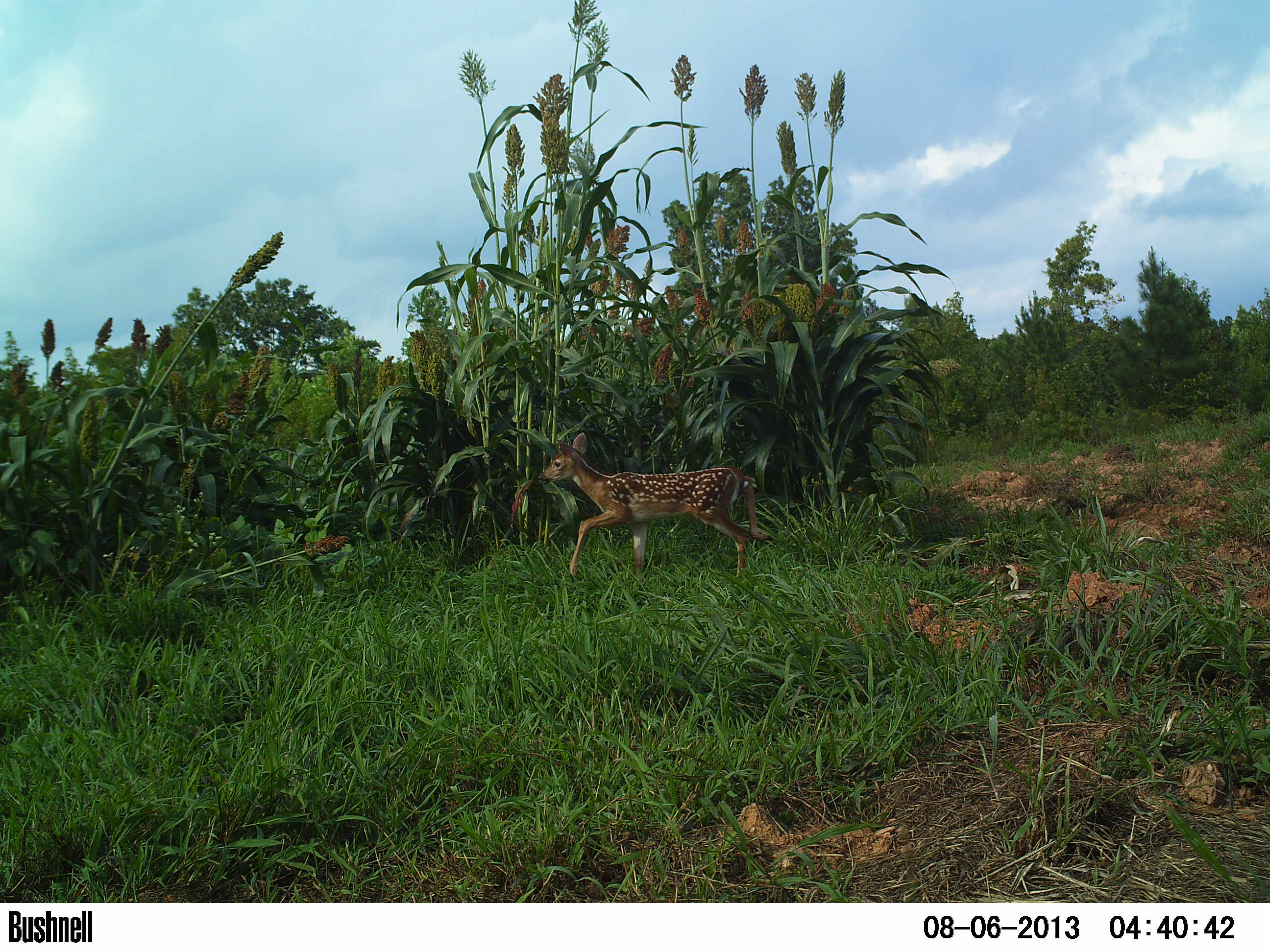

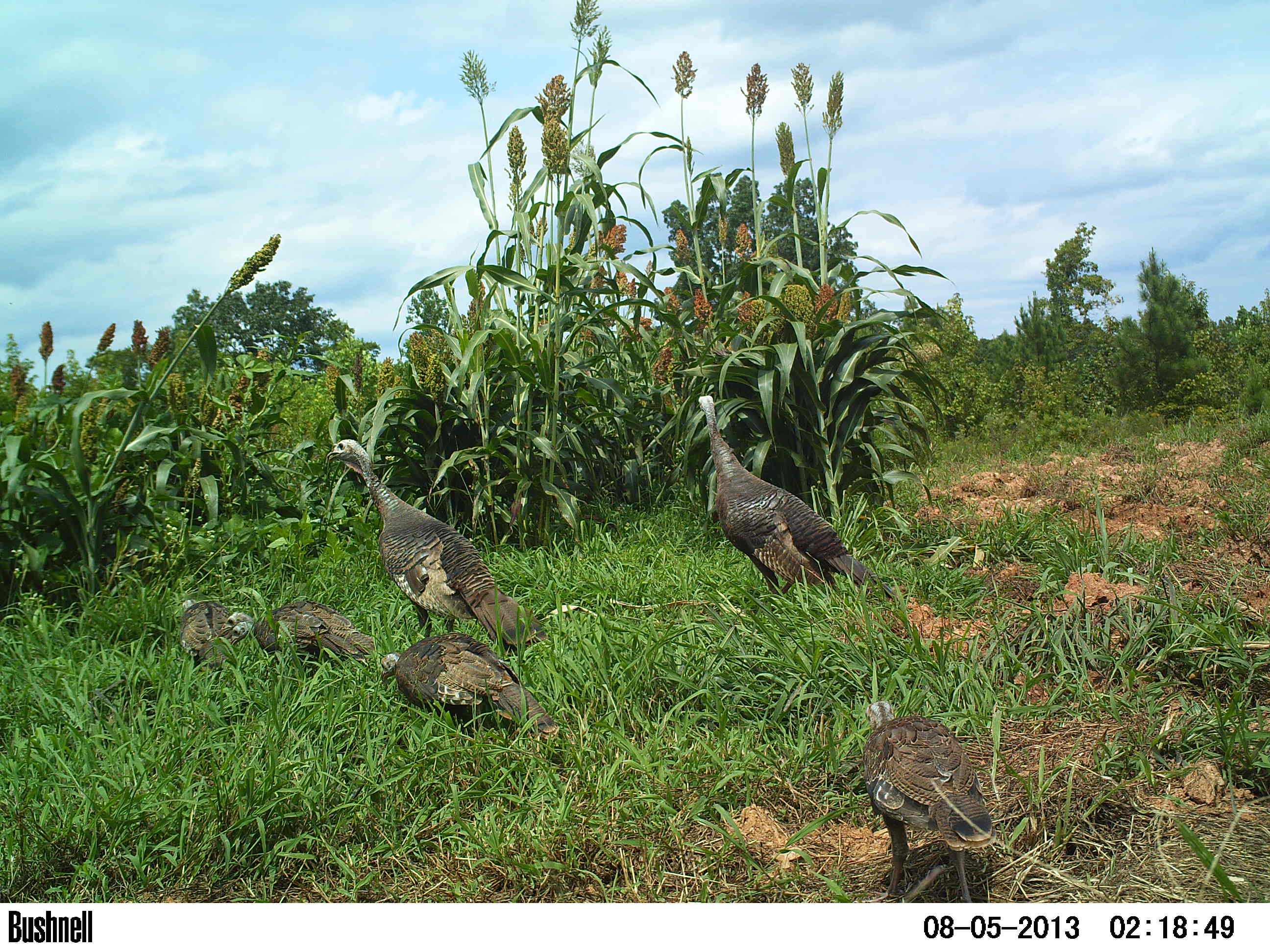

I have really bad clay soils. For the last few years, I've had a local farmer deliver a truck load of composted chicken litter. Soil is now much improved. I have a cultivator to break up the soil, and have an old 4' tiller to make it smooth. Hand broadcast seeds, and have a chain link mat to settle the seeds. Have had great success with few implements. PICT0065 (2).JPGPICT0096.JPG

How on earth do you get your food plots so tall? Here in the hill country of Texas soon as the deer figure out what I planted is eatable it gets chewed down to the ground within 24 hours.
It is frustrating to work hard see something start to grown and then a heard walks through and cleans it out in no time at all. I feel bad how under nourished the deer are around here, but wish they would give it a chance to grow a bit more...
   / Food plotting with L3200 4x4, which implements? #6
Well, we've had more rain this summer than I can remember. Getting lots of deer and bear in...and, as seen in the picture below, I'm lucky I have anything standing. He seems to be enjoying his meal!
