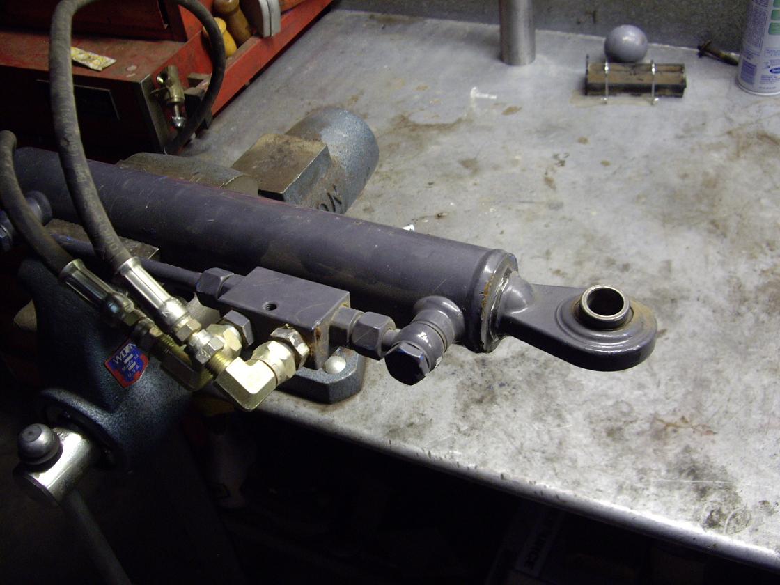

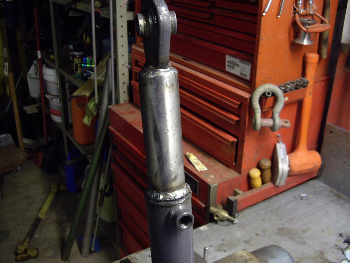

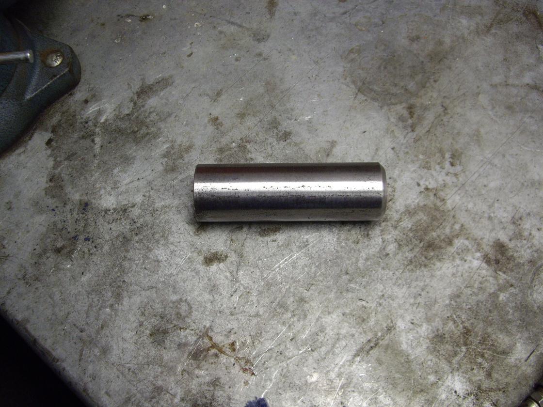

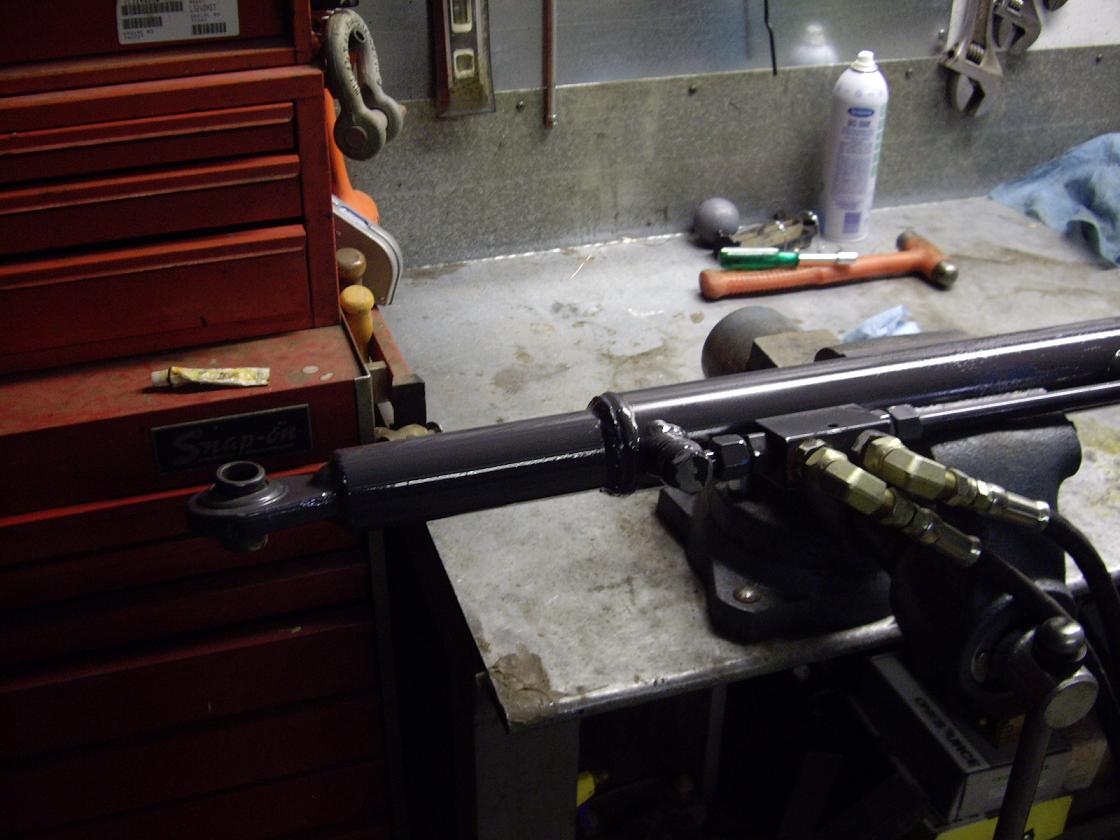

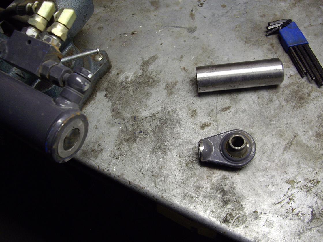

Here pics of the mods I made on the top link from 3240 for my
permanent fix.
#1 The cylinder before I cut the end off
#2 The 1 7/8 inch OD by 1 1/8 ID (3/8 wall) 6 inches long pipe.
#3 End cut off
#4 Parts all welded together
#5 Painted and ready top use.
Now my 5740 has a hydraulic top link that is long enough. :)

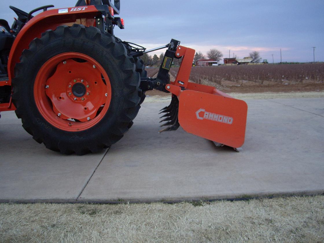

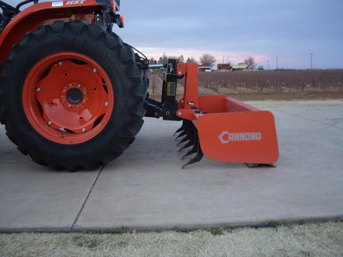

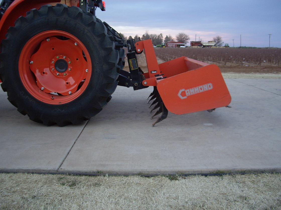

Now...
Pictures of why I want a long top link with a good bit of travel.
#1 The box blade level
#2 On it's nose. the scarifers can go 6 inches into the ground before the blade touches.
#3 On it's tail. I can feed material as large as 2 3/4 inches under the front blade.
This works really well. Stand the boxblade on it's nose and rip it up, level it and back in and drag it out and then spread it when you get where you're going.

Looks to me like you did a nice job.. what did you weld it with (rod and type of welder, and how many amps ?)
James K0UA
   / Follow up to my thread about welding on a hydraulic cylinder #5
That looks sweeeet....!!......:thumbsup:
James K0UA
Miller 250 wire welder. Lincoln wire, straight co2 gas, 20 volts, wire speed 225.
