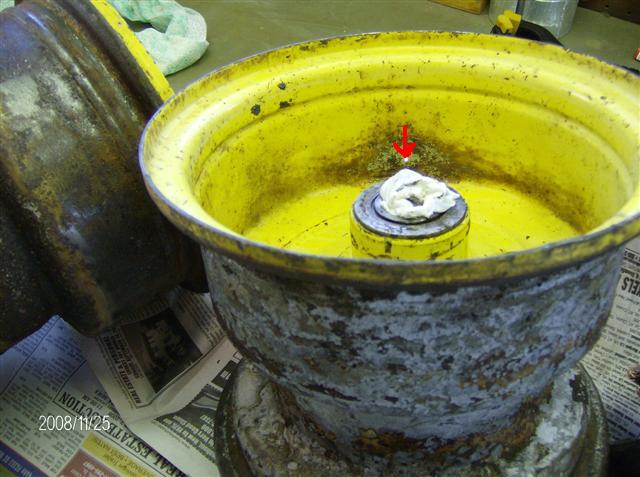

   / Foam for cart tires #10
Best stuff on the planet here - BULLETPROOF...
GEMPLER'S ® Ultraseal
If you don't like your rims! I've used it & it does work, but makes a heck of a mess if you need to remove the tire later on. Also, some brands rust the rims really bad! My JD 420 had some type of "hydro-seal" in the front tires when I bought it, had a pencil sized hole in one rim because of the sealant:
