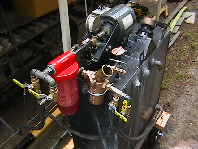

I would only consider flushing with a solvent (diesel fuel) in the case of contamination with dirt and/or grease. Water and oil are miscible, so just change it or filter it. I conjured up a unit that does just what you want. All you need is a little gear pump, and a Goldenrod filter. I use it for fuel and hydraulic oil. You just put the inlet and outlet hoses into the sump and turn it on. It recirculates as you cycle the system. Change filter elements often.

Thanks for the replies. My brother drained the oil out of his trackhoe and we put it in his crab cooker and heated it slow until about the boiling point of water, and managed to boil it out. I most likely will try draining it again and running some new fluid in, as I also need to change to a lighter weight oil. Pretty sure it is 46 in it right now, which from what I have read is too thick for this unit.
