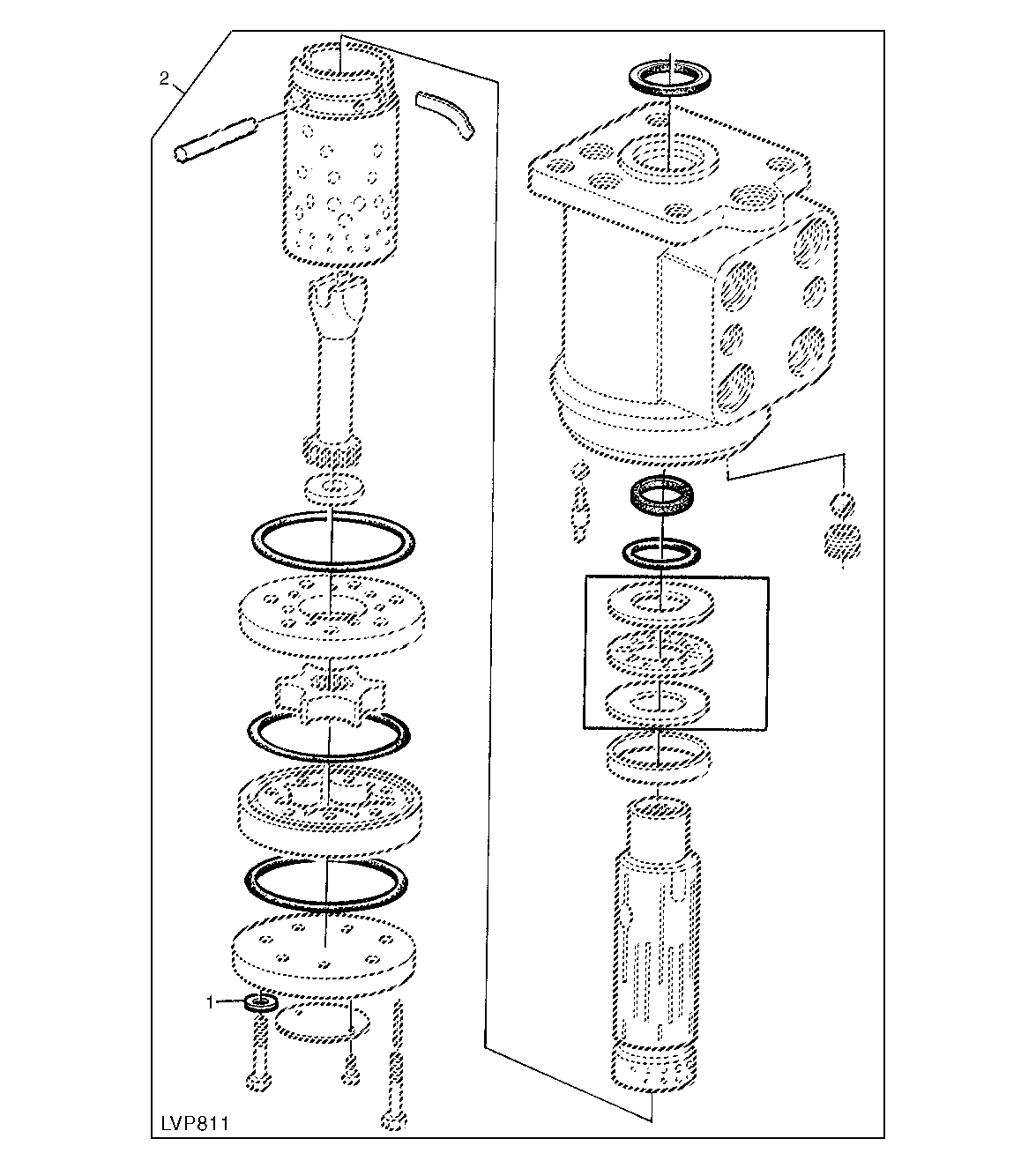

My jd 5310 has fluid leaking out under the steering wheel.It doesn't leak all the time but if I run it for a
long time such as cutting my pasture it leaks pretty good.I have searched for a parts breakdown on it with no luck.Is it just as simple as a seal under there or do I have bigger problems?Thanks

You can look at the parts breakdown for the 5310 by going to jdparts.com and even get the part numbers for a search on availability and prices.
   / Fluid leaking under steering wheel 5310 john Deere 4wd #5
It appears the only way you can get the required seal from JD is contained in a seal kit. AL112819 Seal Kit - SEAL KIT ADD 61.70 USD

If you feel that you need a tech manual to do the repair take a look at selectmanuals.com.
Not for this repair, but you need an online copy of the operators manual here is a link.
http://manuals.deere.com/omview/OMRE71736_19/
