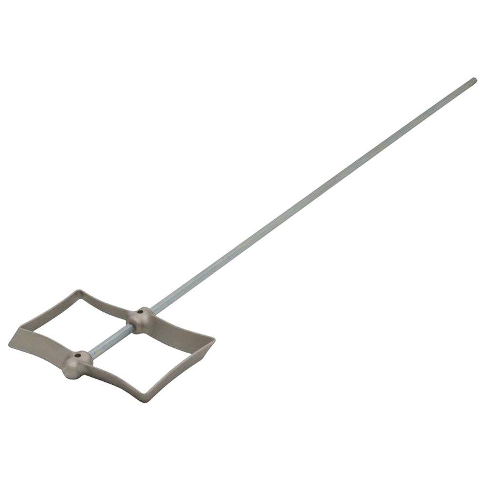

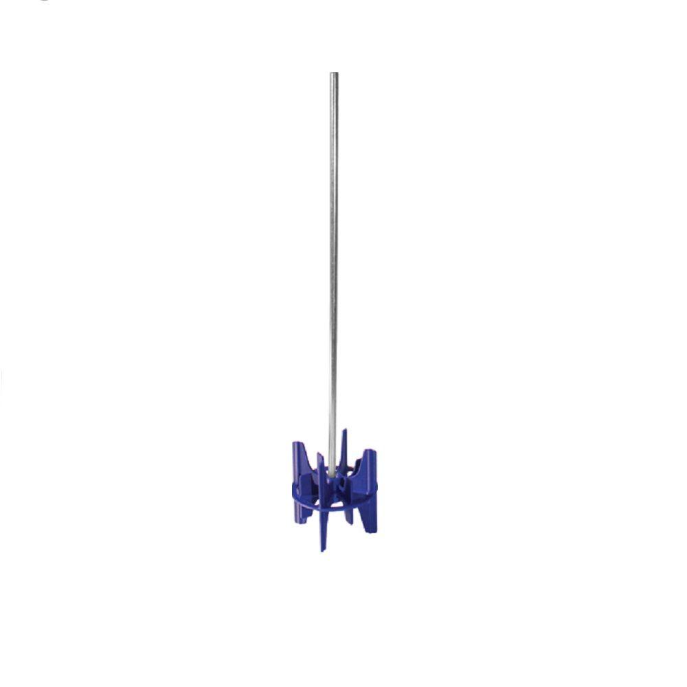

Many of us who can afford and own corded drills just use paint stirrers to 'loosen' FF in gallon cans.
https://www.homedepot.com/p/Warner-...with-15-in-Round-Metal-Shaft-192504/205052978 <$5
https://www.homedepot.com/p/Wal-Boa...=REC-_-pipinstock-_-205052978-_-100390691-_-N < $15
