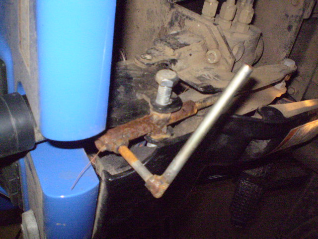

Here are a couple of pics of the mechanical adjuster that I built to replace the leaky shock. It is just as handy to operate as the shock was and the oil will never leak out of it.

Was your tractor laying on its side in the picture? . . .;)
If it works for you, it's good.:) Can you take a picture of it in different positions? Are you going to paint it blue or black?
   / Floppy tilt steering wheel
I haven't had the tractor on its side yet. I couldn't figure out how to ratate the pic when I uploaded it. There isn't much need to worry about paint as almost all of it is behind the cowling. Only the handle sticks out. I guess I could hit it with a little paint sometime.
