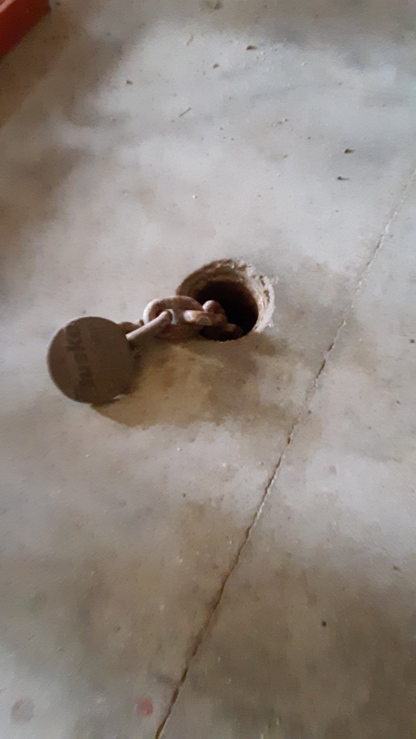

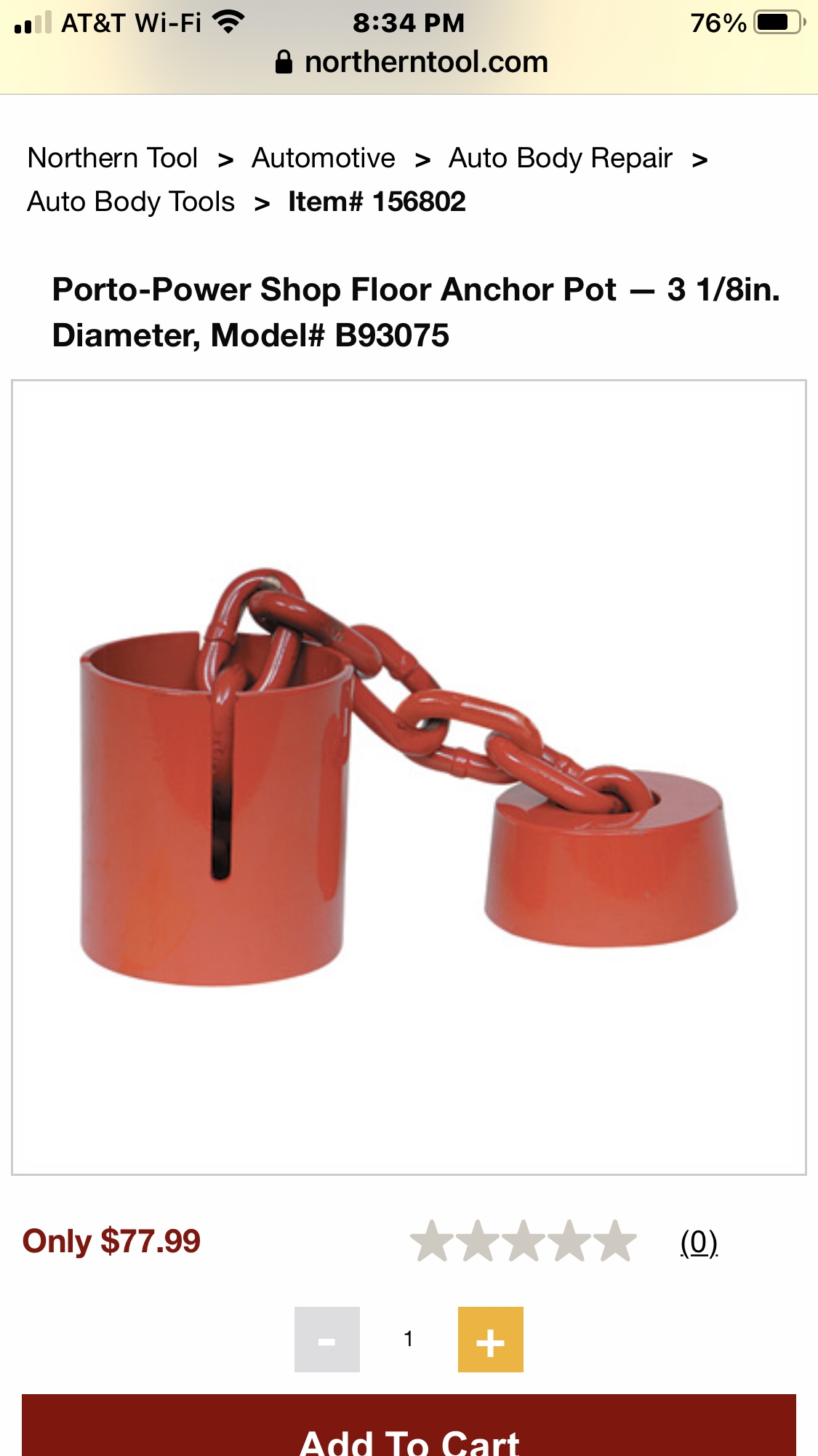

I used to have a garage with chains in the floor that a auto body man had installed but now I have moved and would like to install some of these.
They look something like these but probably a different brand. Do any of you have any suggestions?
   / Floor anchors #2
That seems very expensive. In my situation I was new construction and able to cast several different floor "accessories". I was lucky enough to find a guy that was waiting to drive on the scales at a scrap yard and got 8 of these for scrap money, iirc about $20. For some reason I recognized what they were and used them about 12 years later.
"Buske ez anchor" is cast into the top floor cover.
I've also cast a length of RR rail, up side down to weld to if needed.

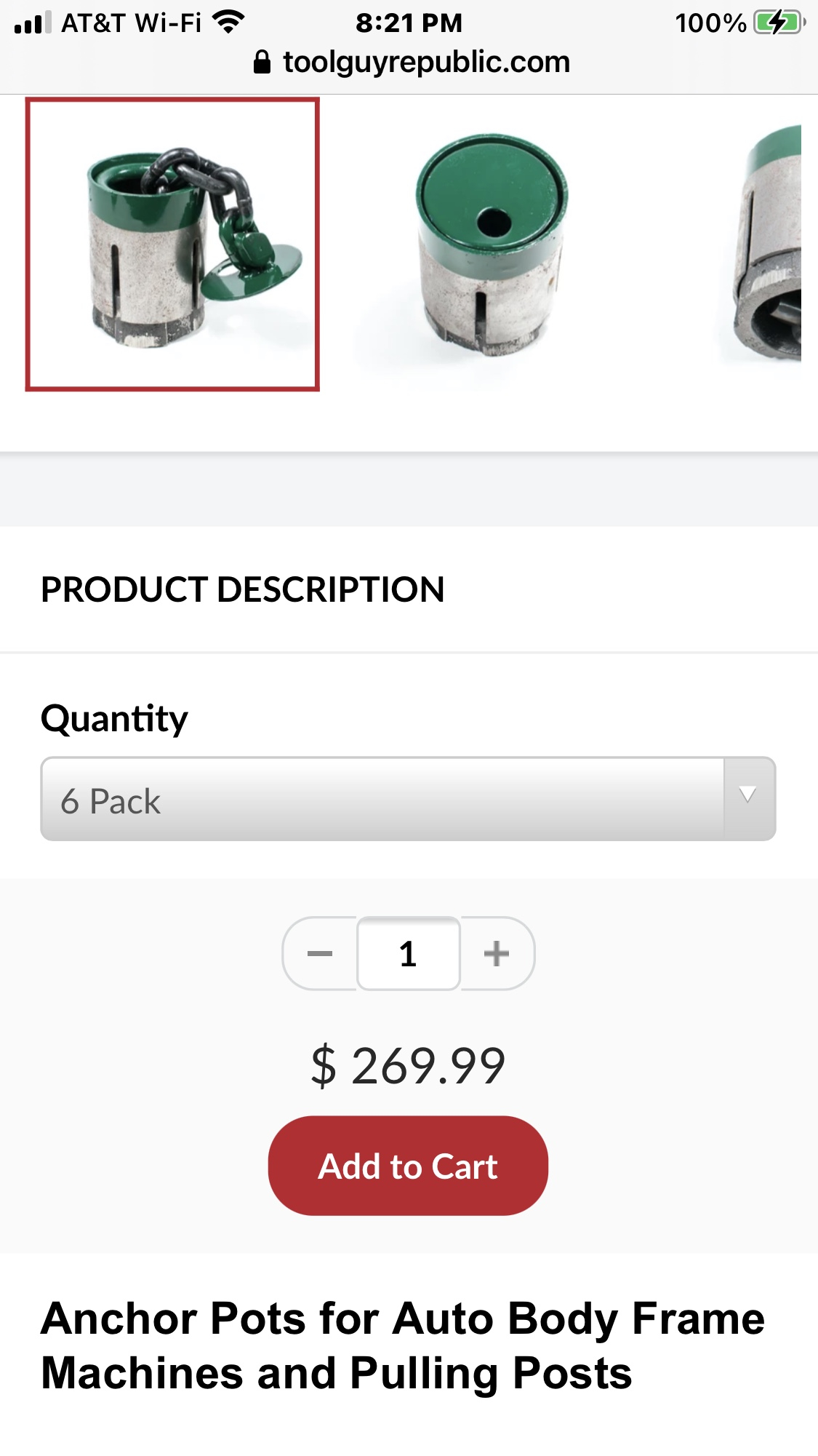

   / Floor anchors
Thanks for the reply,I did find these and I’m still doing some research as to how many and how close to put them. I only have a small space so I’m thinking about 6 should be plenty.
BTW I did find these
   / Floor anchors #4
If you need an anchor between those you install, you could use a strong beam between two anchors, then anchor to the beam.
Bruce
