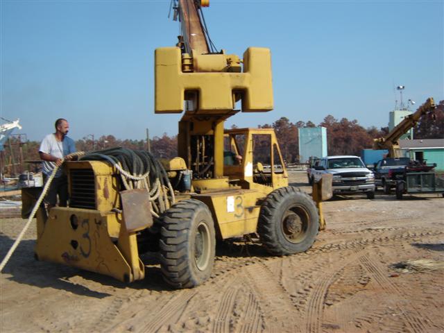

Sorry to hear about your loss. We had two of our cherry pickers go under in Bayou La Batre during Katrina. We drained all the fluids, cleared the fuel lines, greased everything, and made sure no water sitting in cylinders. They started up fine. It was just a week after the storm hit though. Those machines are pretty tough. I do not know what affect sitting this long will have on your tractor.
I have attached a picture of one of them after the storm. We were using them to clean up the ship yard. Water over the cab frame.
