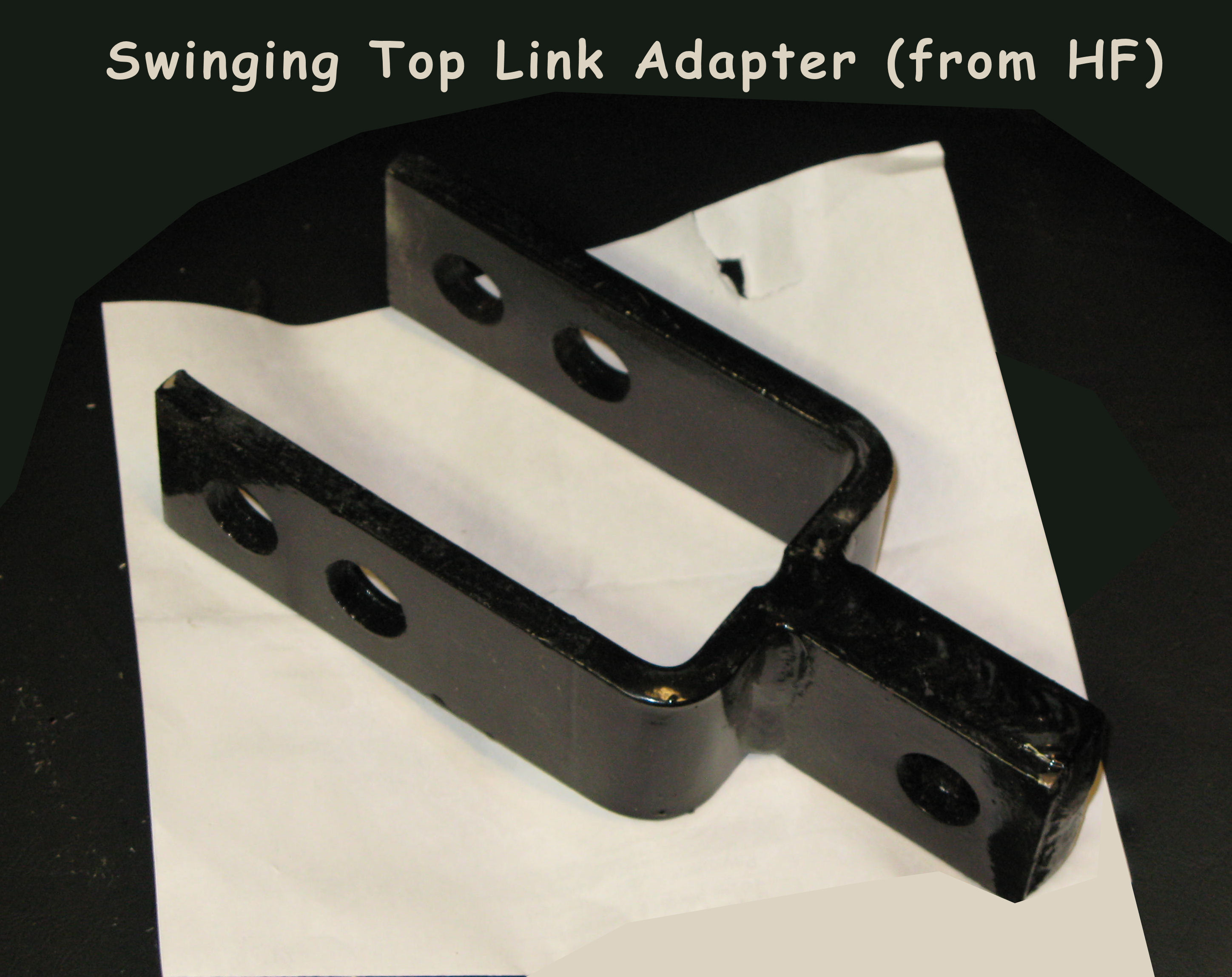

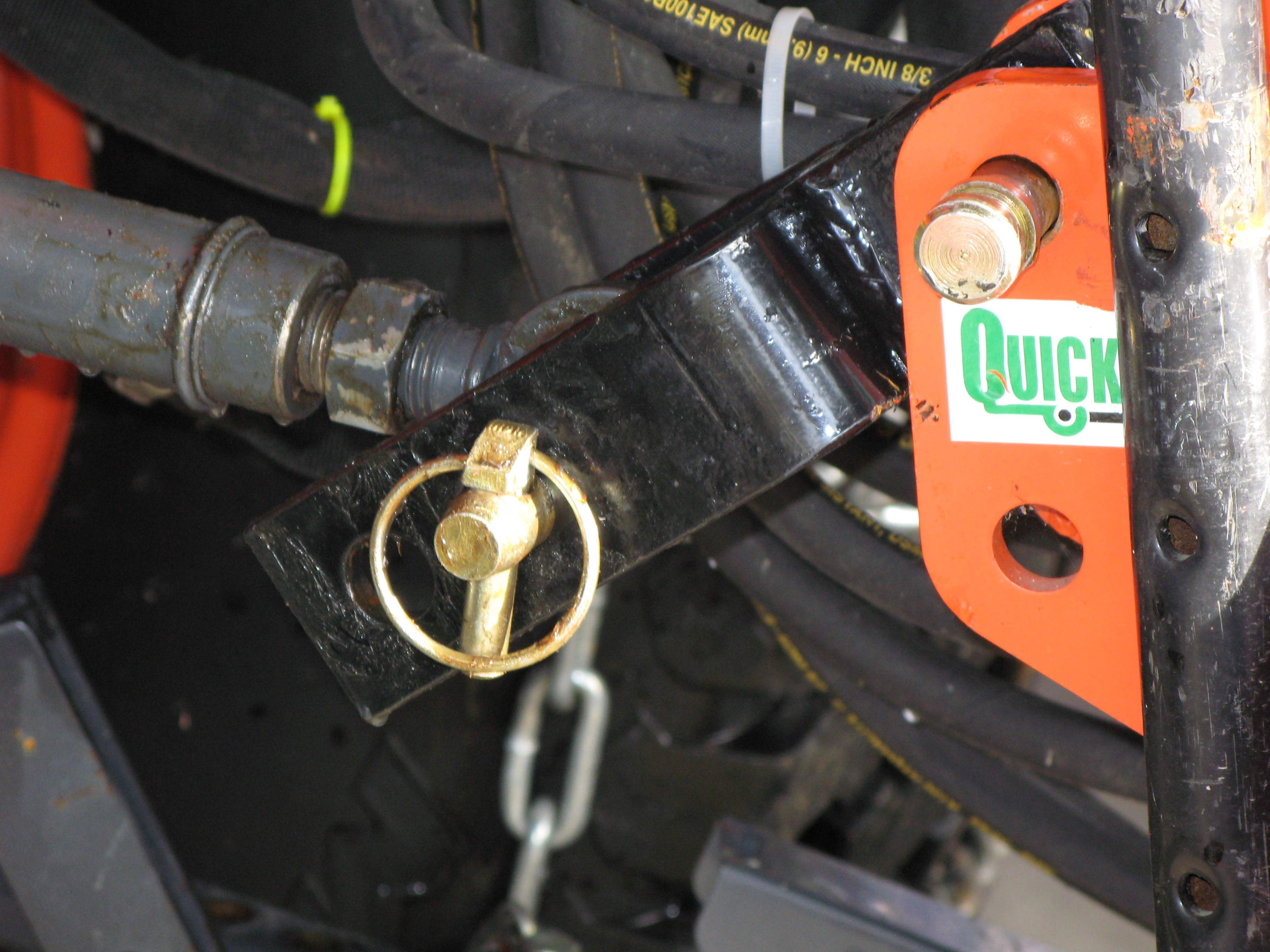

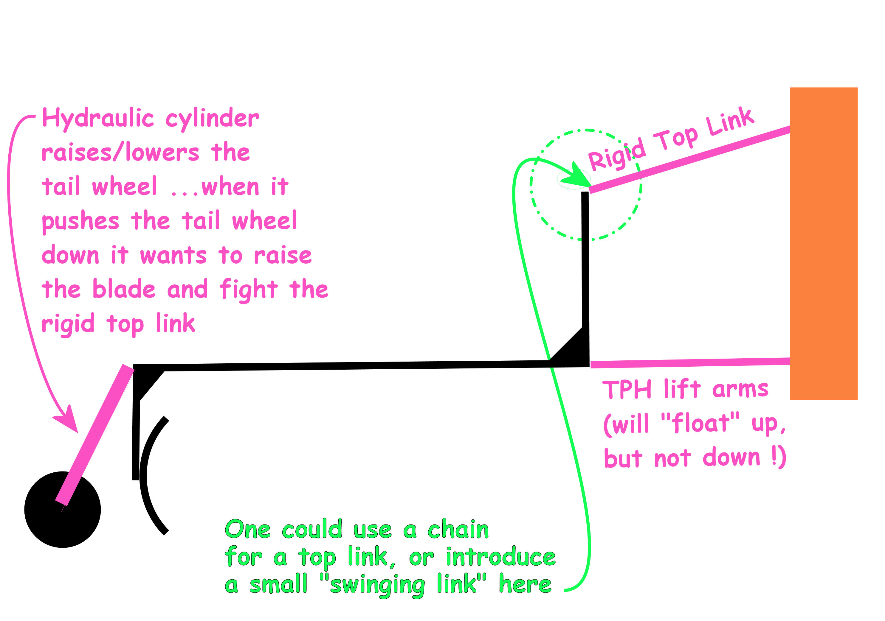

I've posted on this before ..somewhere ...I have a landpride rear blade that has a hydraulically adjustable tail wheel (single gauge wheel) and, as it is manipulated it "fights" the top link ...which I solved by using the floating top link accessory that HF sells for their quick hitch. See explanatory sketch below, and two pics
As bought, both my bush hog (which has a tail wheel) and my finish mower (which also wants to follow the terrain) both have floating top links.
