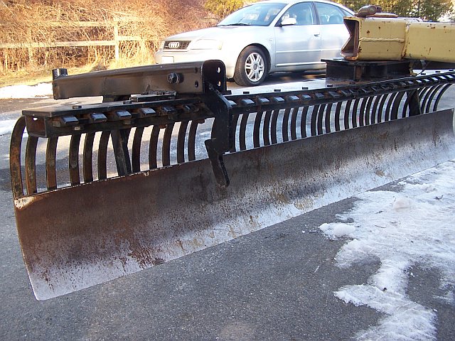

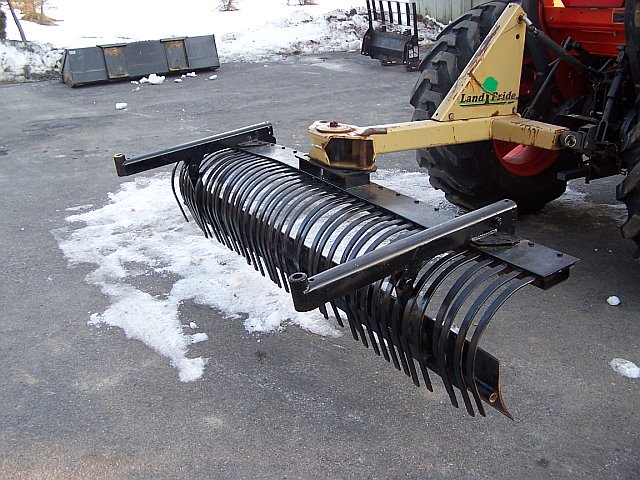

Has anyone purchased a Flip Down Grader Blade for their Land Pride Landscape Rake: LR1560, LR1572, LR1584, LR1596? [Part #302-105A 6' GRADER BLADE ASY]
I am wondering three things:
1-Price (of just the Flip Down Grader Blade add-on)?
2-Ruggedness of the add-on Flip Down Grader Blade?
3-Any pictures?
I have the LRT1560 Rake now and wonder if I could use the Flip Down Grader Blade for scraping the snow/ice off our private gravel road? We have a RBT1584 but my wife wants me to down size some implements before I can get a front blower. :confused2: Now the RBT1584 is my primary snow removal tool but if I get a blower the LR1560 would just be used to scrape the left over ice snow.

I found these on Land Pride with lots of searching:

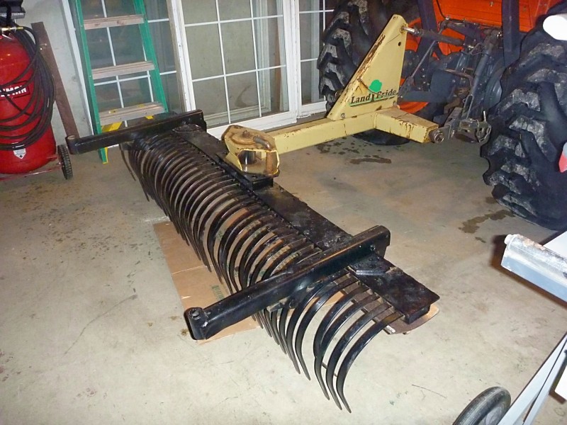

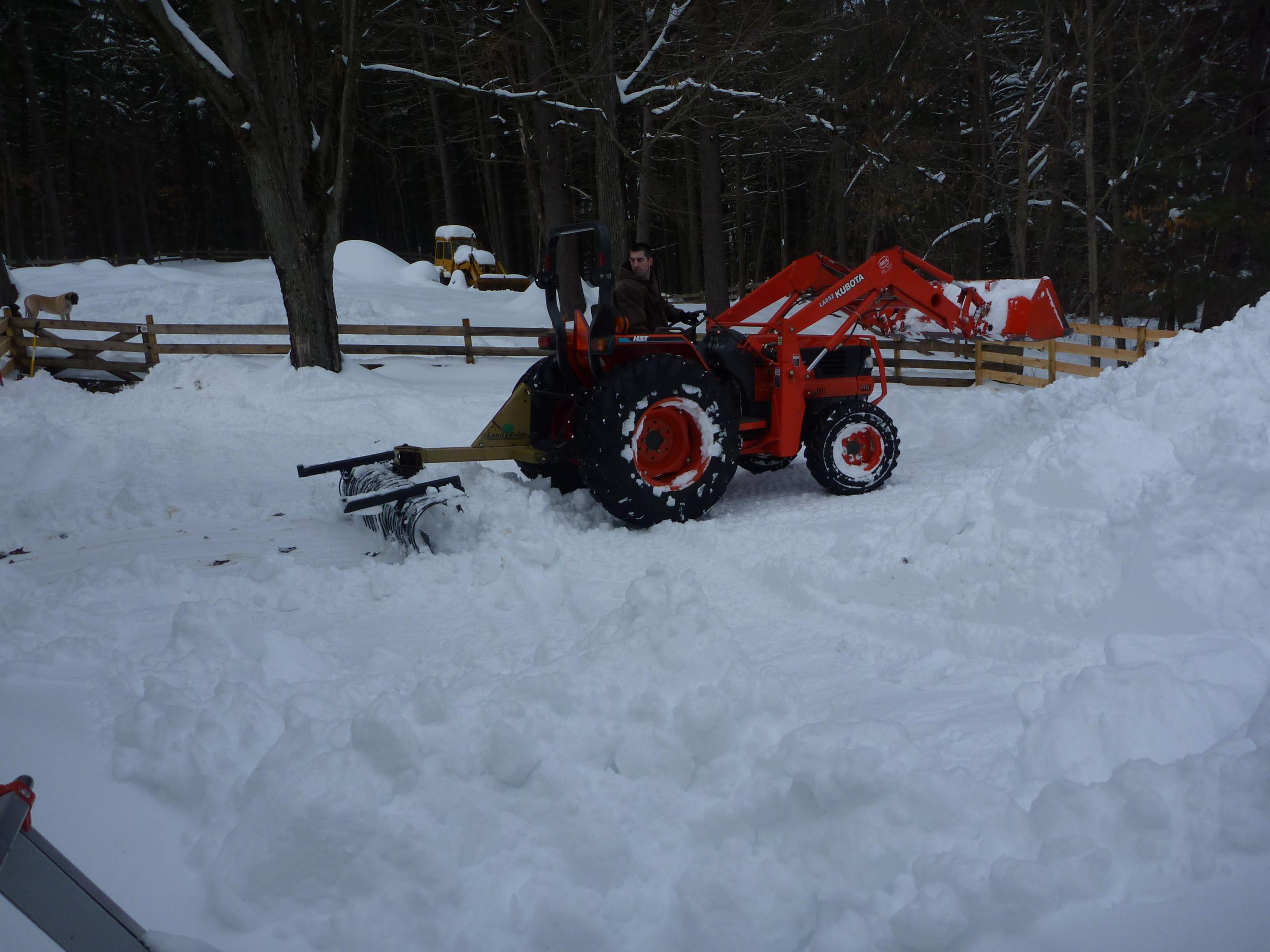

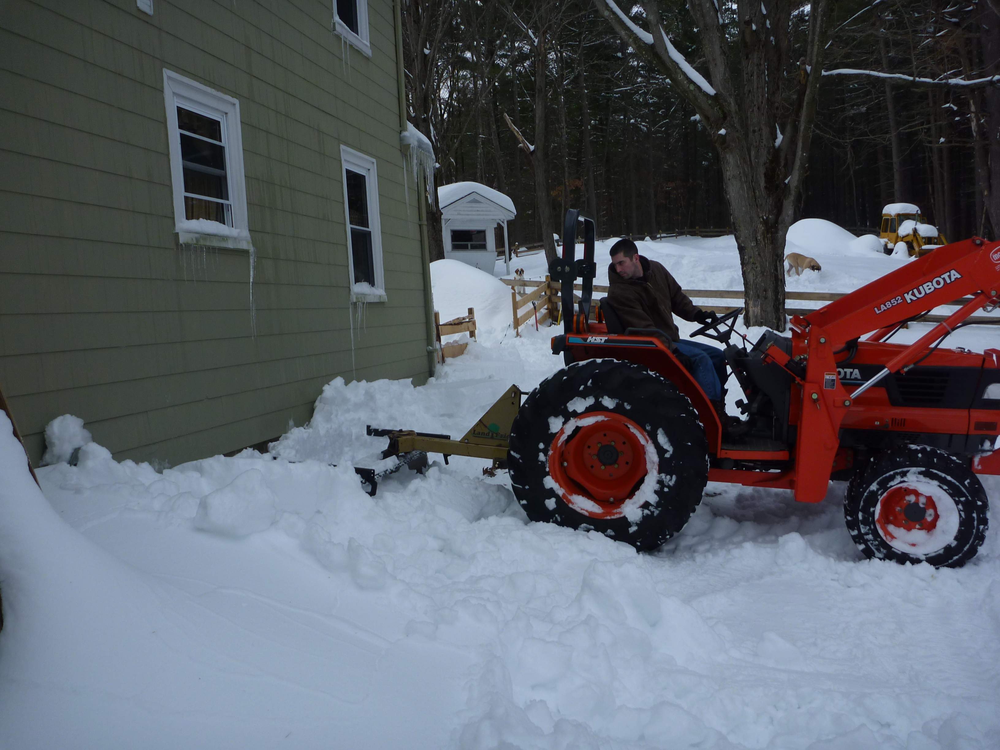

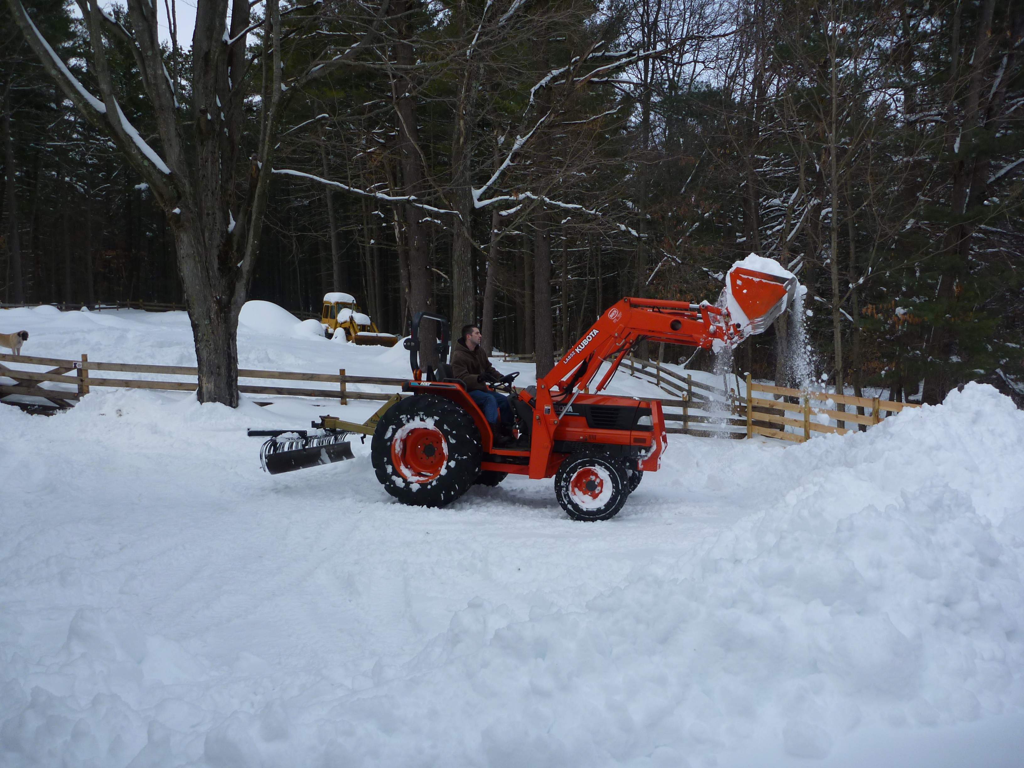

I have one of those Land Pride rakes with the flip down scraper blade, I actually didn't even know they existed until I bought the tractor (it came with it).
I used it quite a bit over the last month or so since we've been getting dumped on with snow, I usually use the FEL but use the blade to back up to my garage and sometimes use both at the same time with a lot of snow.
I don't know what the price would be. It does work well and better than I thought, however one thing that happens makes me want to get a dedicated scraper blade.
In the pics you posted you can't tell, but with my landscape rakes the tines aren't all so perfect. Many of them are bent back/forward from use in rocky soil, since the ones that are bent forward hold the blade out away from the rest of the tines, it gets 'springy' when pulling snow, in other words the snow piles up in front of it and with the blade pulling the snow, it bounces forward and back on the forword bent tines. Not sure if that makes any sense.
I did bend some of the tines back using heat and that helped a lot.
It's nice to be able to just flip it up/down though and not have to go get another attachment when you want either the rake or blade. I wish there was a pin to keep it fixed in the down position but I don't see one anywhere? I may try to rig one up somehow. WHen the snow gets icy I will flip up the bar and go over it with just the rake, putting some grooves into the icy snow, which helps A LOT with traction for my wifes front wheel drive car, before putting the grooves in the driveway she would spin the tires in one small hilly spot. I'll look to see if I have any pics of it.

I found a few pics. You can see how when it's folded up its out of the way, and in one of the pics you can see what I mean with the bent tines. the one that is bent forward holds the blade out and causes some 'bounce' back and forth, however I honestly haven't found it bad enough to justify buying a dedicated blade, its just an excuse for another attachment :laughing:
Hope these pics help.
