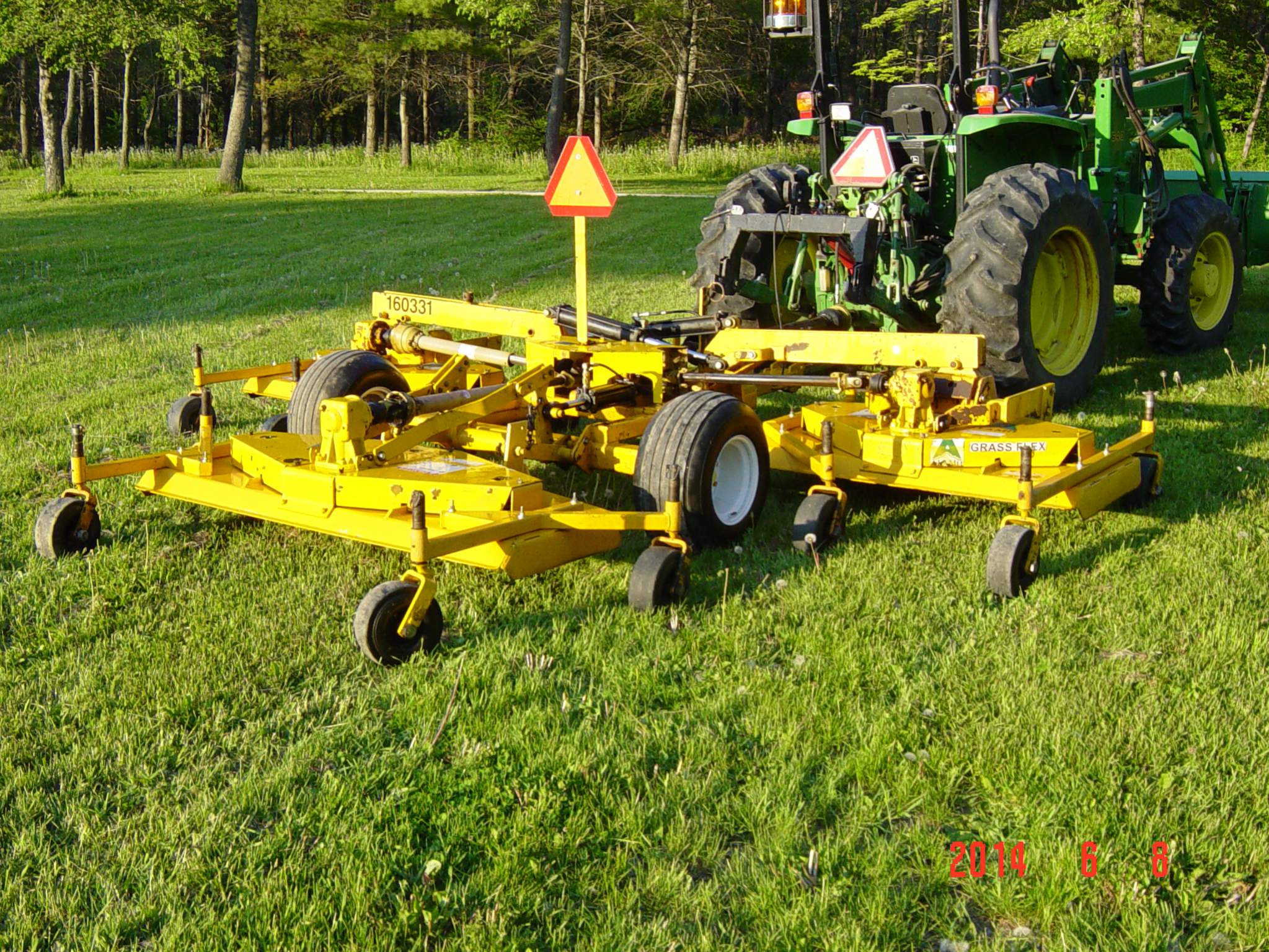

I am thinking about getting a flex wing finish mower. I have 7 flat, clear acres to mow, and do not want to spend all day mowing it. I do not currently have a finish mower. I look at new zero turn mowers, but they are equally as expensive for a large cut. Any disadvantages of getting a used flex wing mower? Are they worth it for my small acreage, and if you would get one, would you pull it with a small CUT such as mine in my signature. I know my PTO HP rating is not very high, but was thinking a could get away with it if they grass was not to high and/or I go slow. Opinions welcomed.

I think you are no less then 15 HP short.
Edit: that would be to run any flex wing finish mower I am familiar with. a 6' RFM should be no problem.

You could probably mow 7 flat, clear acres with a 72" ZTR in less than 1.5 - 2 hours depending on how bumpy the ground is. Sounds like a better idea than buying a finish mower that will stress your tractor if it will handle it at all.
I'd suggest looking for a gently used commercial grade ZTR with low hours.

You have plenty of HP to run a 6' RFM. I do 3-1/2 acres of grass with some hills, trees, sheds and a creek in 1-1/4 hours with a Landpride rear discharge 6 footer. You should be able to handle the 7 acres in about 2-1/2 hours.

I have a 35 hp tractor that easily cuts grass with a 7 ft finish mower. If I kept up with it and did it at least once a month, I wouldn't hesitate to go even bigger. The biggest issue that I have with my mower is how heavy it is. I can pick it up with the 3 pt arms, but the front end gets real light and I feel that I'm straining the lift arms.
I also have a Scag 60 inch zero turn mower. Between the two, I will ALWAYS chose the tractor and finish mower for mowing big open areas. It's more comfortable and relaxing. I don't know which is faster because I just use the zero turn for those hard to get to areas and those places where I want the perfect finish. The zero turn will only cut grass that is already short. The finish mower is fine when the grass is four to six inches tall.

I have a 15' Rhino flex wing finish mower. I use a Deere 3720 to pull it. It is 44 HP at engine, with not much power to spare. I think earlier post is correct, you may not have enough HP. A 7ft mower might be the better choice with your tractor and acreage. You mention an 11' mower. That might work, but I would try it with your tractor first if possible.
