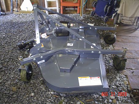

Woods.jpgI have one that is a 72" Woods Hertage RFM. It has an anti scalping roller up front and does flex up and down to follow the slopes of or your lawn. Not sure of the degrees but it flexes about 2 to3 inches each way, works real good.

The picture I posted doesn't show what I call flex, sorry I'll try and take photo latter. Yes I to believe you need wheels all the way around or front of cutter will contact ground.Maybe the correct word is not flex but free movement up and down, if you follow in the picture where the top link goes all the way down to the cutter. There is plates on each side that allows the cutter to follow the layout of the ground without allowing the wheels to loose contact with the ground, is that flex?

That is what I'd call front to back flex (or float would be what I think would be more definitive in my little mind). The flex built into the KK is what I would call allowing it to "twist" relative to the tractor rears.
But I think I'd also want the those wheels at least in front, if the deck was allowed to twist.
There was a pic recently of wheels on the front corners of a rotary cutter. They were the size of wheelbarrow tires (or similar) and I wondered if the blades would throw enough debris at them that they wouldn't last long. Might need the hard solid rubber wheels or rollers.

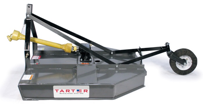

Our Tarter cutters have had the flex hitch for as long as I can remember. Ken Sweet
