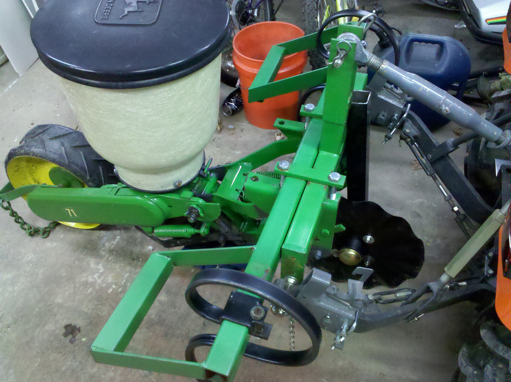

Well....I decided to get off my butt and add a 16" 13 wave Yetter No-Till coulter to my 1-row Flex 71 planter. Just have to finish the mounting brackets at the toolbar and it should be ready to roll in the spring.
Last month, I chisel plowed and both gardens and then disced them smooth. Then I broadcast white winter wheat seed and disced again. In the spring I will spray with Glyphosate (Round-up) to kill of the wheat and then no-till my sweat corn, peas and green beans with the planter.
Next I will build a spiked closing wheel assembly to bolt in place of the rear drag chain.

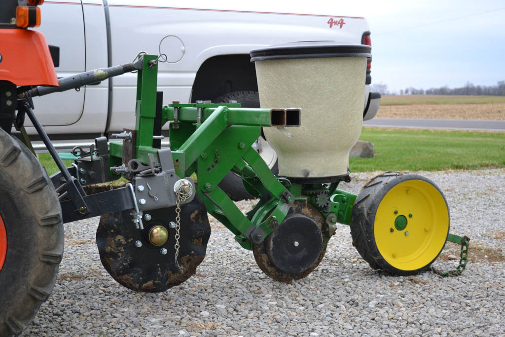

Well....took the planter out into the recently harvested corn field and tested with the no-till coulter. Works great! Added 80 lbs of weight to the toolbar and the coulter is cutting about 4 inches deep, so I have plenty of adjustment as far of depth.
Seed openers are making a nice seed trench too. All I need now is the proper closing wheel for the planter. Needs to have a ridge in the middle of the wheel to firm up the seed trench.

As for how well the Flex71 planter works in a no-till capacity, I will say that I like it so far. I have used it like this for 9 years now and no problems yet. I did recently switch to roundup ready Seminis Performance series sweet corn, so now I can no-till plant my sweet corn, and burn down the weeds with roundup within a few days of planting. I still try to work up the gardens whenever mother nature allows me to, but if we get a wet, busy year where I am not able to work the ground.......I no-till it!
