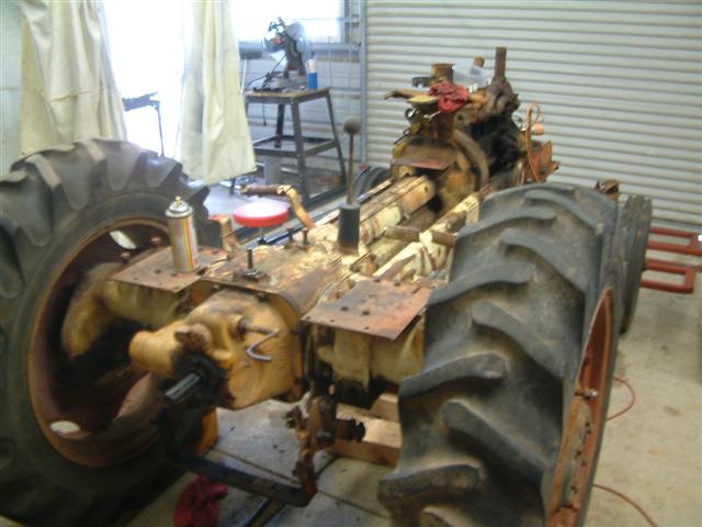

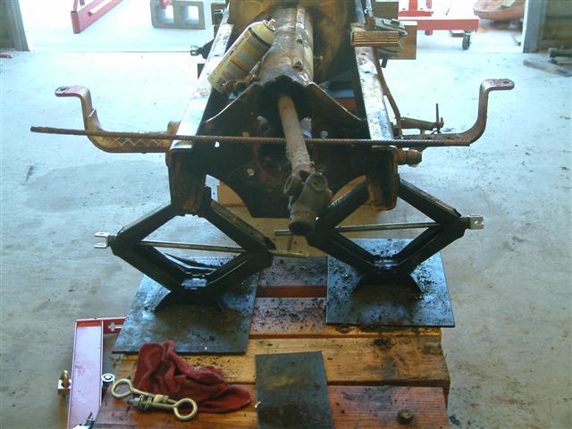

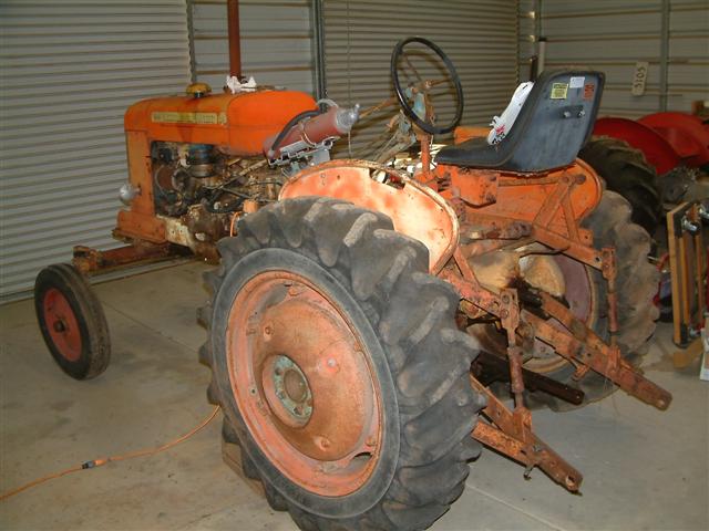

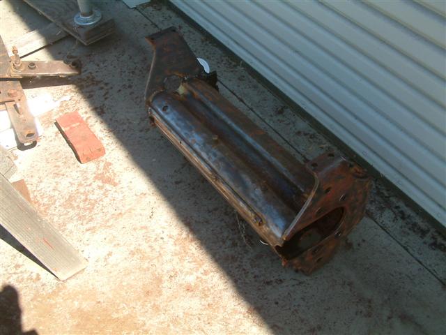

Don't know about torque tubeson GNs, but the 1951 Minneapolis Moline BF tractor that I'm presently restoring has a torque tube setup between the clutch housing and the transmission case.
This tractor is laid out engine-clutch-drive shaft-tranny-rear end. The drive shaft goes through the torque tube.
The torque tube is a stiffener that keeps the two main support rails (C-channel) of the tractor from twisting due to engine torque. I suspect that the torque tube(s) on that GN you're looking at have a similar function (preventing the frame from twisting).
