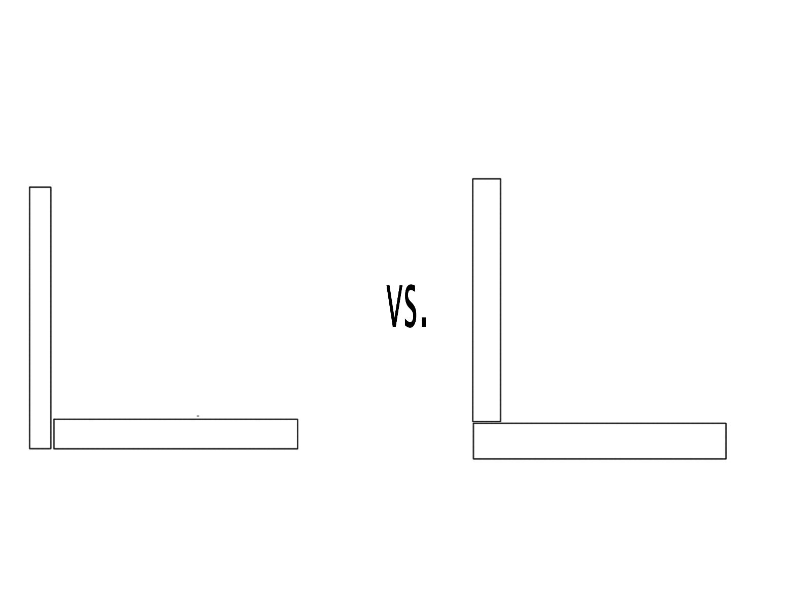

If you took a 2 pieces and made a 90 deg. joint that looked like a piece of angle iron and laid one piece flat on the table with the other side pointed vertically like an "L" would be a horizontal position weld. If the angle pieces were positioned like a "V" pointing up would be flat position. In a groove or butt weld, flat would be like the plates lying flat on the table and horizontal would be like they were mounted on the wall so you could weld left to right. Up and down would be vertical welding. Often times you have a combination of different positions.
   / Flat vs Horizontal #7

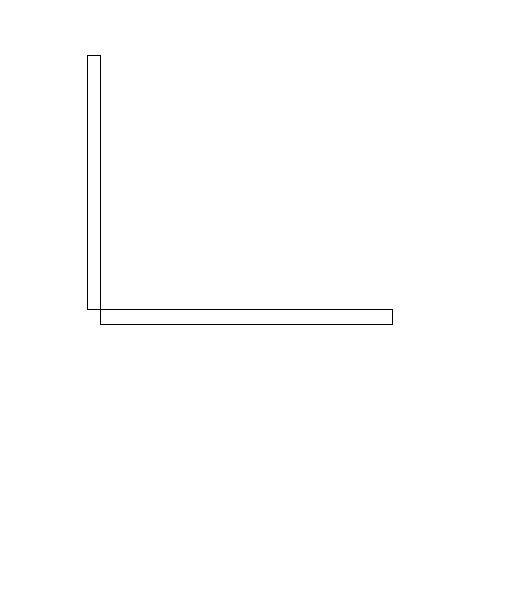

I'm interested in technique on fillet welds (Mig). Is there any difference between the two configurations? Approach, whipping pattern?

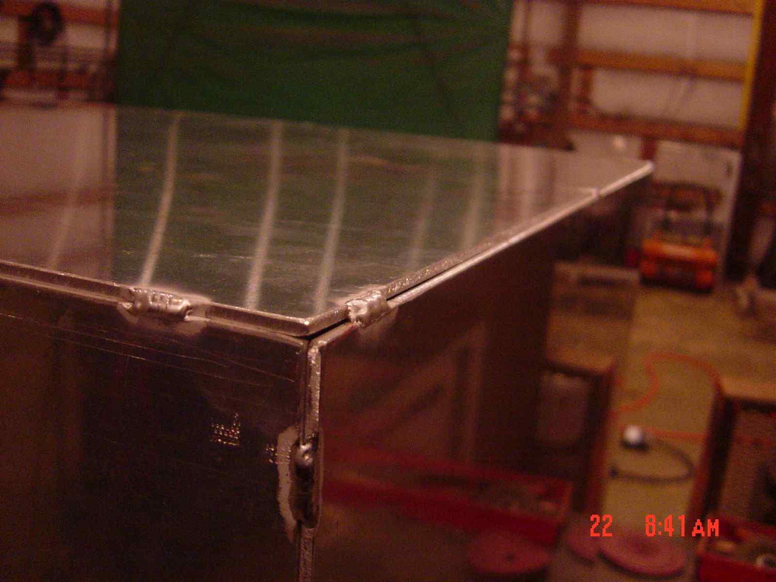

A third option is this which I like to do
That is the best and strongest way to do corner joints. You can make a perfect size fillet weld on the outside corner and don't need to weld the inside. Very common technique when building tanks where you can't get to the inside.
