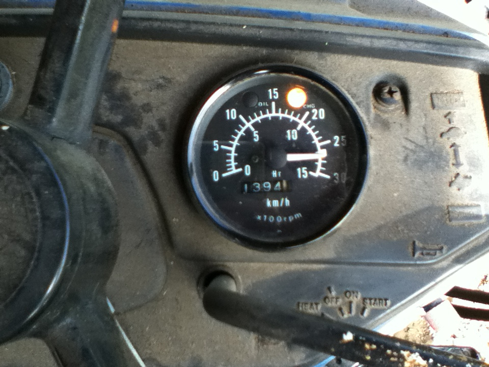

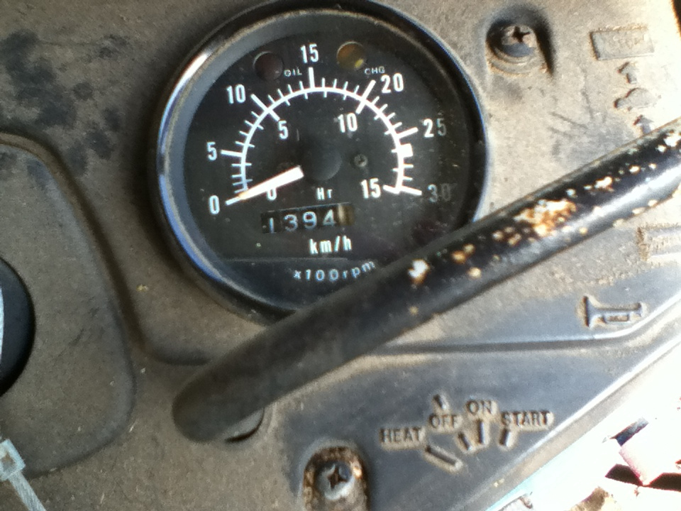

Ok, I charged the battery and it starts no problem. I've attached some pictures.
This first one is the console of my tractor. The labels for the key are heat, off, on, start...which is why I turn it to start and once its started I turn it back a bit to on.
Now, this picture is what it looks like if I start it and don't turn it back a bit. You can see the orange light comes on for the chg label.
I did run it with the light on for about an hour and at no point did it turn itself off.
I have no problem with irregularly charging the battery manually once a year, but if this issue might be from a different more problematic thing, then I'll need to track it down. Tomorrow I'll get the multimeter out and see what the numbers say.
Pete

How old is the tractor? I'm wondering if the key switch is shot and is allowing the engine to run (fuel solenoid not shutting off fuel), but isn't allowing the alternator to charge.
   / Flat battery #10
Does the tractor shutdown with the key or does it have a manual shutdown, like a lever or pull knob?
My B7200 is mechanical shutdown only and if you turn the key off it shuts off the charging circuit.
It looks like it's time to get out the volt meter and do some diagnostics.
