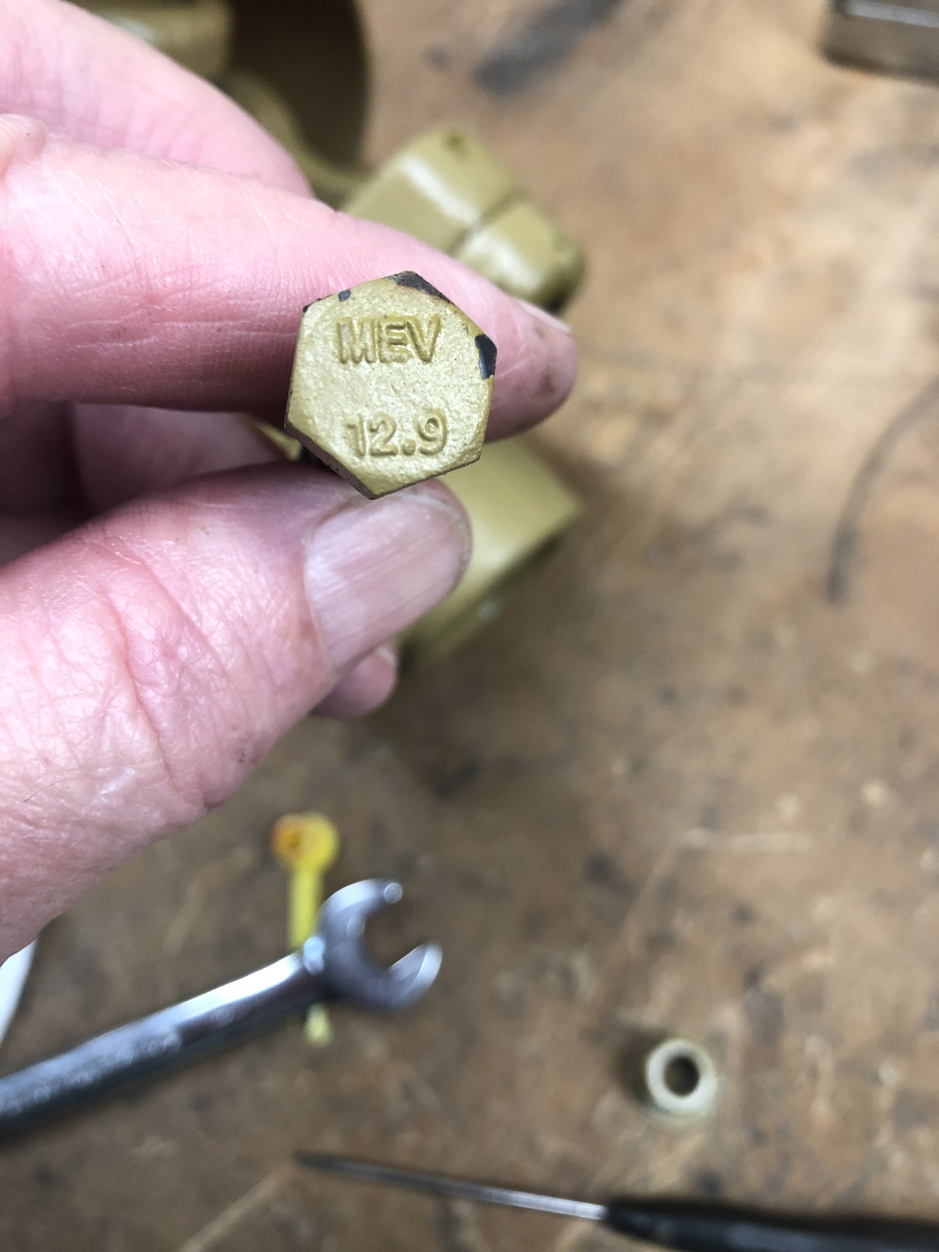

As the title says… I found a 12.9 shear bolt on my brand spanking new flail mower PTO shaft… it’s roughly 5/16” X 2” …
I know, 12.9 is a metric rating but SAE bolts are easier to find and quite a bit less spendy… hence the std. measurement…regardless…
i pulled the bolt and underneath all that glorious goat-vomit yellow paint is a black (tempered?) bolt…
What’s a good SAE match for that 12.9?
I was thinking about starting with a grade 2… then moving up to grade 5 if the bolt shears too readily… good plan?

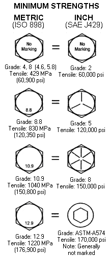

If the bolt is black in color it is a 12.9 metric/grade 8 bolt or higher.
You need a grade 8 bolt and nut equivalent for this PTO Shaft if you
do not want to invest in 12.9.

No idea how a 12.9 grade bolt ended up there but it's not correct at all unless it will be powered by tractor with a lot of HP. Should be a grade 4.8 or 5.8 at max.

The other thing to consider is that if you use a very hard bolt, let alone it maybe not shearing as soon as it should, if/when it does shear, it may do local damage to the holes in the coupling, which will be much more expensive to replace than some shear bolts. Use low strength bolts first, and only move to stronger as you find necessary.
   / Flail mower shear bolt — 12.9? #10
I have a couple implements that use this. I always start with a Grade 2 then work my way up until I'm satisfied.
Also goes without saying, most people forget... you should remove that shear bolt and make sure both the coupling and shaft actually move and not rusted together.
